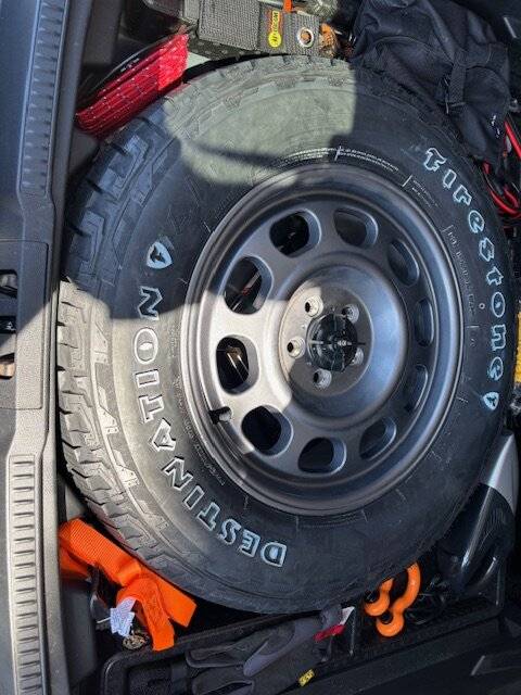

Put new shoes on my Sport. Went w/Firestone Destination AT2’s 235/70R17 all around w/245/65R17 on “steelie” for spare.
Much more quiet than my really worn Falken Wildpeaks. AT tires get really noisy when worn out!

Why the different size for spare?
235/70 won’t fit in spare area (30” tire), biggest I can wedge in there is 245/65 (29.5” tire). This keeps spare as close as possible in height in case I need to try and run with drive train locked up.

that makes sence now that i work it through in my mind, just seemed strange at first that the 235 has a taller sidewall by .5"
