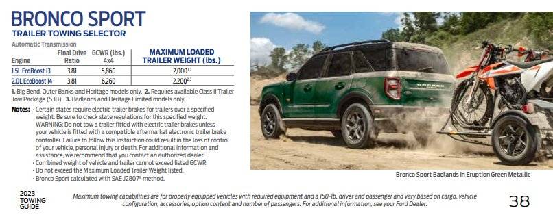

I noticed a typo -- the chart should read: "Maximum Gross Combined Weight Rating."
It also leaves out that Package 53B (note 2) is required for towing and you should refer to the Ford towing guide.
Nothing has changed from 2021 to 2023.

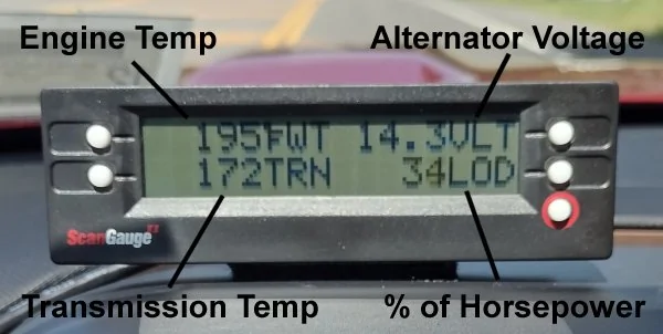

As for transmission temperature, I recommend purchasing a Scangauge. It plugs into your OBDll port and can be set up to monitor coolant temp, ATF temp, and many others. Lets you know what is going on with your vehicle.
Been using a Scan Gauge II on the Sport since the beginning.
Ford Bronco Sport Towing capacity for Base model without factory install towing package? scangaug
There's a ScanGauge III out now that programs itself but it's a lot larger. The II gives me everything I need for towing with the Sport.
That's what we use in our RV with a 2008 Sprinter chassis. I selected the same exact info to be displayed. For those that aren't familiar there are several options and you can select up to 4 to be displayed. It is also a basic trouble code reader.
In our case, it would not show "TRN" (ATF temp) out of the box. That was due to MB not being willing to share (unlike most mfrs). Someone smarter than me on Sprinter-Source figured out the required codes to be entered manually and it works. I gather that with the older Sprinters (thru 2006) the ScanGauge II will not display ATF temp, and there is no hack to get it to work.
Anyway, the Sprinter is probably a fairly unique case. I'm glad to see it works well with the BS.
There are other similar devices. I've seen them advertised but have not looked into them. Some have "gauges" on their display, which can be helpful.
