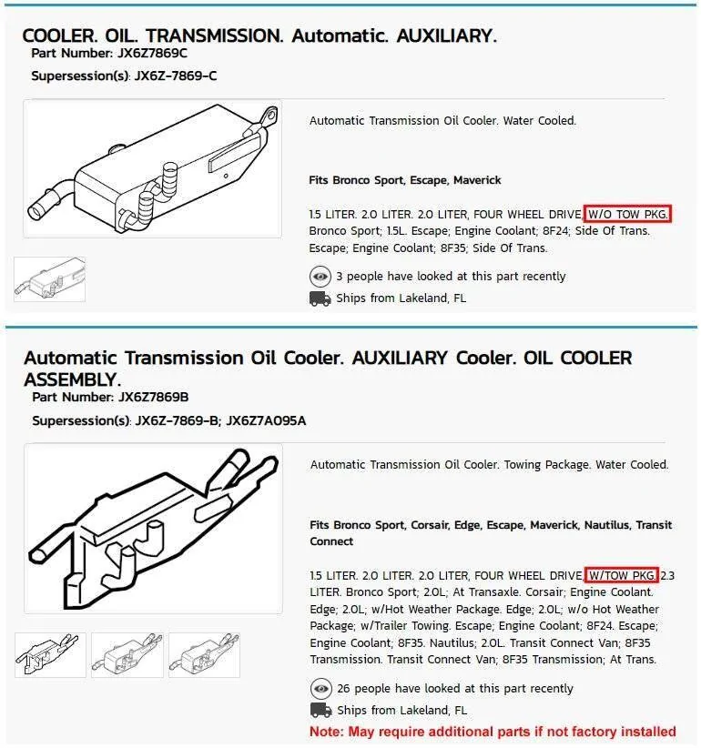

I admit to not being 100% clear on this myself. Out of curiosity, I just re-read some posts, poked around on Google, and looked at some Ford docs.
Everything I found said there was no ATF cooler included with the factory tow package (or did not mention one). This is from that post #33 I linked to above:
Ford Bronco Sport Towing capacity for Base model without factory install towing package? 1737866457972-gd
Contrary to what I've read, it's possible that the above parts listing indicates that an ATF cooler *is* part of the factory tow package.
However, I noticed that both coolers are described as "AUXILIARY" (in upper case) as if they are a dealer add-on.
I've seen plenty of lists of what is included in the BS factory tow package, and none mentioned an ATF cooler.

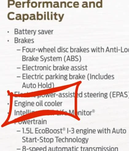

This is taken from the :
2021 Ford Bronco Sport Packaging Guide - Dealer 6452
Showing "oil engine cooler" under the Base model specs (note the website is clunky)
https://manuals.plus/m/d3be50d615d690ec4189e4d291af5c3a3307db12dff00f2855337de5c344af76
Ford Bronco Sport Towing capacity for Base model without factory install towing package? IMG_3609
I'm not sure if that's correct, but I'm certainly not the ultimate authority on the Bronco Sport -- or anything else for that matter. :cool:
I see what you mean about the webpage -- very strange. That said, the brochure page copied at the top says, "2021 Ford Bronco Sport Packaging Guide."
Hmm...
When I searched with Google, all that came up was dealers selling a Ford aux./add-on engine oil cooler.

One example (Google AI):
Yes, the Ford Bronco Sport has an engine oil cooler from the factory on some models. The oil cooler is available on the 8-speed automatic SelectShift® transmission."
Using "ATF (auto trans fluid) cooler" would make it clear.
That's a pretty comprehensive 'tech spec' sheet. "Cooler" is only mentioned that one time. Of course that does not mean there is no engine oil cooler, but it seems like it would be included.
Of course in my previous posts I was referring to ATF coolers. That's typically the primary concern when towing -- but if the BS does have a factory engine oil cooler that helps.
Also, your intended use sounds pretty moderate. I don't want to tell you that an ATF cooler is not necessary and then your transmission melts down, but 'my friend' thinks you'll be OK. :cool:

Way back when I bought my '21 Sport OB no one could tell me if the trans coolers were the same in both the non tow package and the tow package. With the help of the local parts guy and the rep we found that by looking at VIN numbers the tow package had a different trans cooler than the standard build even though nothing was listed in the advertising. Those posts above showing the two trans coolers were mine from when we finally figured it out.
