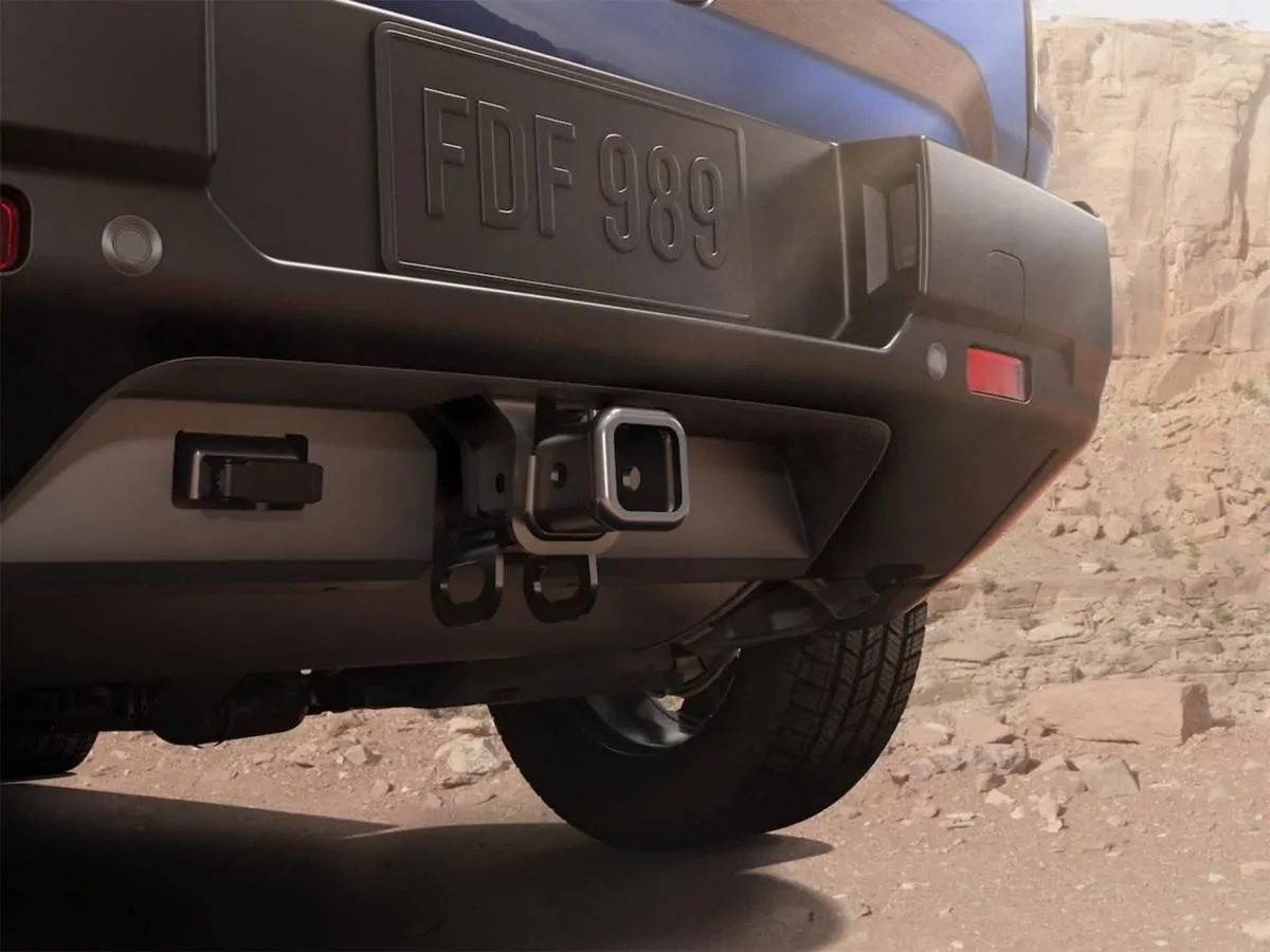

Ford Bronco Sport Factory Bumper With OEM Trailer Hitch Cuts m1pz-19d520-a
Looks nice yeah? Mine didn't come with a trailer hitch so I need to order one. But I noticed an issue...

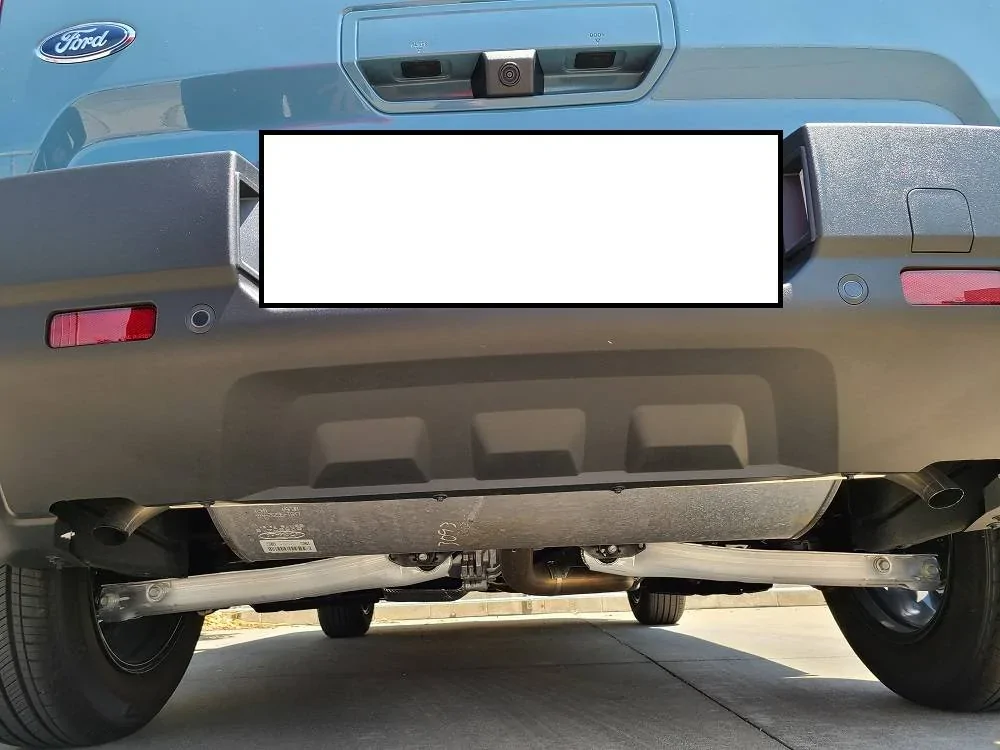

Ford Bronco Sport Factory Bumper With OEM Trailer Hitch Cuts 20210804_135300
Yeah that doesn't match up. Factory has a separate bumper for trailer hitches and it isn't part of the accessories. I've seen some less than desirable cuts made to make the hitch fit with out the factory hitch bumper. So I went digging.

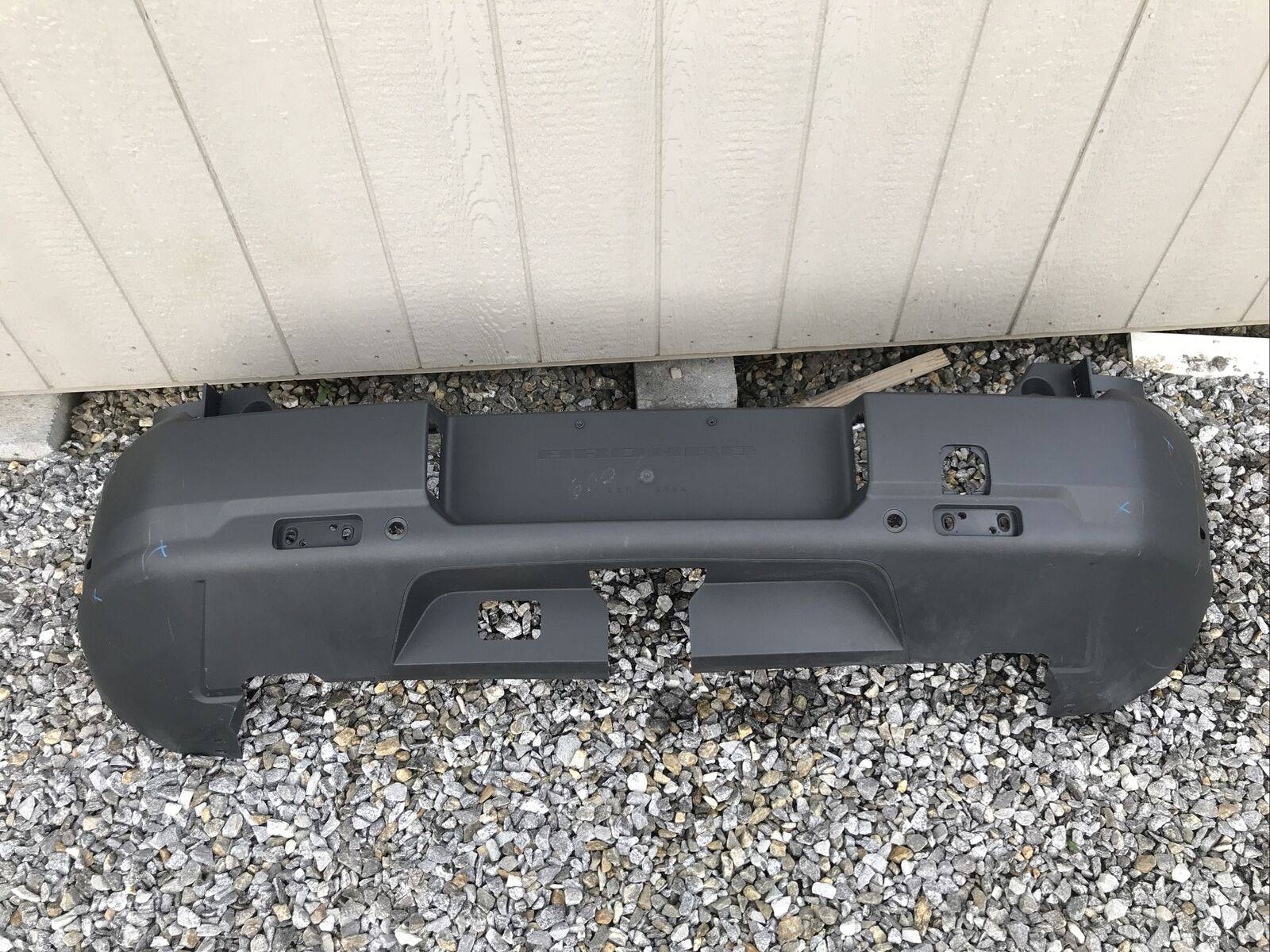

Ford Bronco Sport Factory Bumper With OEM Trailer Hitch Cuts s-l1600
This one is up on ebay right now for $300 + $200 shipping. I hit up my local collision center to see which part number will fit my Bronco. They said swapping the existing sensors and everything else shouldn't be an issue. I'll update once I have their price.
There's 5 variations of the part number:
M1PZ-17906-SA
M1PZ-17906-SB
M1PZ-17906-SC <-This is the one we narrowed down that has the cuts for the hitch
M1PZ-17906-SD
M1PZ-17906-SE
I hope this might help anyone else who's looking to spend a little more for a factory look.

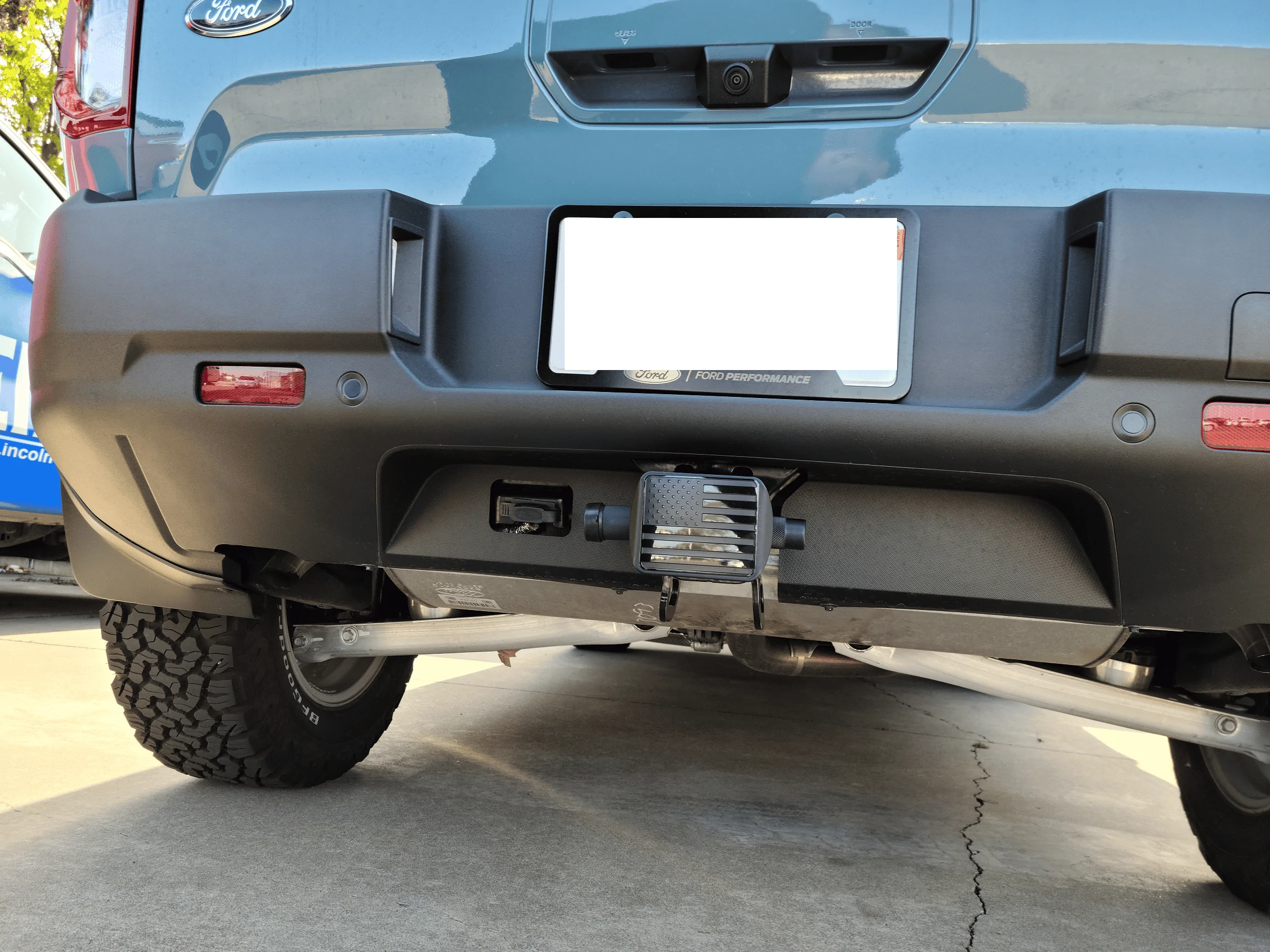

***Update
Ford Bronco Sport Factory Bumper With OEM Trailer Hitch Cuts 20220427_082304
Ford Bronco Sport Factory Bumper With OEM Trailer Hitch Cuts 20220427_082718
It all worked out! Ordered the bumper M1PZ-17906-SC along with the hitch kit and wiring harness and had my dealer install it.

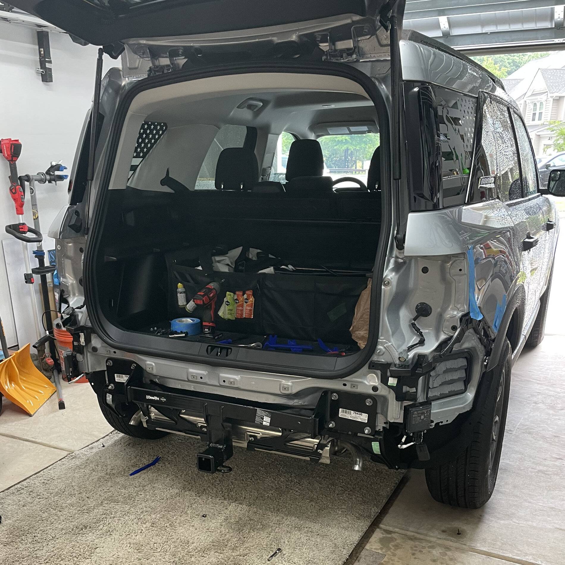

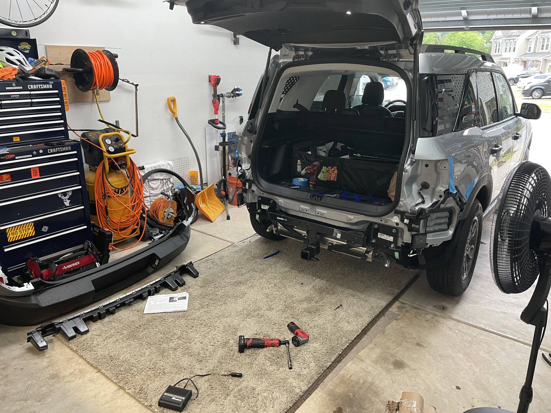

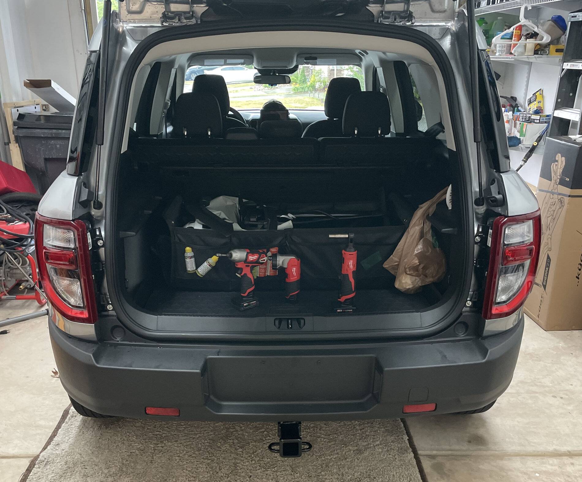

I bought mine from E-Trailer
https://www.etrailer.com/Trailer-Hitch/Ford/Bronco+Sport/2021/DT93MR.html?ehicleID=20216004106
I did the install myself in about 2 hours. There is one small 4" x 5" cut to the very lower aspect of the bumper valence well below the normal sight line. You would have to lay down and slide under the vehicle to see the cut. Once installed I measured the distance from the receiver to the ground, then went to the dealership and measured one on a Big Bend they had on the lot. 3/4 of an inch higher than mine, so height is about the same as factory,
I will say as evidenced by the pictures here, if your not somewhat mechanically inclined, I wouldn't recommend this for you as you will have to remove several parts and pieces from your Bronco.

So you lose almost an inch of ground clearance on the rear when you do it that way? That takes a BB or OB down to about 7“ clearance which is not a lot. A Honda Civic has 6.8”. Also I assume it has a high impact on angle of departure.

Nice install, we have the same Kuat bike rack.
