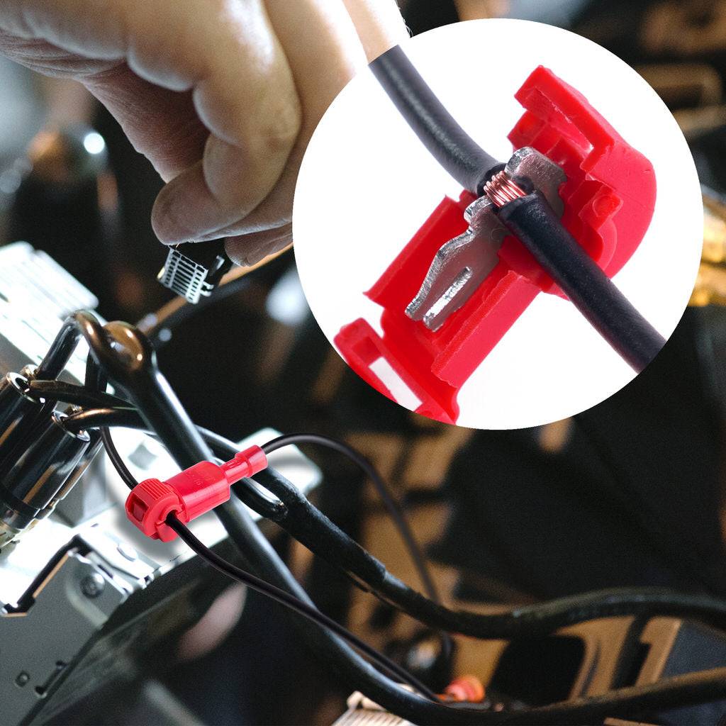

I would recommend using a step-down butt splice over these devices. You said you want to avoid cutting the factory wiring; my assumption is you wish to avoid any warranty issues. I don't think these devices meet that objective, mainly because you are arguably doing worse than cutting the wire.
These connectors work by cutting through the insulation to allow the contact in the connector access to the wire conductor (the wire strands inside). Take a look at the photo below from Wirefly's website showing how the connector works.
Ford Bronco Sport Tectico LED fender light side marker install Wirefy-TTAP120_03_1512x
There are many disadvantages to using these. For example, if you don't get the wire positioned precisely the cutter inside the connector may sever or partially sever the conductor. And even if you install them precisely as the manufacturer intends, these connectors do not provide an environmental seal. If you allow air to get to the conductor it will eventually result in oxidization/corrosion.
When correctly installed, a step-down butt connector with integrated waterproof heat shrink is a much more durable long-term connector.

You can't. My point is you can't use T-taps without ALSO cutting the wire. You may avoid cutting the conductor using a T-tap, but you MUST cut the insulation, exposing the conductor to the elements.
You can read more about problems associated with wire-taps here.
I would use a T-tap for a temporary fix in an emergency. But it's not a good long-term solution. As I posted previously (on a different thread), if you only plan to keep your car for a few years you'll probably be fine with a T-tap--you'll just be passing along the eventual problems to the next owner. If you plan to keep your car until the wheels fall off (or you plan to gift/sell it to a friend/family member) stick with waterproof butt connectors, or some other form of connector that seals the conductors from the environment.
