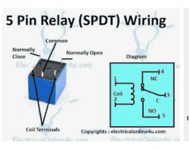

Great idea and a relay is probably the lowest cost solution. Run an ignition switched line and the turn signal line to the relay. Only need to buy the single LED amber color side marker light which saves money over the dual color version. You are a genius.
You do have the added expense of the relay, but maybe now just tap into 1 side only to control both.

This is where I got the idea. Terminal 86 is the turn signal being the switch to activate it if my thinking is correct.
And use a switched ignition line so it’s on when the car is running. When I checked the single amber color DZG side marker light was at least $10 less than the dual color version so offsetting the cost of the relay. Here’s another pic of your idea.

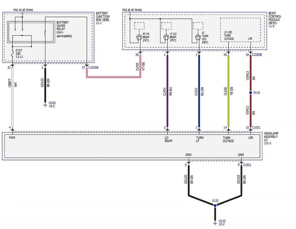

For those that might be interested I wanted to share my journey on trying to get these side marker lights working. For reference I have a 22 Badlands but I think the wiring should be the same in all.
Like others I did not want to “tap” into or cut and splice into the factory harness. So to get around that I contacted Specialty Performance Part over at https://specialtyperformanceparts.com/ and after some back and forth I spoke with John and he sent me a “kit” so I could make my own adapter to go between the factory harness and the headlight assembly. This is what those look like:
Ford Bronco Sport Tectico LED fender light side marker install D37C0EF7-F2C8-4BDD-8A5A-F3F6E97A3694
There are only 6 wires total and they correspond to pins 2,3,4,8,14, and 15 of the connectors. I then cut the wires off the newly made adapters and using the supplied non-insulated crimp style connectors and heat shrink I connected the side marker light to the adapter.
One thing I learned is that the wire colors and their associated function that have been discussed in a couple of these threads are a little confusing.
Obviously the Black wire of the side marker light connects to Ground, I thought about connecting this to a metal part of the car but decided to use the Ground connection on the adapter which is pin 8 and connects to the Black/Green wire on the Drivers Side and the Black/Purple wire on the Passenger Side.
Next I connected the Yellow wire for the Blinker function of the marker light to pin 2 of the adapter which connects to the Blue/Green wire on the Drivers Side and the Yellow/Purple wire on the Passenger Side.
I have the 3 wire version so next was the Red wire for “DRL” and this is where the confusion started. I though about connecting it to the wires shown in a YouTube video but I also saw mention of people connecting it to a different wire on this forum and after searching around the internet thought that I had it all figured out. Well I can tell you for certain that connecting it to the White wire, pin 4 of the adapter, is the WRONG option. Connecting it to that wire caused the white lights to be on constantly even when the car was not running and locked with all other lights off. I’m just guessing here but I think that wire provides power to the “fan” that I think I hear running when the car is off.
The ultimate solution for the Red wire was to connect it to pin 3 of the adapter which connects to the Brown/Blue wire on the Drivers Side and the Blue/Green wire on the Passenger Side. The unfortunate result of this connection is that it is not a true DRL connection but actually Headlight connection itself meaning that the White light is only on when the Headlights are on and not just when the true DRL lights are on.
I only did some preliminary tests tonight as for one it’s dark out and for two I haven’t decided if I’m going to keep the Red wire connected. I really wanted the white light on during the day and could care less about the night time.
It is worth noting that hooked up that way the white light does go off when the blinker comes on but that it a function of the circuitry in the little box more that anything else.
Sorry for the long post and as soon as I have things fully installed I’ll post more pictures. Finally this solution did cost more than the automotive store crimp connectors but if I want to put it back to factory all I have to do is unplug everything.

As far as the PIN numbers I’m looking at it from the male connector on the headlight assembly that has the pins showing, also the plugs are labeled as such. So when looking at that connector the upper left is PIN 1 and the upper right is PIN 8, then of course the lower left is PIN 9 and the lower right is PIN 16.
Looking at the female plug only 6 wires are installed, to be honest I only know the Pin 8 is ground, Pin 2 is for the turn signal, and Pin 3 is the low beam headlight. As far as the remaining pins 4, 14, and 15 go. I can tell you that 4 constantly has power because on my first attempt I connected the red wire from the marker light to it and the white LEDs stayed lit all the time, even when the car was off. it’s possible that it supplies power and/or control to a module in the headlight assembly since the DRL lights don’t have a separate wire and neither to the high beams. Not sure what 14 and 15 do but maybe if 4 is only power for a module then maybe 14 and 15 are control wires to the BCM. Like I said not sure but hopefully some of this helps you.

Winds of Change… various people posted wiring diagrams and headlamp connection diagrams but some of those turned out to be Bronco not Bronco Sport. The attached pic might be for the Bronco Sport but please confirm before using. Looks like the pin out matches what another post stated. Pic states it’s for the left hand side and I don’t have the pic for right hand (passenger) side.
btw several people on this forum have access to the full wiring diagrams for the bronco sport so they might be able to help with correct pics.

Thanks this should help.
