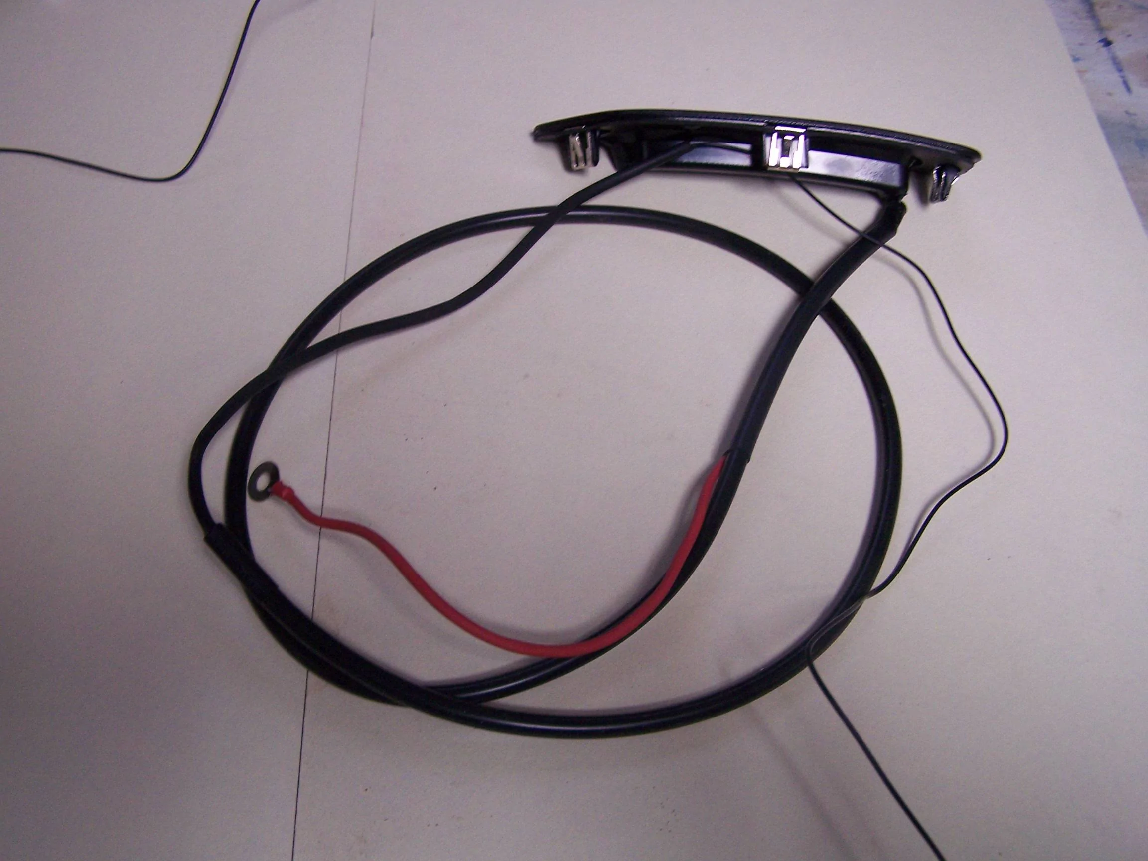

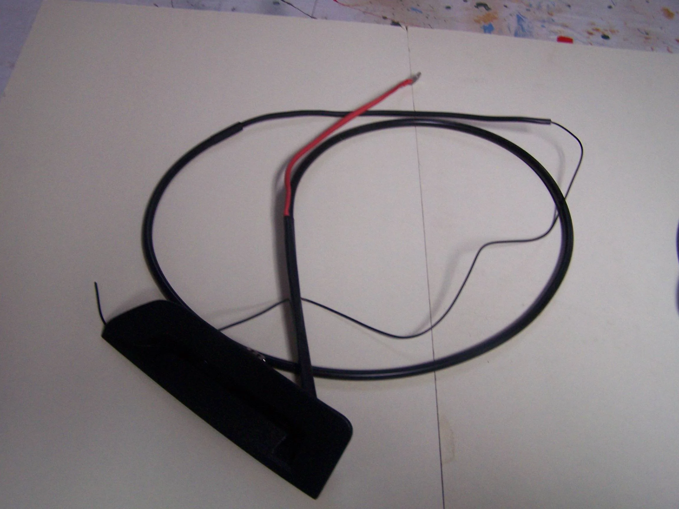

OK I started my install. Let me say I'm not real impressed with this product. I ordered the set with just 2 wires (red & black). I'm only utilizing them as side directionals. The first thing I did was test the lights with a 9 volt battery to make sure they worked. Next thing was to put a little super glue around the base where the wires are attached to the lights. This will ensure that they won't pull out. I discovered that the original wires were only 45" long. I extended them so I could route them out of the way. Next I ran the wires through 1/8" vacuum hose. This will help protect them and the black looks much better. I plan on grounding them on the bottom brackets of my Redline hood struts. Below are 2 pictures of the new wiring harness with tubing and shrink tubing. Over the weekend I'll install them and take pictures of the finished job.

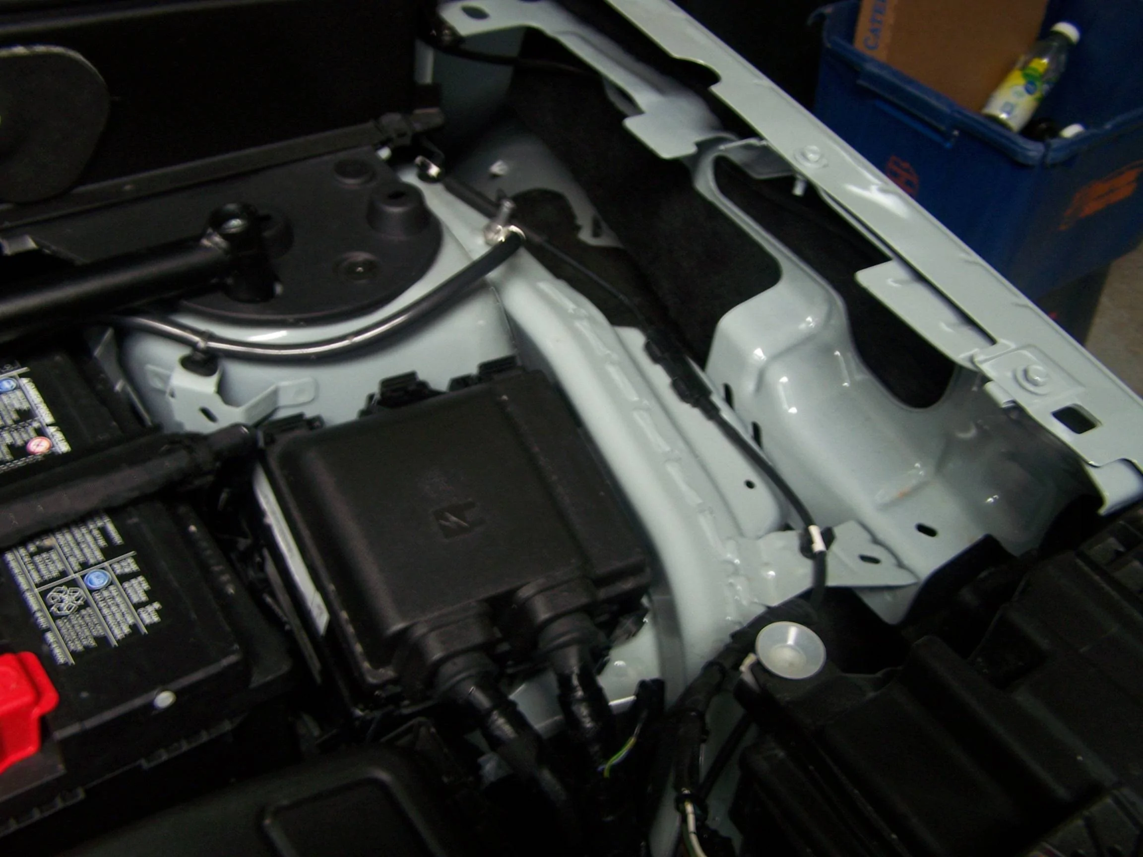

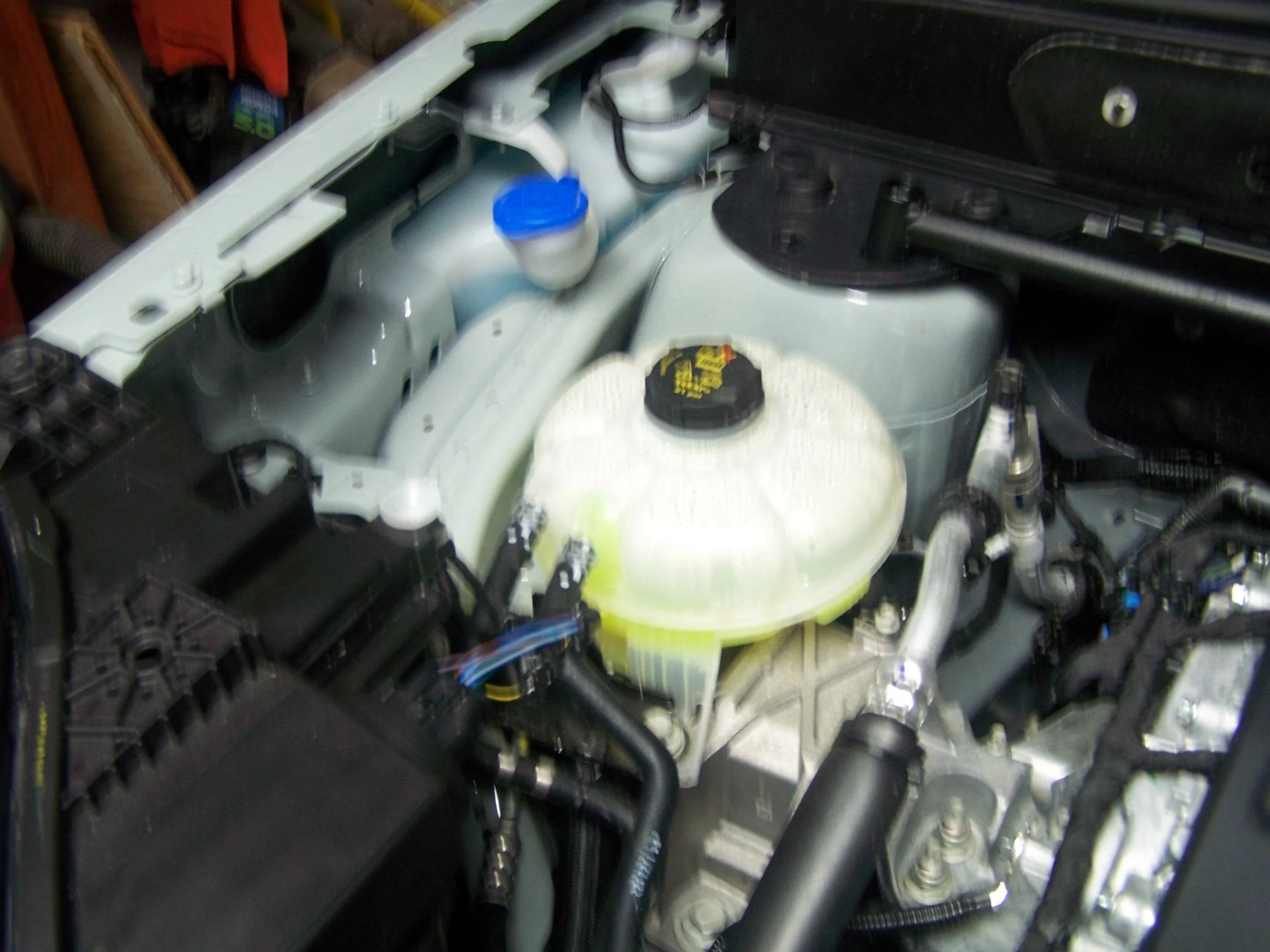

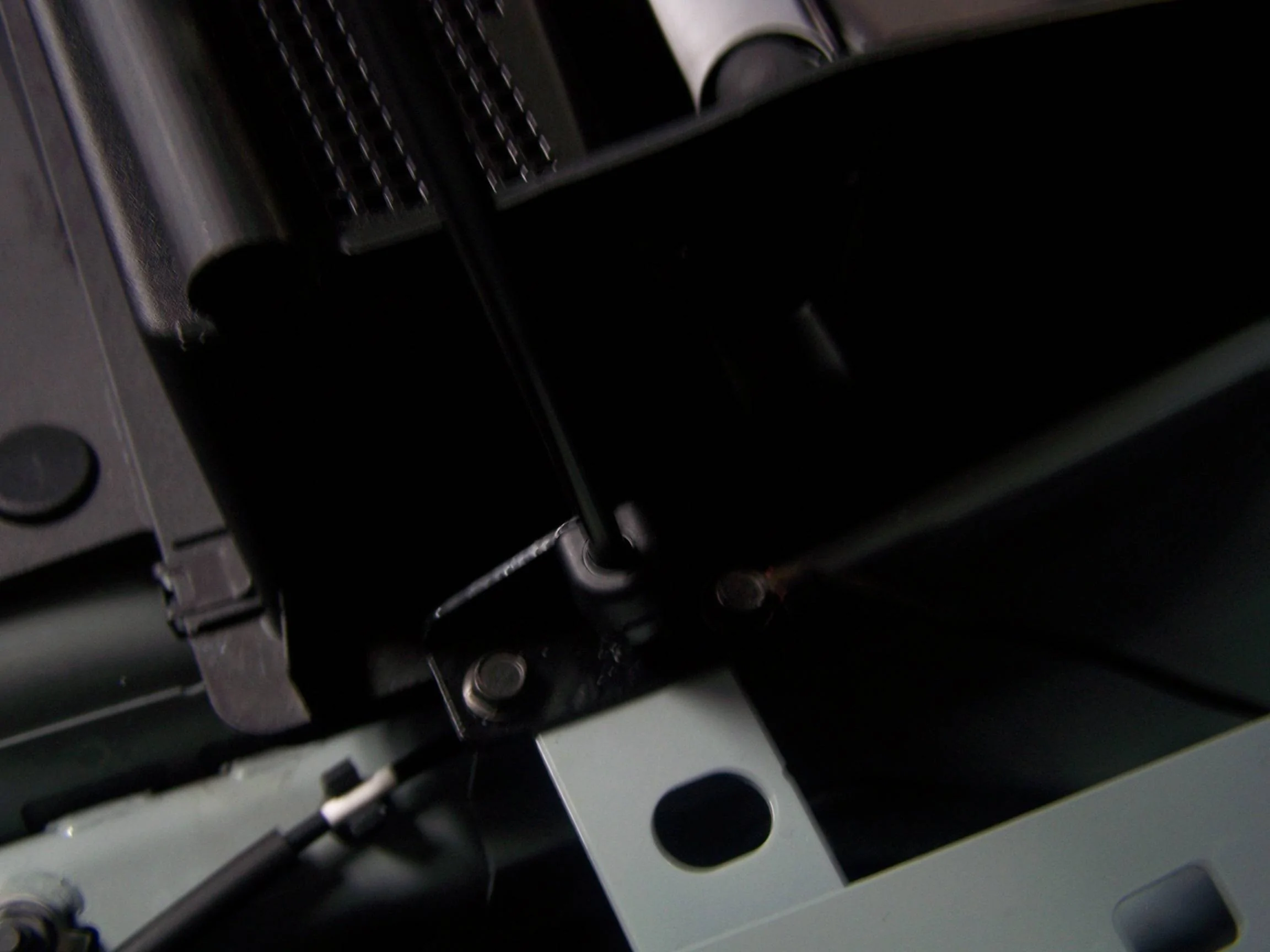

I got my lights done today. I'm sure it took longer than other folks did. It also cost me a little more (rubber tubing, shrink tubing, and liquid electrical tape). I have to admit I cheated and used inline wiretap connectors. I completely painted them over with liquid electrical tape, so I'm sure they will work fine. The other thing I did was remove the gasket when installing the lights. I got a nice tight fit without them and see no problem. I'm a little fussy about the appearance under the hood. That's why I bought an engine cover, and why I don't want colored wires running all over my fender tops. I'm happy with my install and it almost looks like the factory did it. The first pic shows where I grounded the light on each side. The next 2 show both sides of the engine compartment. Clean as a whistle. My next project will be getting the illuminated cup holders I bought wired in.

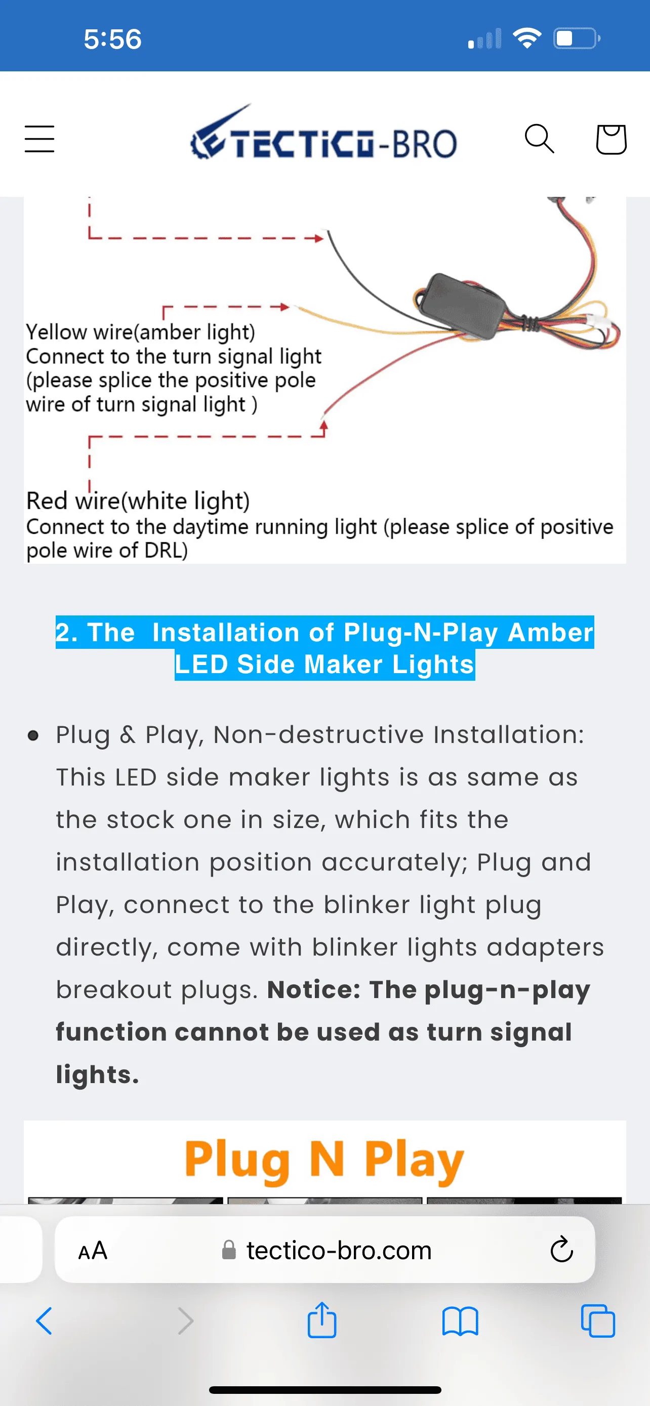

do you know if the kit/harness allows for the actual side marker to blink with turn/hazard signals on? Saw somewhere that it’s not available with this kit/harness
from Techtico website:
Ford Bronco Sport Tectico LED fender light side marker install A9AAA03B-15A7-4916-AFDD-2A08FFAF6E07

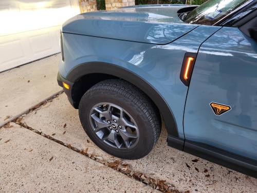

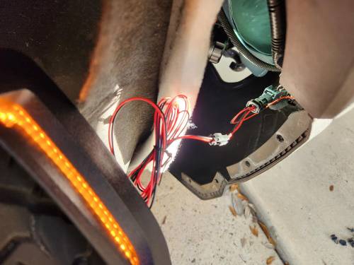

I installed the Tectico side lights today and they both work fine. I got the ones on Amazon that come with the wiring harness that plugs into the fender lamps. Popping the plug off the back of the lamp was a pain in the rear. It is an awkward angle and you can't really see what you are doing, especially on the driver's side. On the passenger side, between the foam and washer fluid reservoir, it was hard to get some pliers in position to help release the clips to remove the trim.
Overall, though, I do like the wiring harness, and once I got the plug released, it was a super easy, plug-and-play install.
