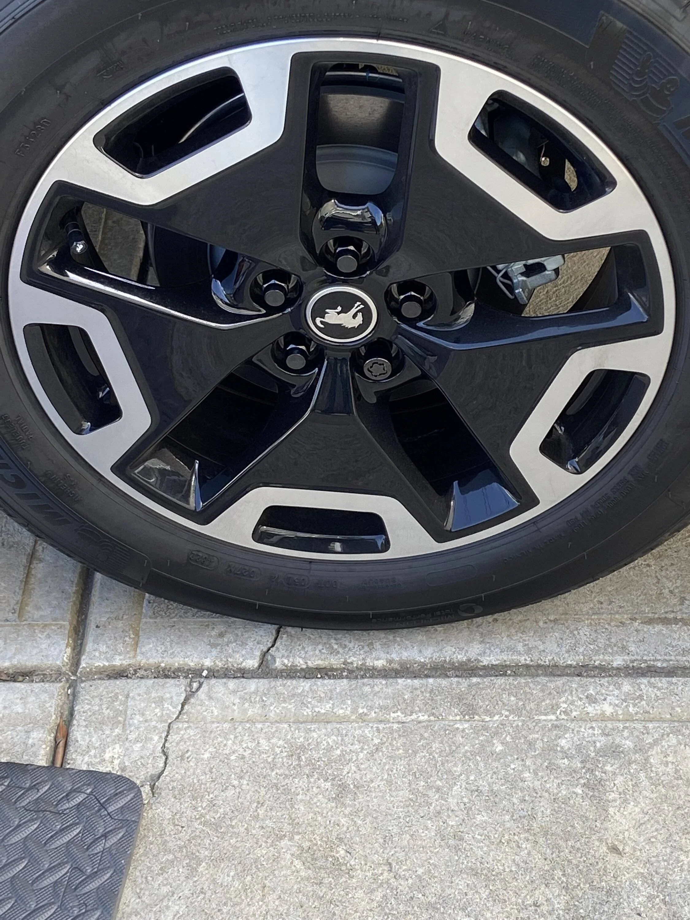

One of the first upgrades I did after buying the BL. The kit is excellent in all aspects.

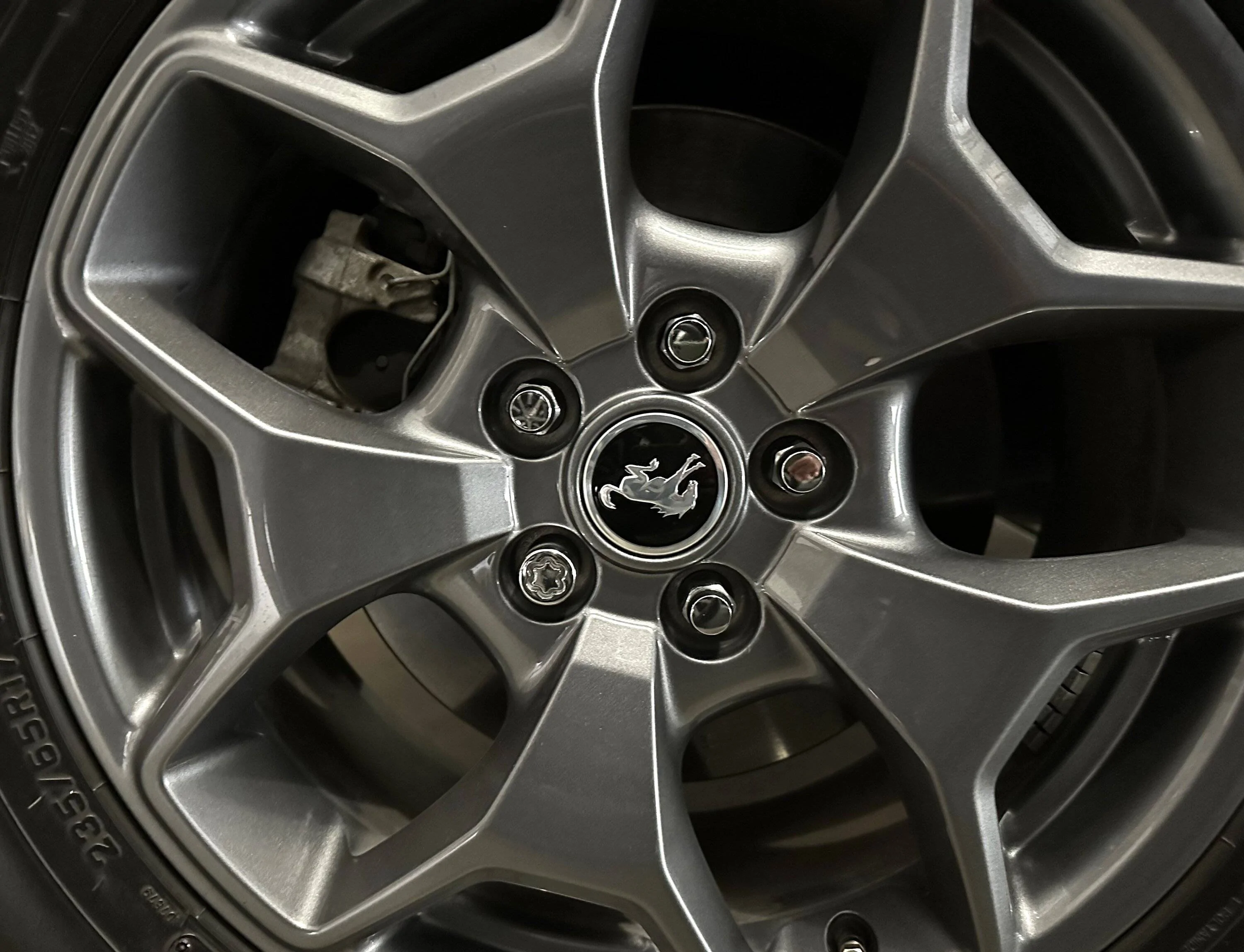

Got these also, but in chrome. Everyone, dump your 2 piece P.O.S lug nuts, especially if you are in a winter environment.
The OEM are worthless. I have had 3 Escapes also and I replaced them all, along with my BL.
I've saved the OEM's just for the hell of it. Replaced them before the caps got distorted.

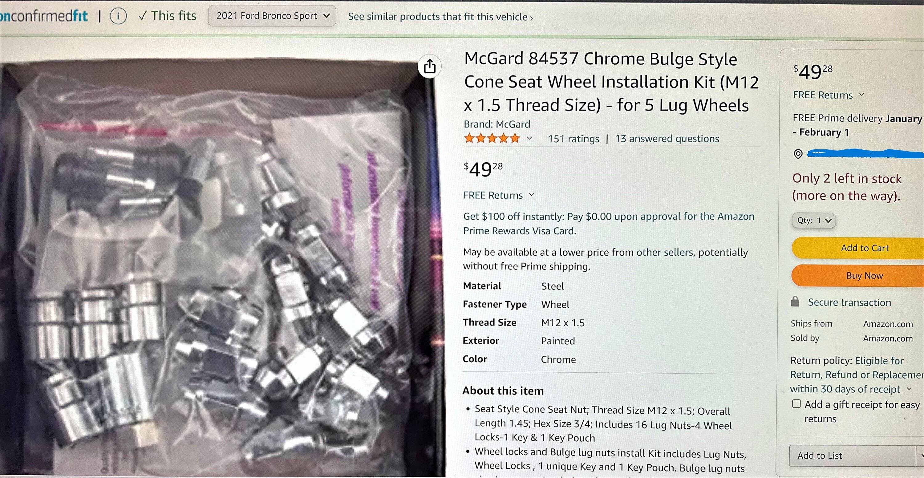

I paid $54 for the chrome locking set from McGard on Amazon.
Ford Bronco Sport Does the BS Have the Swollen Lug Nut Problem? MCGARD LUG NUT LOCK KIT 84537 $53.59
