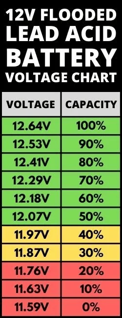

You might not be missing much. I looked into how various tools like Torque Pro etc. measures SOC. Ask the manufacturer how their tool measures SOC.
Look into Battery SOH as well.
There are also tables like these that battery manufacturers and other produce:
The second chart above is for sealed lead-acid batteries. Here's one for FLA batteries:
Ford Bronco Sport 12 volt battery charge state detection recall coming out. 1713390908038-3z
The charts I've seen vary a bit. For example 100% SOC might be anywhere from 12.60 to 12.70 volts.

Thank you … I corrected and deleted that 2nd chart, just showing the chart for AGM Batteries in the above post.
No problem. I've made the same mistake. Google images shows a variety of SOC charts, even if you specify FLA.
