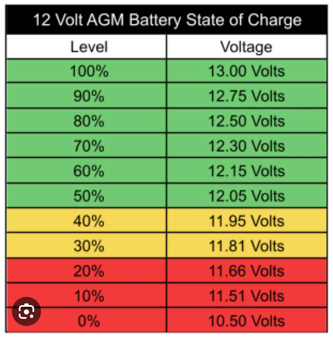

You might not be missing much. I looked into how various tools like Torque Pro etc. measures SOC. Ask the manufacturer (of the tool you buy) how their tool measures SOC.
Look into Battery SOH as well (Post #18) and at this link (e.g. Post #5 by FB71).
https://www.broncosportforum.com/forum/threads/battery-state-of-health-report-from-dealer.10826/
There are also tables like this that battery manufacturers and others create::
Ford Bronco Sport 12 volt battery charge state detection recall coming out. IMG_1959
See Post # 24 for Flooded Lead Acid (FLA) battery chart.
