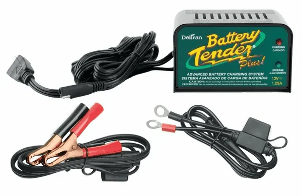

Connecting a charger every week or two can work OK. Another method I've heard of is to leave the charger connected but plug it into a timer so it only has power for about 1 hours per day.
An easier and more accurate way to keep a battery charged is to use a "Battery Tender" (or Battery Minder). They are small, sophisticated battery charger/maintainers. They can be left connected indefinitely.
https://www.batterytender.com/
Ford Bronco Sport 12 volt battery charge state detection recall coming out. 1713815321216-wz
That's the one brand I've used for a couple of decades on a classic car I owned and other garage vehicles. My BS sits a lot. Never an issue.

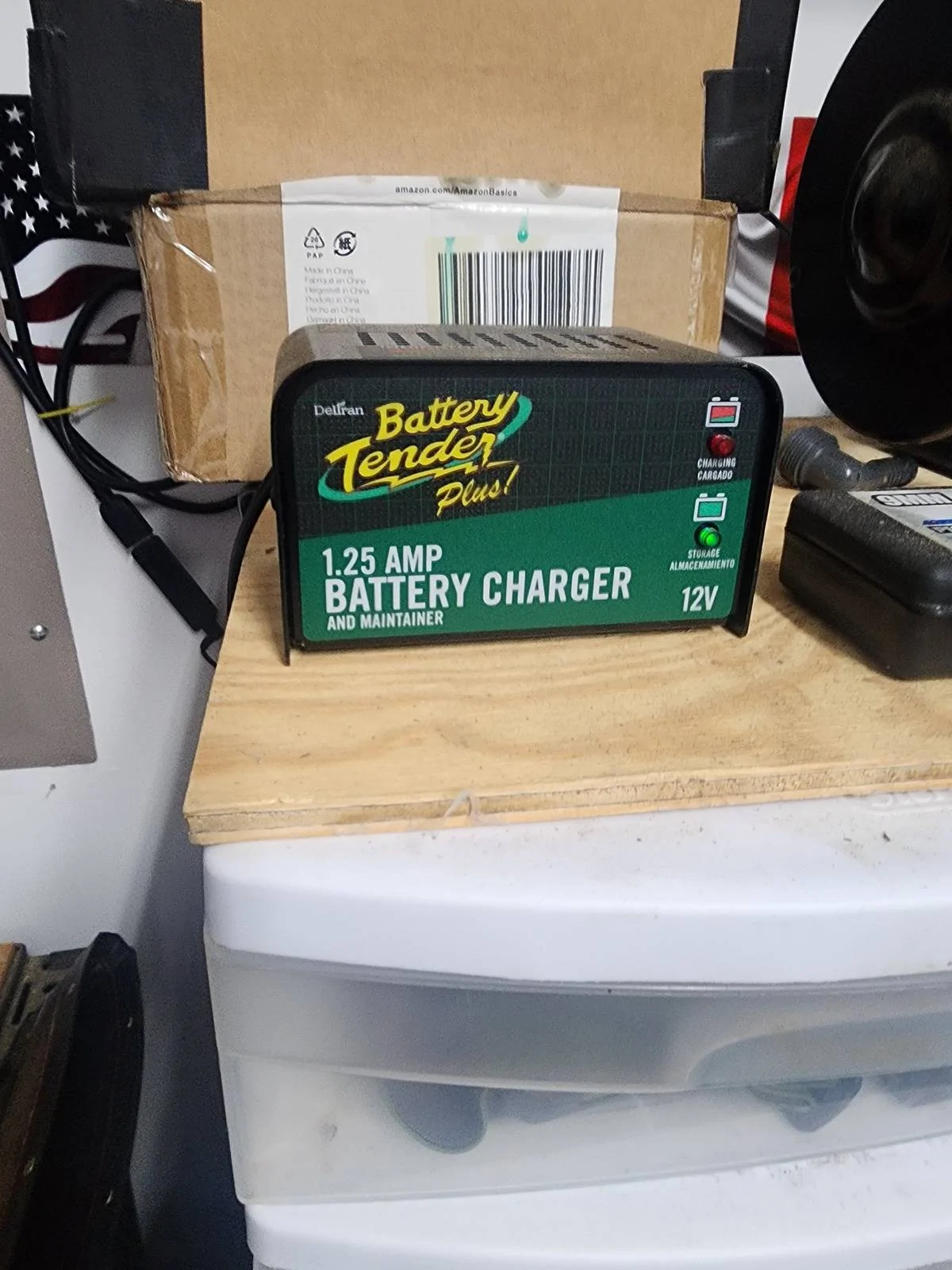

Connecting a charger every week or two can work OK. Another method I've heard of is to leave the charger connected to the battery but plug it into a timer so it only has power for about 1 hour per day.
The unit shown is older. It is just 1.25A but works fine with the large AGM starting battery in our diesel Sprinter cab-chassis.
Newer units are sealed, some are weather resistant. Outputs vary from <1A to >4A. The larger units are not necessary unless: a) the owner wants to charge the battery faster, or b) the vehicle places a large, constant, parasitic load on the battery. The output of the BT must obviously exceed the current drawn from the battery.
I've found that even BT's smallest maintainer (the 0.75A "Junior") will work on our car batteries (but I use it for a motorcycle).
A BT will easily pay for itself by increasing the service life of your battery(s).

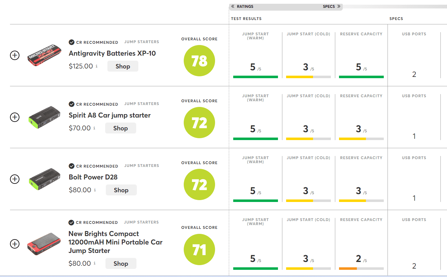

Portable jump starters (or power stations) can be helpful, but there is a lot of junk out there. Many sad tales of people left stranded. Before buying one, it's worth checking out some reviews. Here are 2, no doubt there are more, however as with many product "reviews" the primary purpose may be to earn money from affiliate links.
This first review from Car & Driver does have affiliate links, but they are upfront about it and have done some serious testing (which is more than I can say for most online reviews):
"Tested: The Best Portable Jump Starters for 2024":
https://www.caranddriver.com/car-accessories/g42569313/best-jump-starters-tested/
CR has tested them:
https://www.consumerreports.org/cars/jump-starters/c37102/
Here are the top 4:
Ford Bronco Sport 12 volt battery charge state detection recall coming out. 1713906325639-nk
The 3 columns to the right (specs) list the number of USB pots; cellphone and laptop connectors.
BTW, one thing that's often overlooked about CR is that they usually collect a lot of useful info about specs and features in one place. That makes it easy to compare products side-by-side. It's just solid, factual information, no opinions involved.
