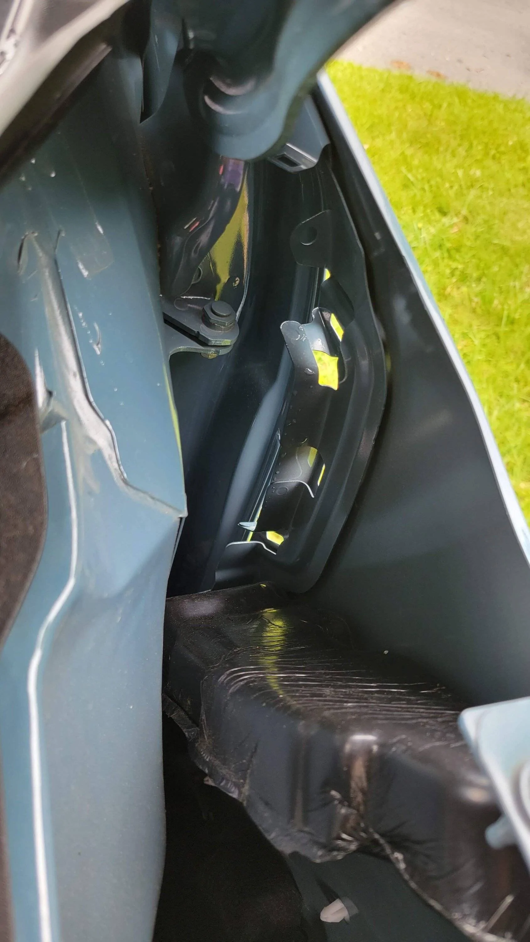

Managed to find some time to install my side lights today. Must say, it was much easier than I feared. The only trouble I had was getting to the bottom clip on the passenger side, but once I realized I could see it when I opened the door, I was able to get my needlenose pliers on the clip and pop it free with no problems.
Here's a view of the driver's side opening with the trim piece removed:
Ford Bronco Sport Tectico LED fender light side marker install drv opening

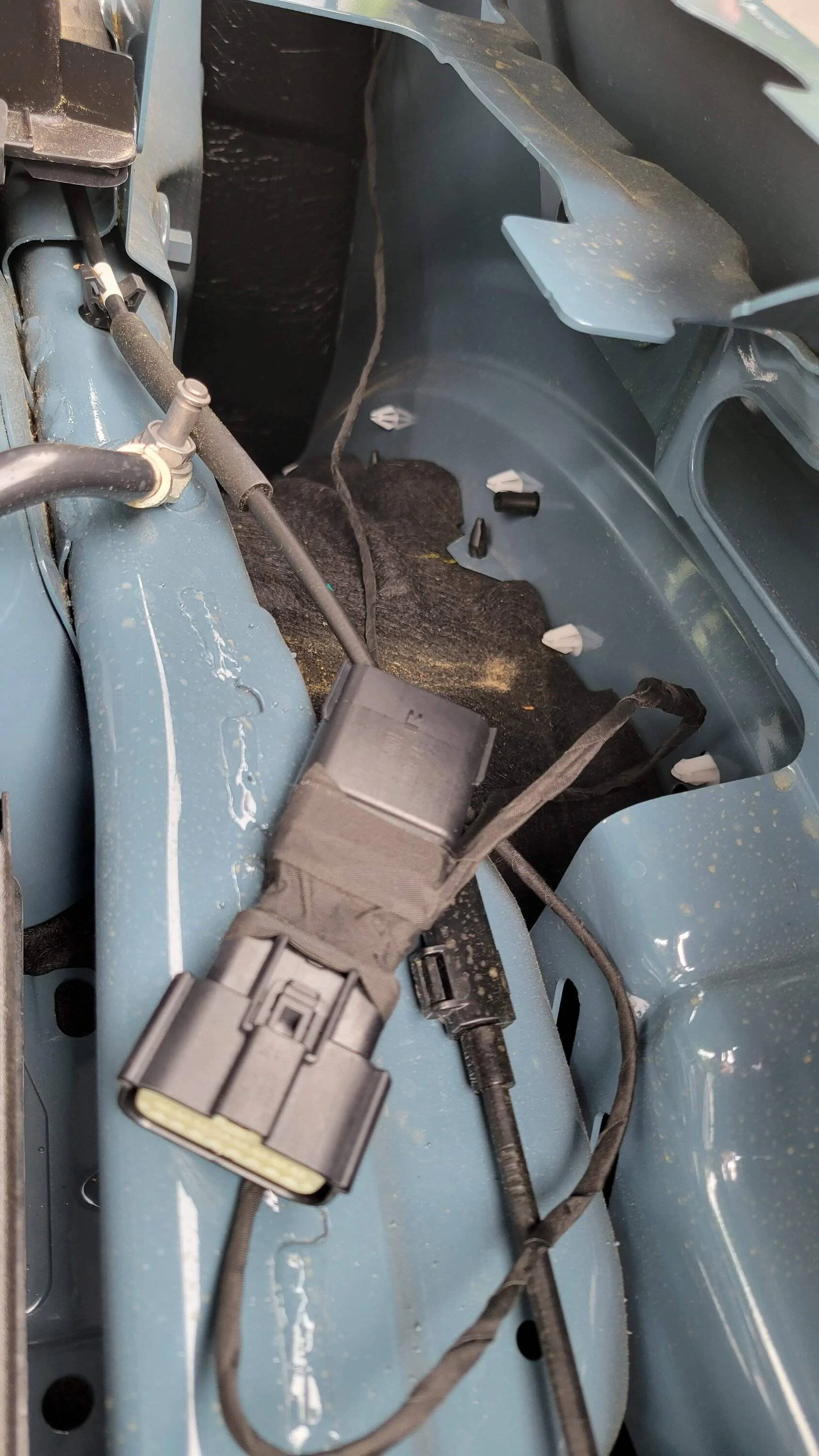

Which allowed ample space to thread the wiring which was preconnected to the connector (insulation replaced):
Ford Bronco Sport Tectico LED fender light side marker install drv wiring 2
and zip tie it to the body supports (zip ties were cut short later. You can see the wiring running from the upper left then under the body support to the zip tie ni the middle of the shot, through the OEM wiring clip and finally zip tied to the OEM wiring at the connector):

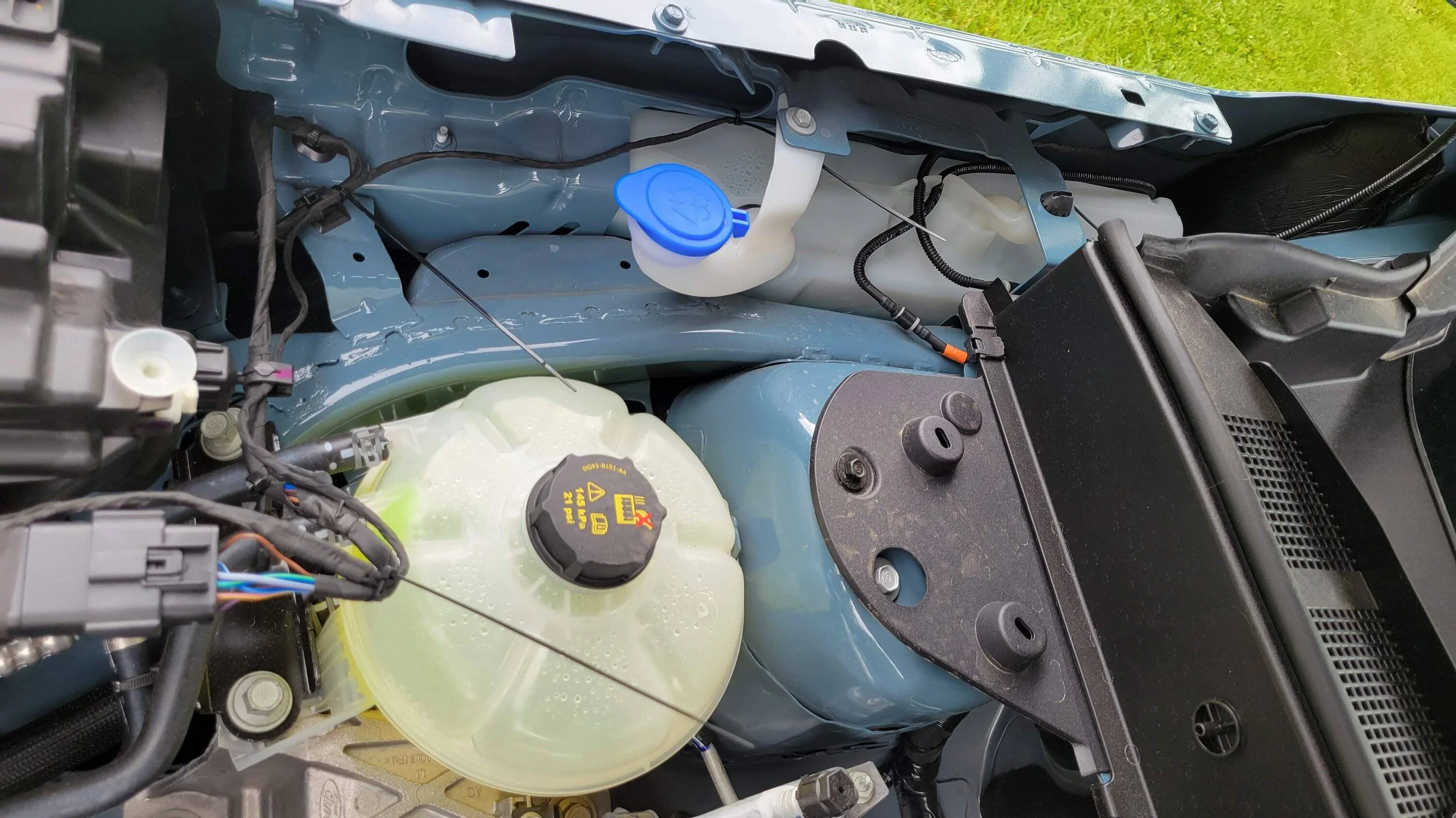

This is a view of the problem clip through the door opening, which I was able to access through the hood with my hand while watching through the door gap since the winshield washer fluid tank makes that area a bit tight to fit a hand and see what you are doing:
Ford Bronco Sport Tectico LED fender light side marker install Pass cli

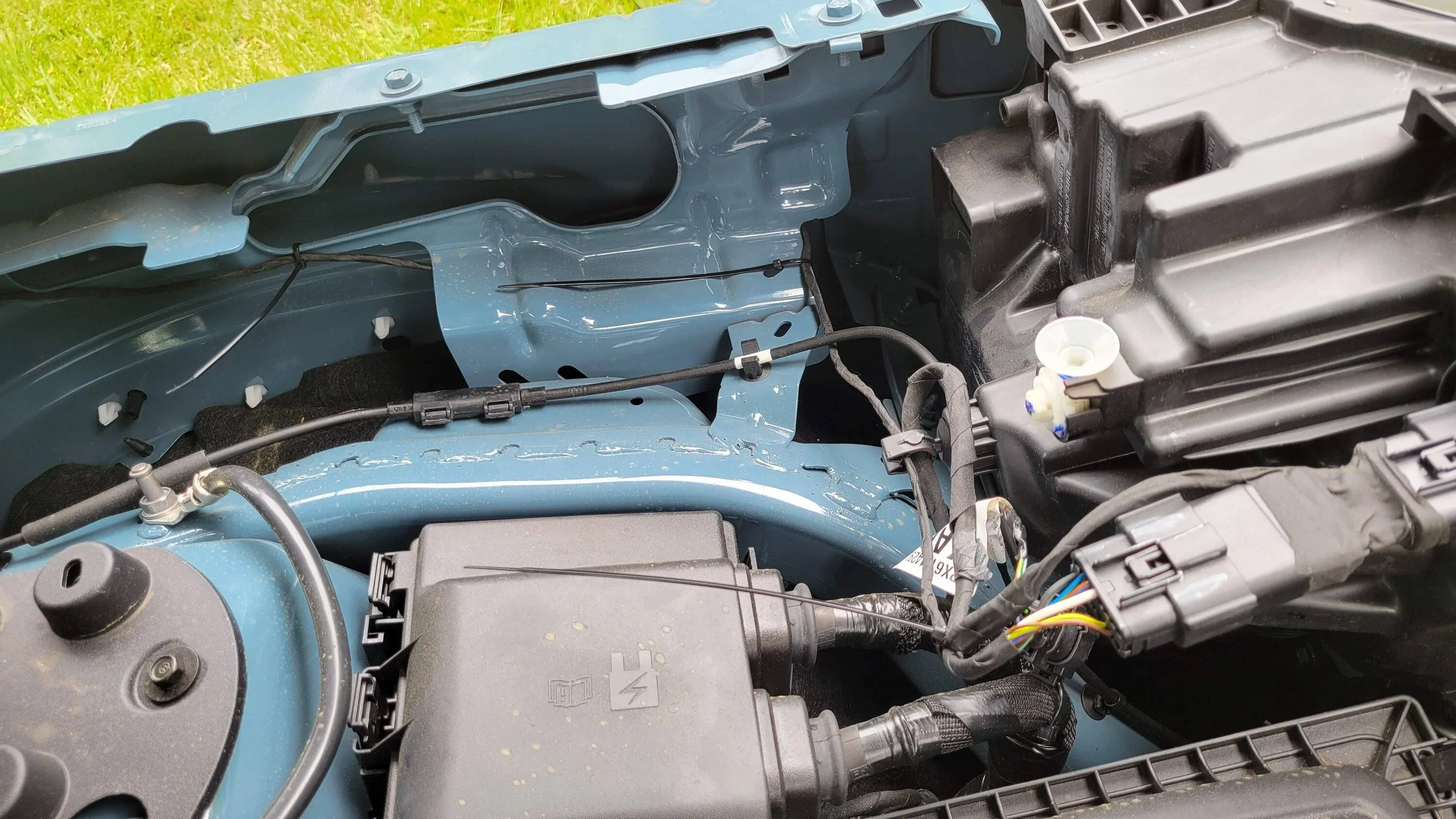

And finally, similar wiring run as the driver's side (again, zip ties cut short later):
Ford Bronco Sport Tectico LED fender light side marker install pass wiring
All is working perfectly. Aside from making my own connector harness and using harness tape over the length of the wiring, I added some RV silicone around the wire entry into the side lights to act as additional waterproofing and a bit of strain relief. Very pleased with the results. Definitely looks like it was supposed to be this way from the start.
