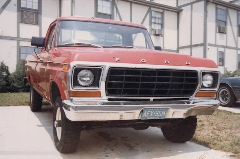

I never bought into the "symmetrical" marketing.
My vehicle from 1978 to 1988 was a Ford F-150 4X4 pickup truck and the front differential was offset to the driver side. Never experienced any problems when taking it off-road.

Nice truck!

Thanks! Yep the F-150 was the one vehicle I truly miss. Got married in 1985, had our first child in 1986, and needed to purchase a single family home. The home shown behind the truck is a condominium and was way too small to raise a family. Too close to the road with a small back yard, it was not safe enough for when our son became older.

Thanks! Yep the F-150 was the one vehicle I truly miss. Got married in 1985, had our first child in 1986, and needed to purchase a single family home. The home shown behind the truck is a condominium and was way too small to raise a family. Too close to the road with a small back yard, it not safe enough for when our son became older.

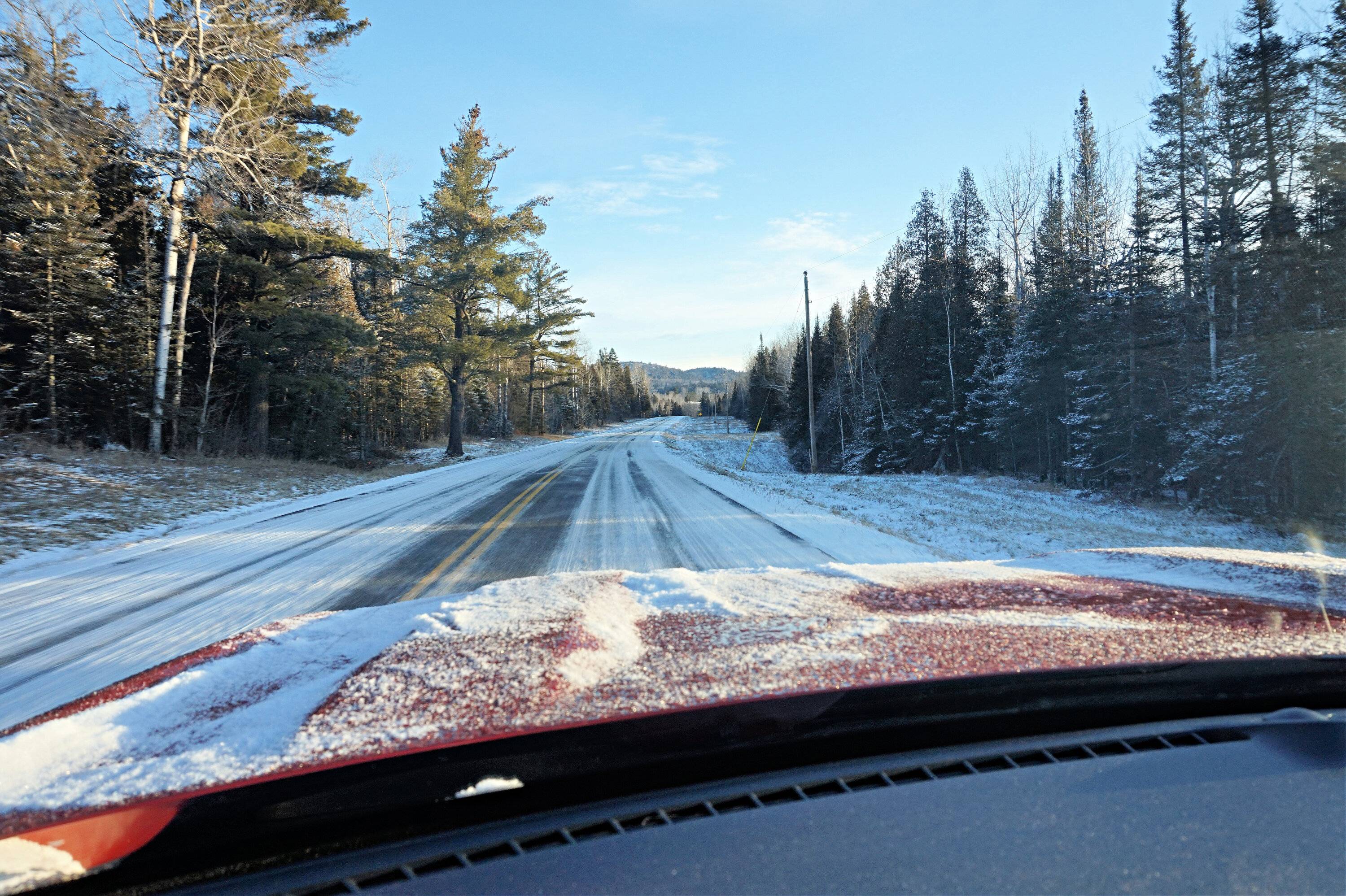

I experienced the same yesterday in northern Minnesota. The roads were def bad and I could feel it too. This was also my first test with the Big Bend and although I was somewhat surprised it simply is not a F150 in 4x4. I kept my speed down.
Ford Bronco Sport Rear tires slipping in snow/slush DSC09234pm
Nice photo!
Just curious -- did you try the "Slippery" and/or "Sand" GOAT modes?\
BTW -- The manual says to use Slippery on snow, and specifically says NOT to use Sand, but it's not clear to me why.
Did you have it on slippery mode or did you turn slippery mode after you felt the tires slip? How fast were you going when you felt the slip, and did you feel it again? The roads I am going to be driving on are going to get bad starting tomorrow, I just don’t know what I’m going to do other than drive super slow.
