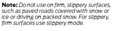

The manual states:
SAND mode allows higher engine revs and more wheel spin, which can be useful in sand or deep snow. You want LESS wheel spin on icy/slippery surfaces, so the PCM reduces throttle response and short shifts to keep engine revs down.

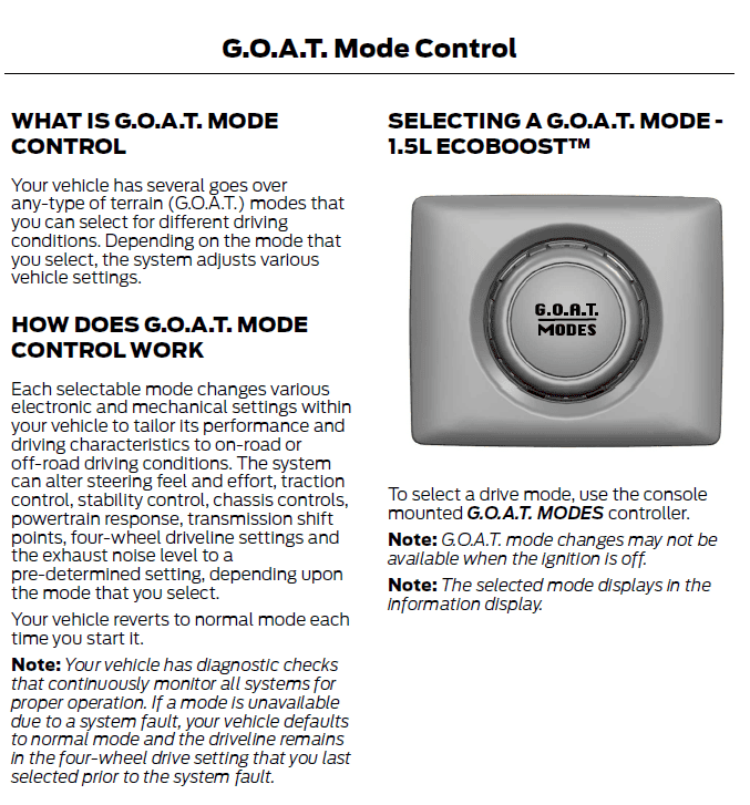

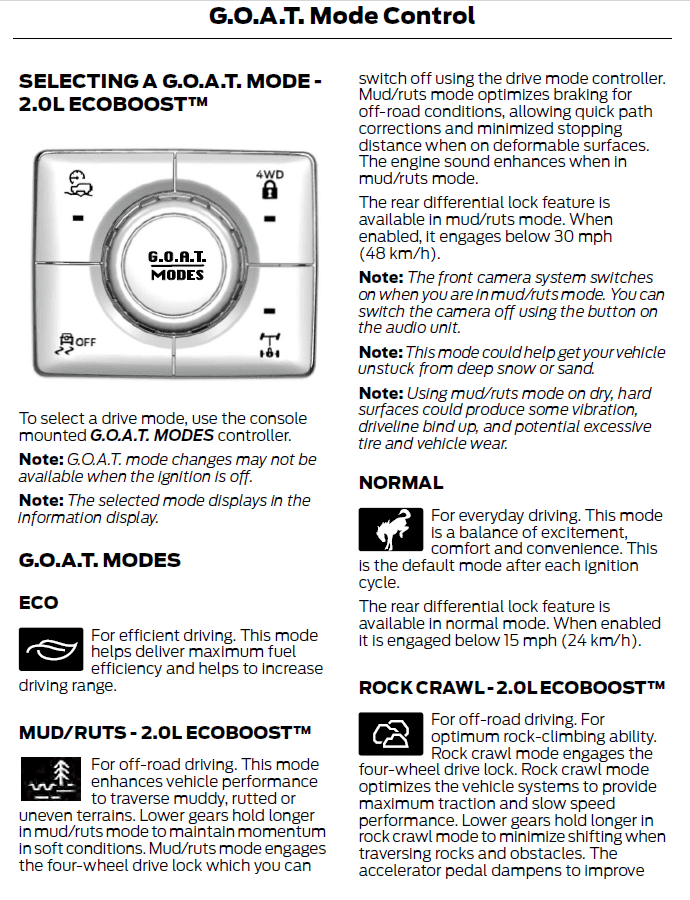

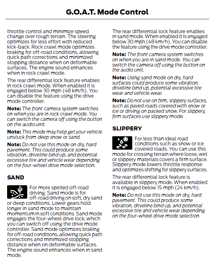

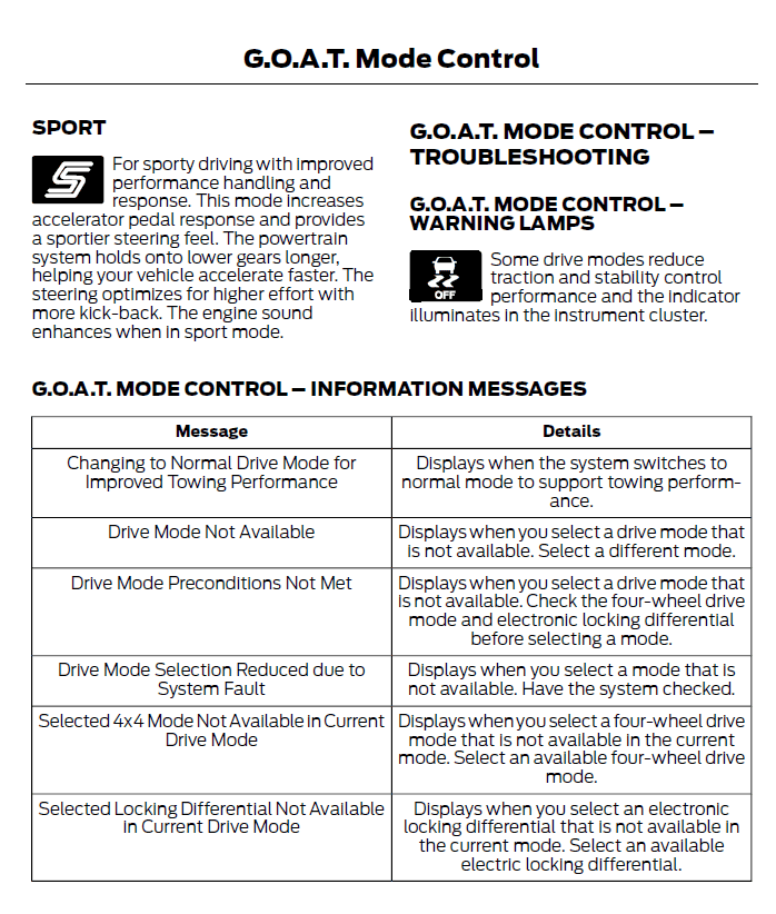

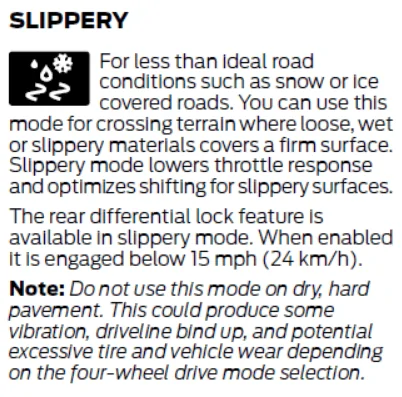

For anyone who's interested, this what the 2022 BS manual says about the GOAT modes:
Ford Bronco Sport Rear tires slipping in snow/slush 1704335950458
Ford Bronco Sport Rear tires slipping in snow/slush 1704335598209
Ford Bronco Sport Rear tires slipping in snow/slush 1704335671287
Ford Bronco Sport Rear tires slipping in snow/slush 1704335722386

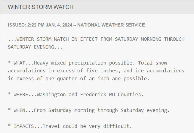

Check your weather report for this coming Saturday.
Ford Bronco Sport Rear tires slipping in snow/slush Saturday January 6

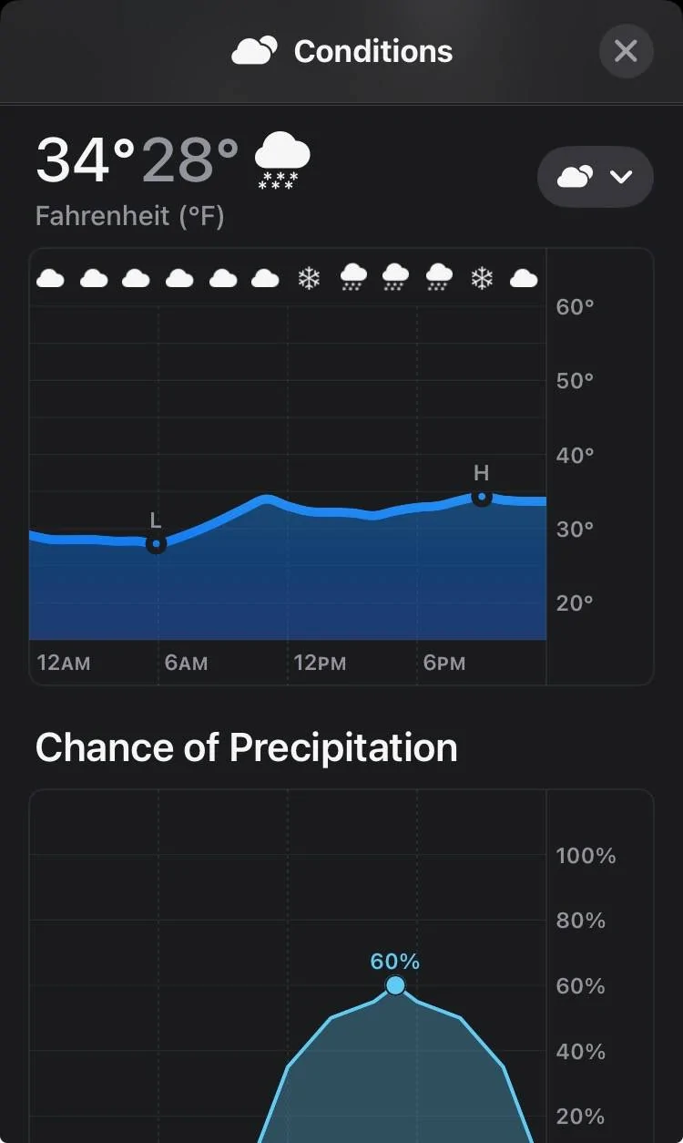

I've been watching the Wunderground forecast. The predicted amount of snow keeps changing. It's been as high as 8+ inches but currently it's 5". It's a 100% chance, but only from about 1 PM to 7 PM -- with a good chance for snow about 2 hours before and after.
5" is still enough to test the GOAT modes. One potential issue is that the county usually gets to our road quickly -- sometimes they plow during the storm. That's normal for main highways, but our road gets light traffic and for the county it's a dead end. County maintenance ends just a couple tenths of a mile north of our lane. The road continues, but the plows turn around there -- so every one makes a double pass.
That's all good -- except when you want to test your BS BL. :cool:
We have our lane too, so if the plows clear the road before we have a chance to get out there, we can still do some limited playing -- I mean testing.

The latest:

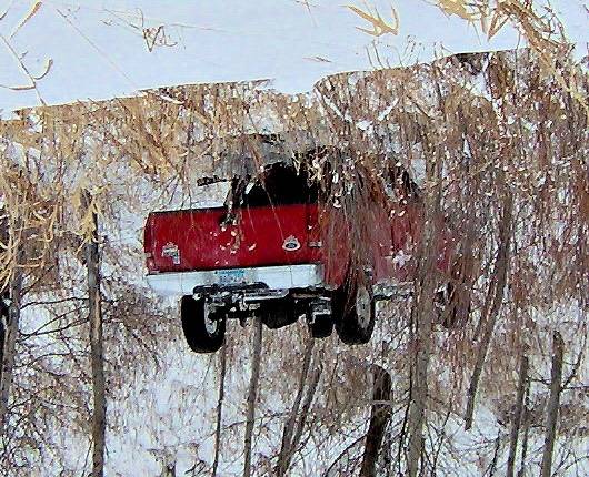

I was in slippery mode doing 40mph when my 'Spidey sense' went off and I thought I was feeling the wheels close to losing traction. I just kept decreasing my speed until it went away which was around 35mph. It was slick stuff. Even if I had been in my F150 in 4x4 I doubt I would have been going over 45mph since all that would do is get me in the ditch faster once I lost total traction. I've never lost control and gone in the ditch the 40 years I've been driving Minnesota winter roads. Guess I've been lucky in being able to feel the traction and slow down if I needed to.
Ford Bronco Sport Rear tires slipping in snow/slush upside down

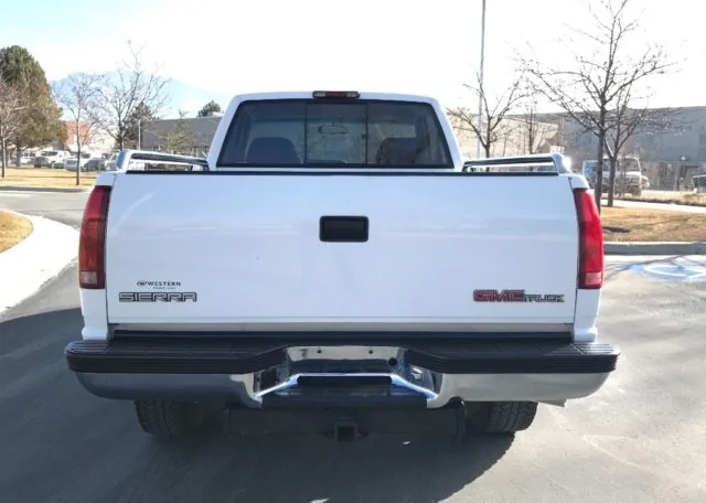

Any idea whose vehicle that is in the photo, and if they are OK?

A GMC Sierra?

More on GOAT modes:
From the 2022 owner's manual (see post #63):
SAND mode:
Ford Bronco Sport Rear tires slipping in snow/slush 1704423391048
ROCK CRAWL:
Ford Bronco Sport Rear tires slipping in snow/slush 1704423495134
MUD/RUTS:
Ford Bronco Sport Rear tires slipping in snow/slush 1704423581944
It's unclear if ROCK CRAWL and MUD/RUTS are ONLY intended for getting unstuck, or if they can be used on snow-covered roads. Unlike SAND mode, there is no mention of it.
