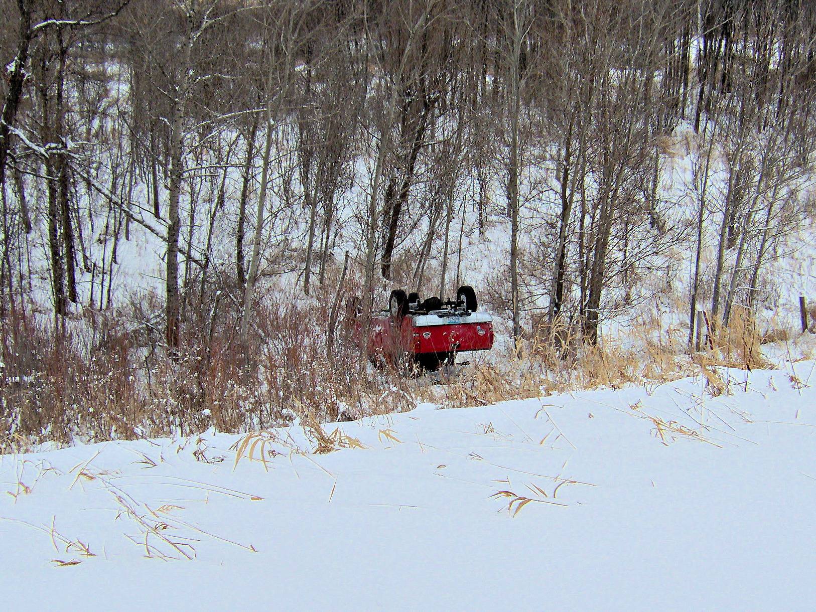

Ford Bronco Sport Rear tires slipping in snow/slush upside down
That’s exactly what happened when my back tires slipped, slowed down enough to where other cars were zooming by me. Just wondering if this is going to be an ongoing problem, and the roads where I live are slick all winter long, black ice out there right now, waiting for the next storm on Sunday.

Any idea whose vehicle that is in the photo said:
Yes I was heading up to the cabin in some bad weather and a guy, his wife, and son had just walked up on the road where a Highway Patrolman was waiting for them. I pulled over and snapped a quick pic. They were kind of laughing about it, even though the guy seemed to have a cut on his head and was bleeding.
