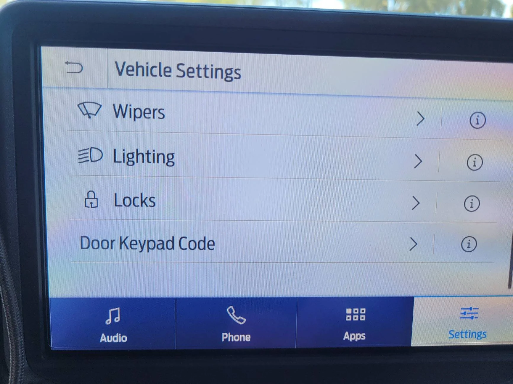

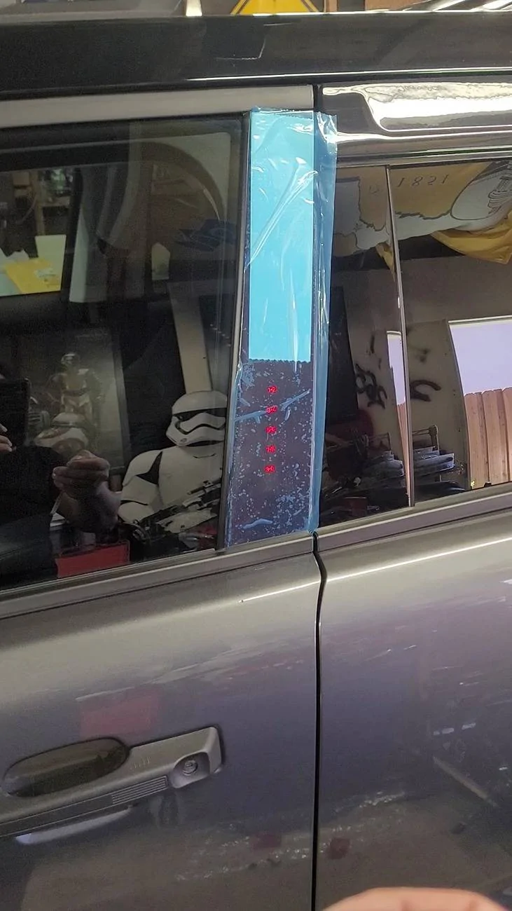

Got it in. Install took maybe 45 minutes. Worst part is putting the glass back into the door.
Ford Bronco Sport Quashish Family Ride Thread : 2024 Badlands VideoCapture_20250414-152259
Ford Bronco Sport Quashish Family Ride Thread : 2024 Badlands 20250414_151817
Had to use forscan and enable "keypad" under Body Control Module
And "door keypad" in APIM
Which allowed the new menu item to be able to add custom code
Ford Bronco Sport Quashish Family Ride Thread : 2024 Badlands 20250414_150340
Great addition and can't beat free parts, and not wasting a day at the dealership.

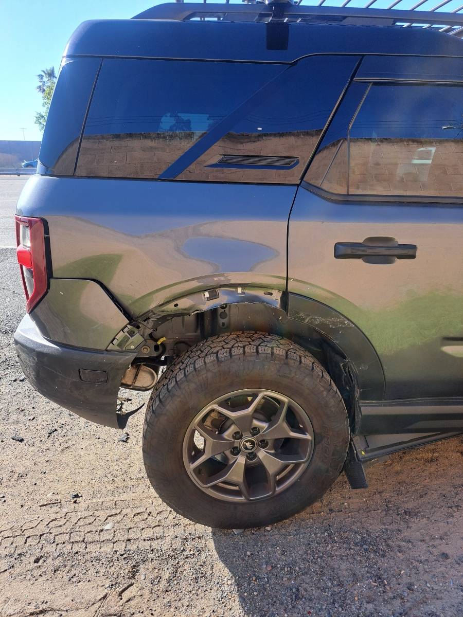

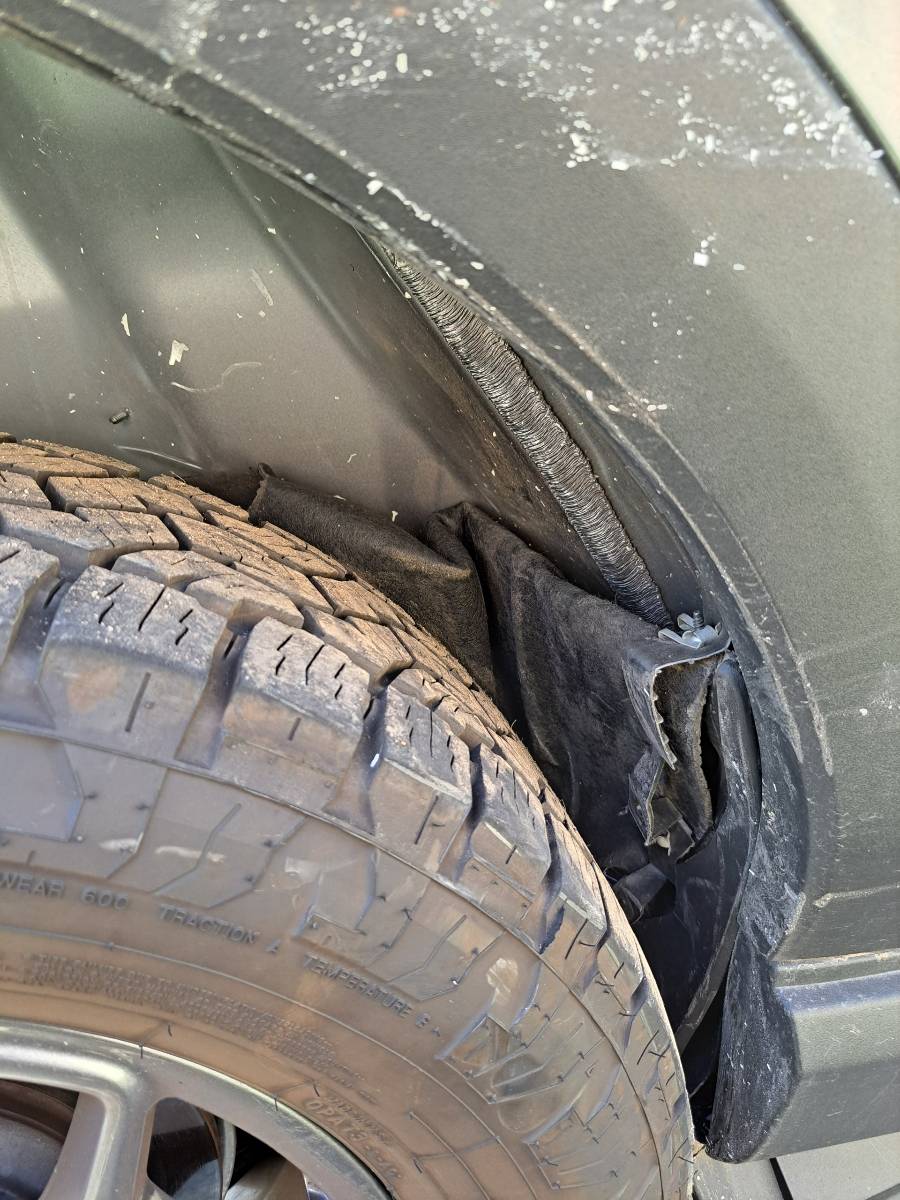

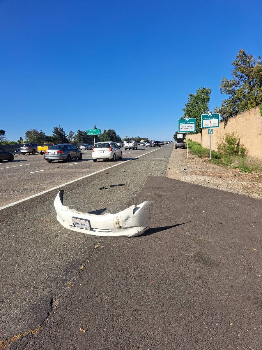

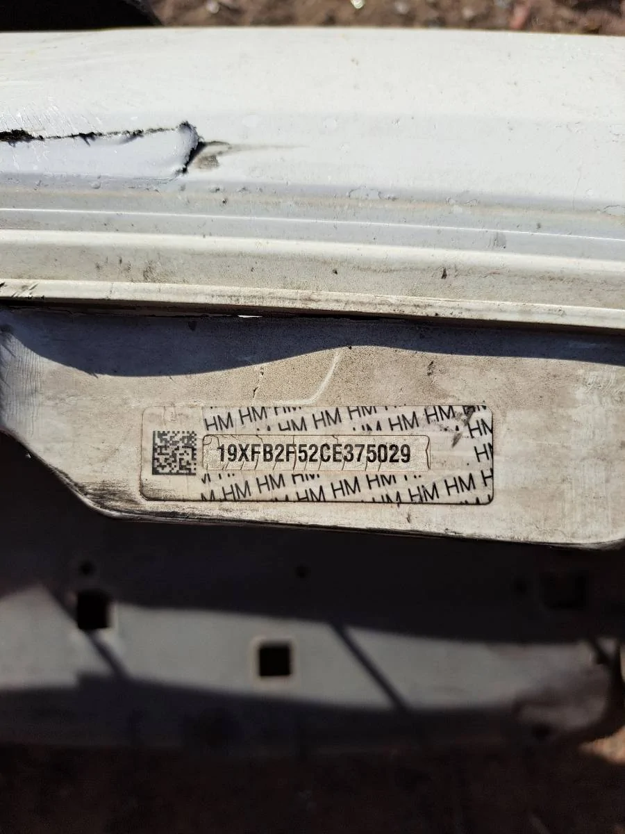

2012 civic hit and ran my wife on her way home not even 1 mile from the freeway exit to get home.
Wife is mostly okay, she already has a bad back so going to get checked out. Shes definitely in some pain. Made police report but we will see what happens. I was on my way home when she called me, went over and met her with the tow truck. I had to remove the wheel to get the wheel well liner and mud guard out. Rear trailing arm is bent giving some forward caster, toe in, and positive camber. On that rear passenger wheel.
Traffic stopped probably because there was a group of people with signs on this footbridge over the freeway with Jesus signs distracting everyone. Also semi and others honking horns.
Could've been worse, when traffic came to a halt she was behind a truck towing a boat. Only going 50mph with good following distance And had to move over. The car behind her did not stop in time.
Still have to call insurance, but dash cam got everything.
Figures, since I just got this badlands up to par.
Have a good weekend everyone

Hope all goes well for your wife and getting the Sport repaired.
It shouldn't be too hard to figure out the fool who caused it with your das cam and the bumper with the license plate on it.
Another uninsured A hole I bet.

Wife's back doing good thankfully, I was worried about that. It was my day off, the collision center was open and I was there at 8am but weren't ready for me and had to come back at 930, got paper work all filled out, initial estimate before adjuster came out is $10,056.25
$1000 deductible waived, no info back on the police report side, sent dash cam videos, screen shots, and scene photos to adjuster. Going to send to CHP officer as well for police report, just been busy.

no real updates, the collision repair place usually calls Tuesdays and Thursdays so I should get something more today.
not sure why it took so long to get going, was a bit nervous at first they had a hard time finding a body panel that goes behind the tail light, up to the roof, and part of the spare tire well, found it and had to confirm if that zone could be sectioned or not, if not the whole entire roof would have to come off since that rear panel tucks under the roof and is welded. thankfully that is not the case. they are sectioning in a piece at the factory seam.
total cost for insurance is $12k and some change so far.
