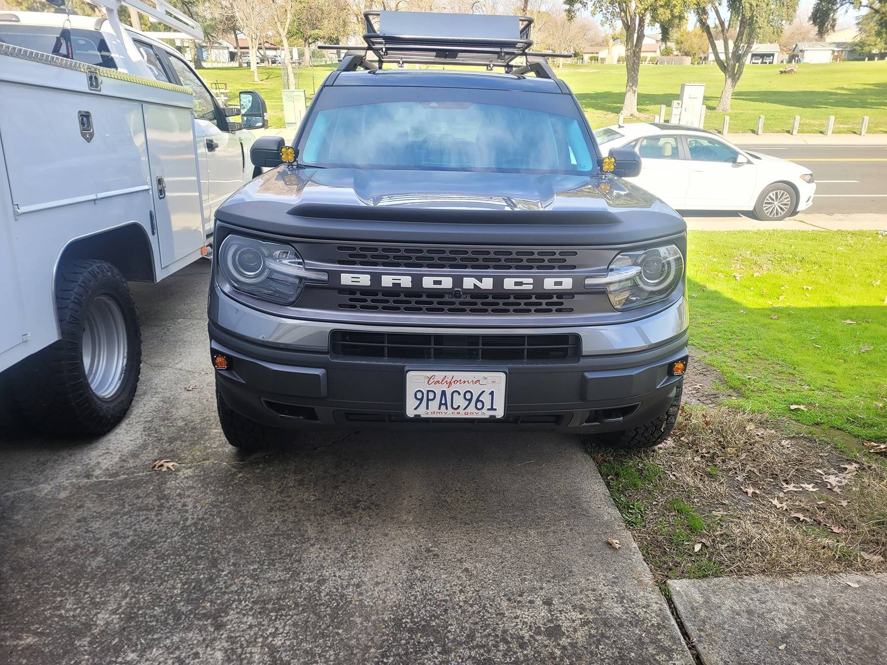

So as far as the steeda strut tower brace goes, I wouldn't say it changed the driving dynamic much if anything at all, I'm just glad it's on for extra structural support. Drove some really windy canyon roads on our Yosemite trip and she handles really well. Almost forgot I was in the sport. Unfortunately only took one pic near the trail head and it's not great.

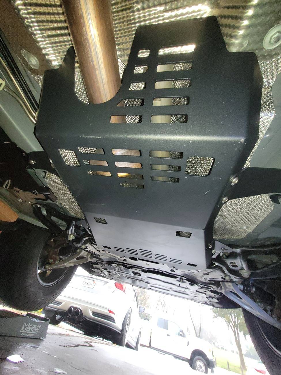

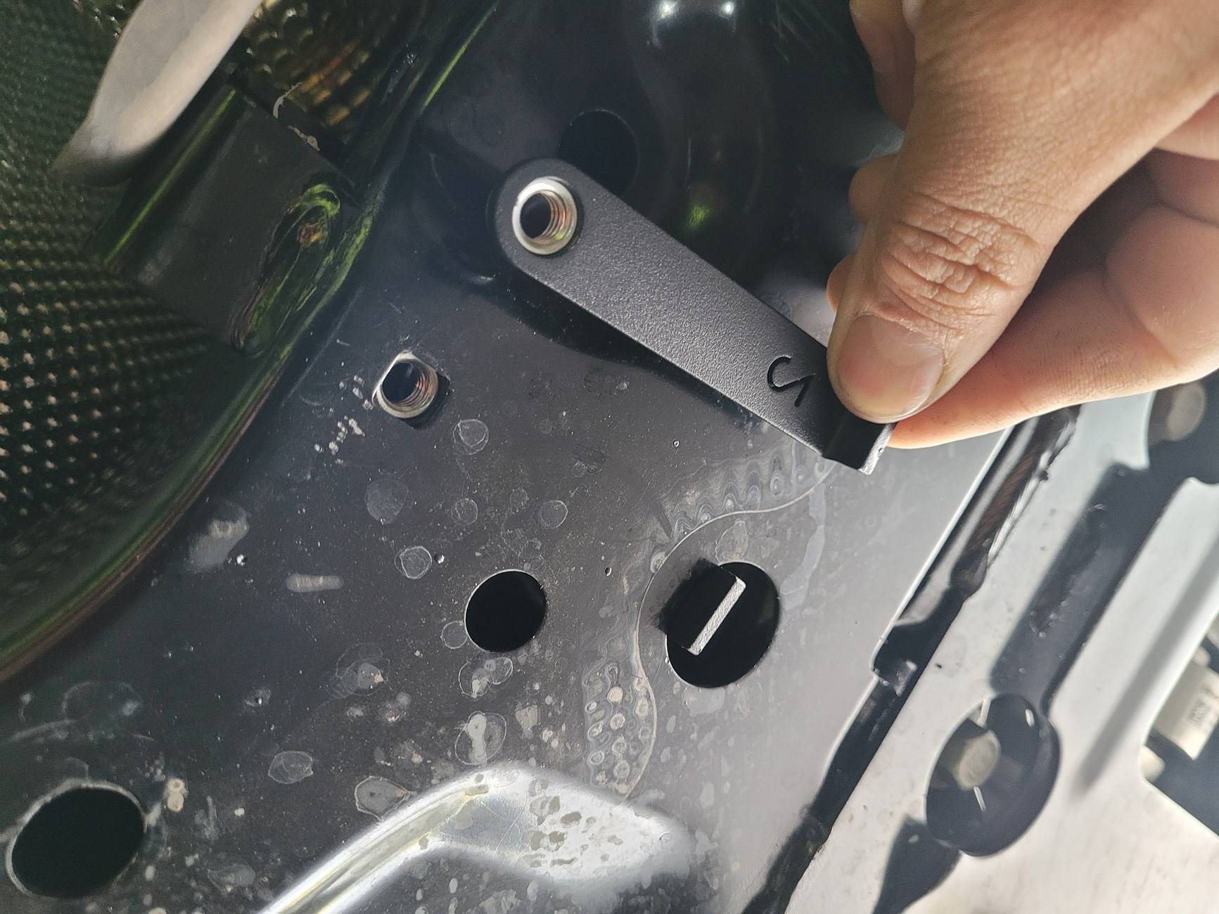

I usually never sit on car parts this long but had this JCR plate in the box in the garage for at least a week. The instructions are kind of terrible. So here's some close up pics of how the brackets sit inside the lower crossmember.
Ford Bronco Sport Quashish Family Ride Thread : 2024 Badlands 20250201_141408

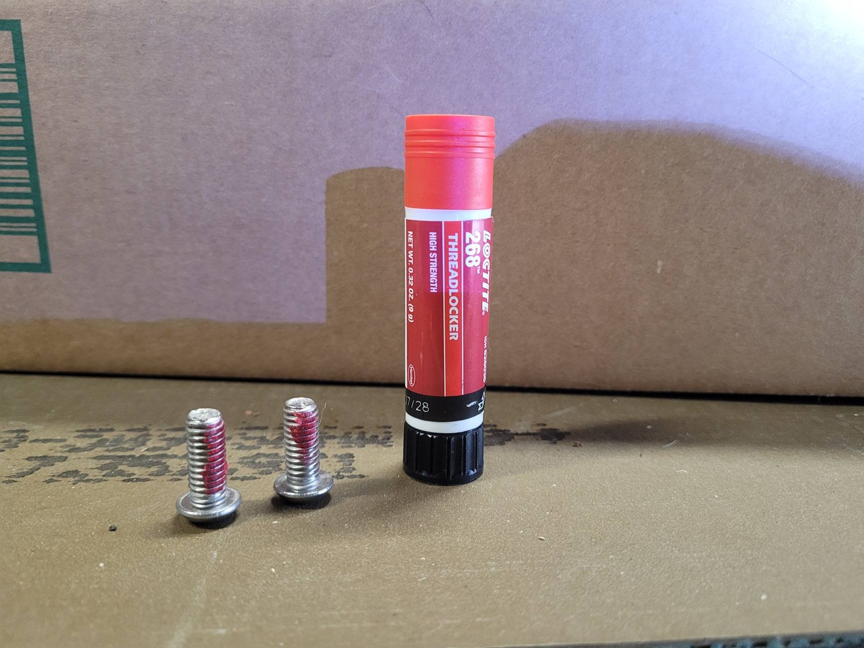

I used some red loctite on all the bolts. I like the stick, no drippy mess.
Ford Bronco Sport Quashish Family Ride Thread : 2024 Badlands 20250201_141904

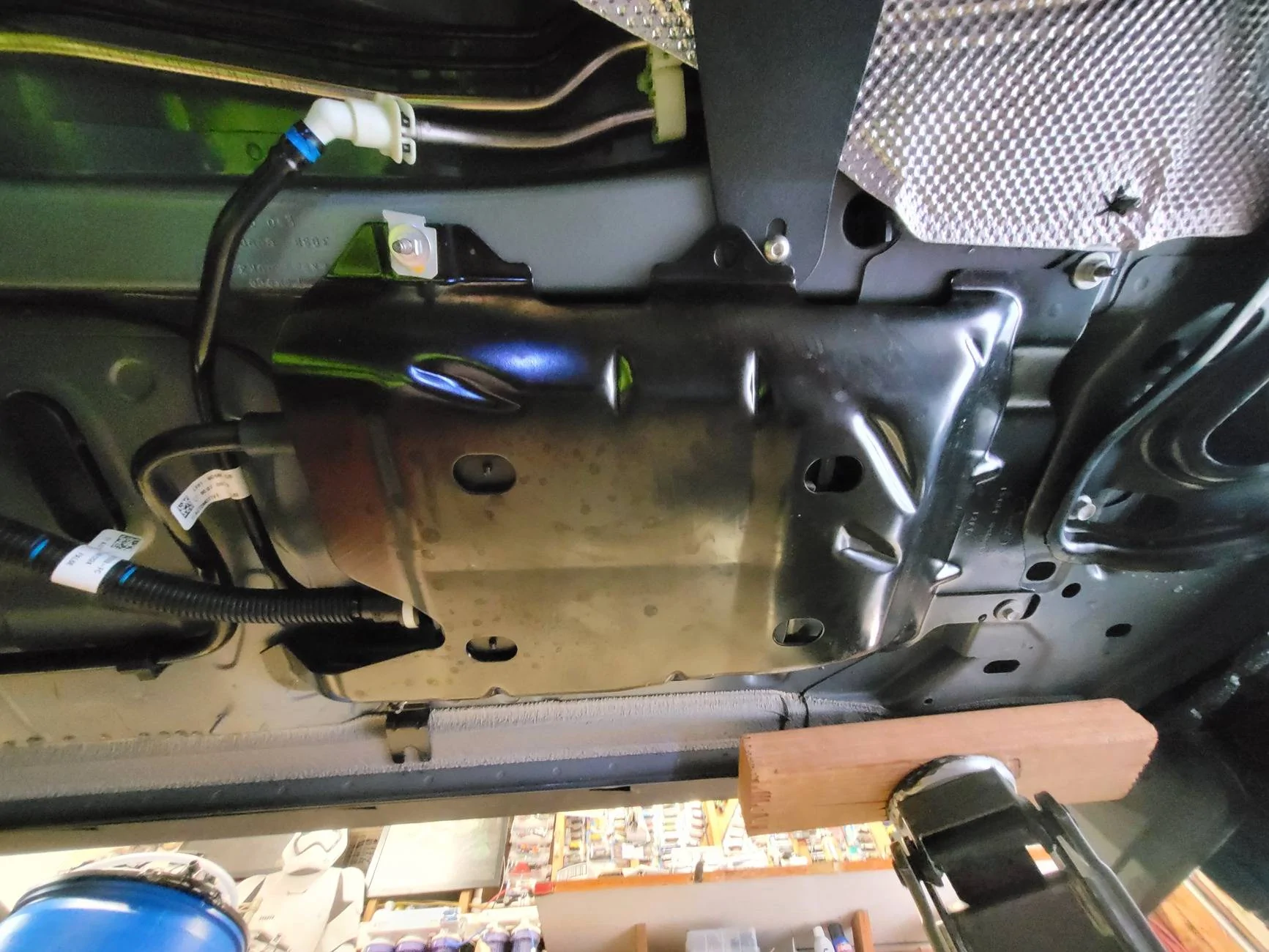

On the badlands there's a metal cover on the drivers side I also had to loosen to fit the mid plate bracket under
Ford Bronco Sport Quashish Family Ride Thread : 2024 Badlands 20250201_145659
Ford Bronco Sport Quashish Family Ride Thread : 2024 Badlands 20250201_145719
Took about an hour by myself. Ended up not having to trim any of the felt cover like the instructions and video say.
Ford Bronco Sport Quashish Family Ride Thread : 2024 Badlands 20250201_145756
Also realized I'm missing the passenger side felt. I guess it doesn't matter since there's nothing there to protect but my OCD tells me it should be symmetrical. Pretty sure the big bend had a cover on both sides. And the sport in the video on JCR has one too. Didn't pay attention to that last time i was under here to change the oil.

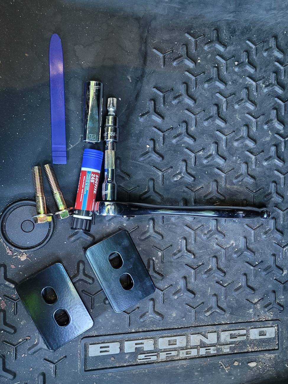

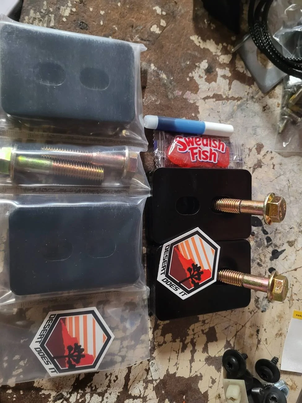

Installed them today. Originally I was going to remove one of the seat bolts and see what the thread pitch was and get a longer bolt and stack some washers. But it was easier to just hit order. I will update with the correct thread of the bolt of anyone is interested in doing a DIY version of this as I was going to do.

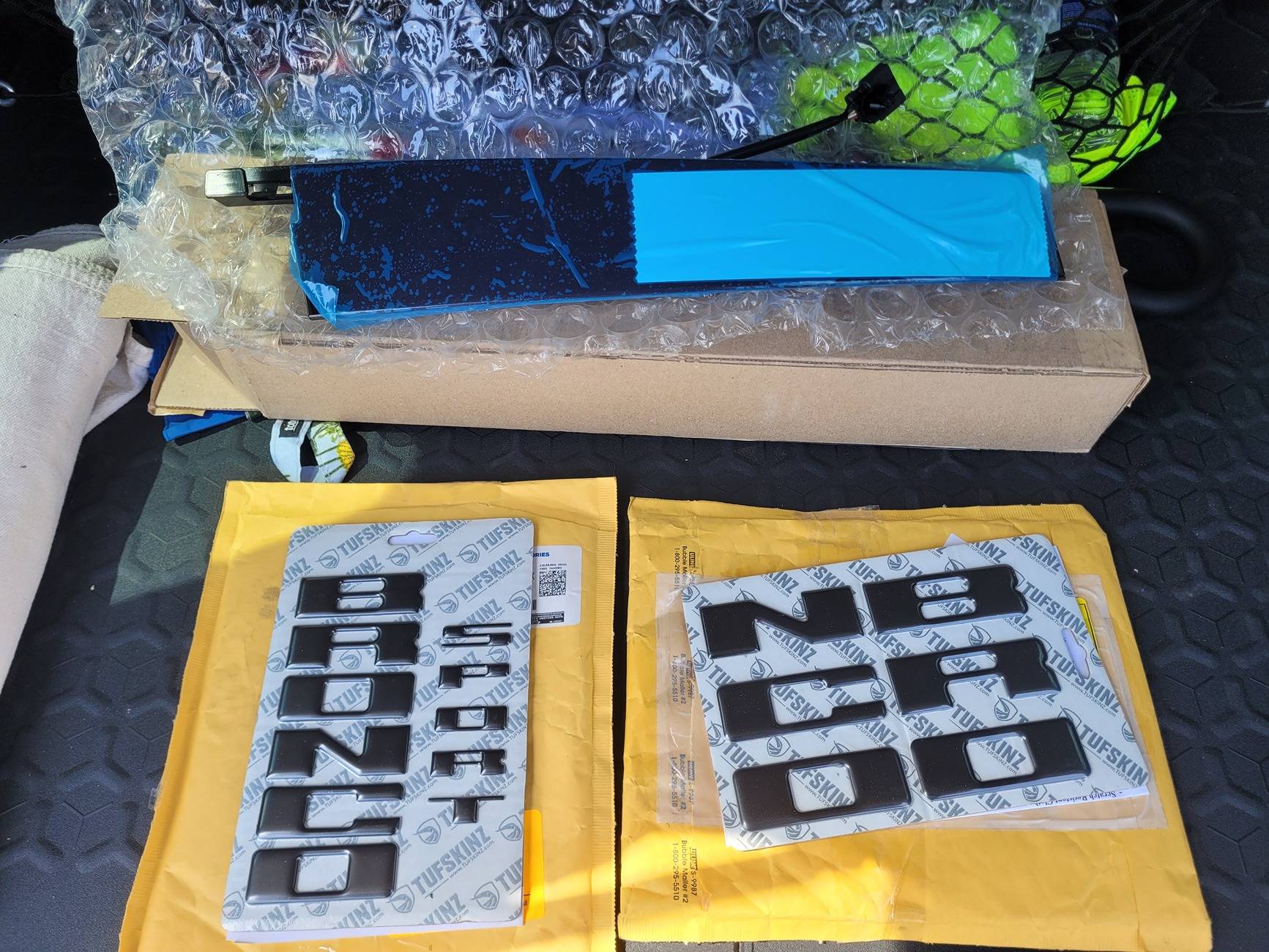

Nicely packaged and I thought this was a cool way to send the stickers also. Almost threw one away I thought it was just a tag for the packaging itself. They also include some blue thread locker and a treat for when you finish.
Ford Bronco Sport Quashish Family Ride Thread : 2024 Badlands 20250208_100920
You only need a small flat pry tool, a 15mm socket, and a T55 plus if you have it. A regular T55 will work. I don't like the mess so I again used some loctite stick formula.
Ford Bronco Sport Quashish Family Ride Thread : 2024 Badlands 20250208_154654

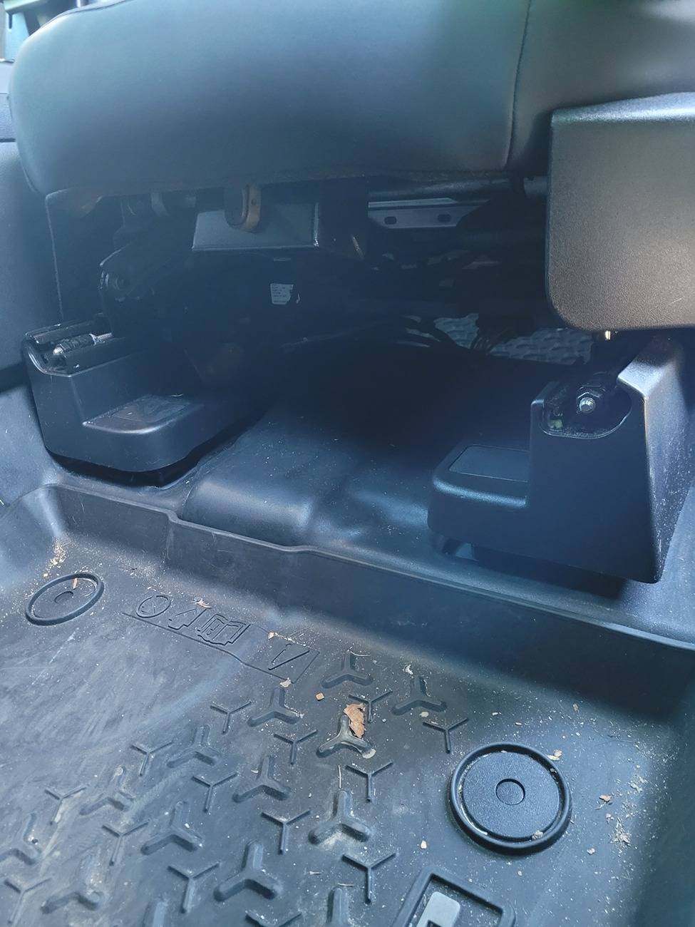

Completely removed the front bolts and loosened the rear to lift the seats and put the plates under the front. Tightened front then rear and put the covers back on.
Ford Bronco Sport Quashish Family Ride Thread : 2024 Badlands 20250208_154155
Quality test
Ford Bronco Sport Quashish Family Ride Thread : 2024 Badlands 20250208_155903
Of course it will raise the plastic trim pieces with the seat. But that will just make it easier to clean right?
Ford Bronco Sport Quashish Family Ride Thread : 2024 Badlands 20250208_155844
This is the angle the seats should have come. So much better.
Update: factory bolts are M10 x 1.5 with 1-3/16" of thread showing.
So you could get 4 slightly longer bolts and some square washers way cheaper.

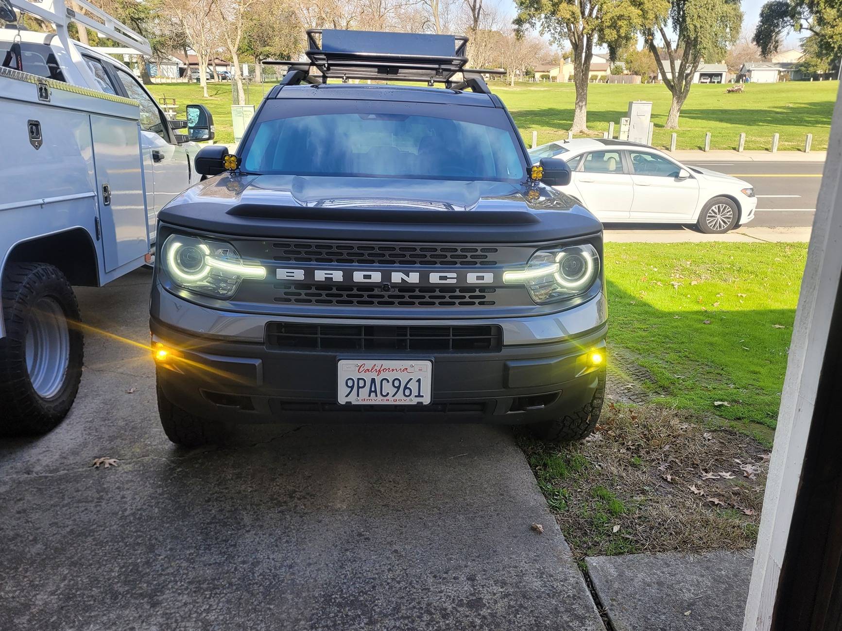

Quick color Change
Ford Bronco Sport Quashish Family Ride Thread : 2024 Badlands IMG_20250212_103414
Ford Bronco Sport Quashish Family Ride Thread : 2024 Badlands IMG_20250212_103606
Ford Bronco Sport Quashish Family Ride Thread : 2024 Badlands IMG_20250212_103848
That's the golden color I going for initially. Can't wait to see them at night.

No changed the actual lenses from the baja "amber" to factory amber. The ditch lights still have the baja "amber" for lens color reference
