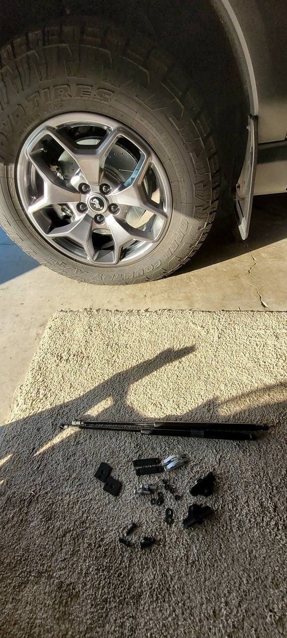

Finished with those in just over an hour. While the wheels were off gave them a good cleaning.
Ford Bronco Sport Quashish Family Ride Thread : 2024 Badlands 20250621_185010
Hood struts with no instructions is next
Edit: found some. These are discontinued but just in case here's the info for RIVAL 4x4 hood struts
Ford Bronco Sport Quashish Family Ride Thread : 2024 Badlands Screenshot_20250621_190544_Driv
Thanks I screen shot that to save for future

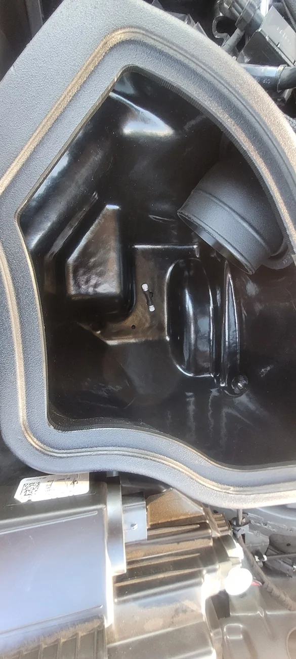

Ford Bronco Sport Quashish Family Ride Thread : 2024 Badlands 20250809_112312
Over night parts from Colorado lol
Ordered back in June I think? Backordered and finally got shipped out to my family who forwarded package to me. install commencing

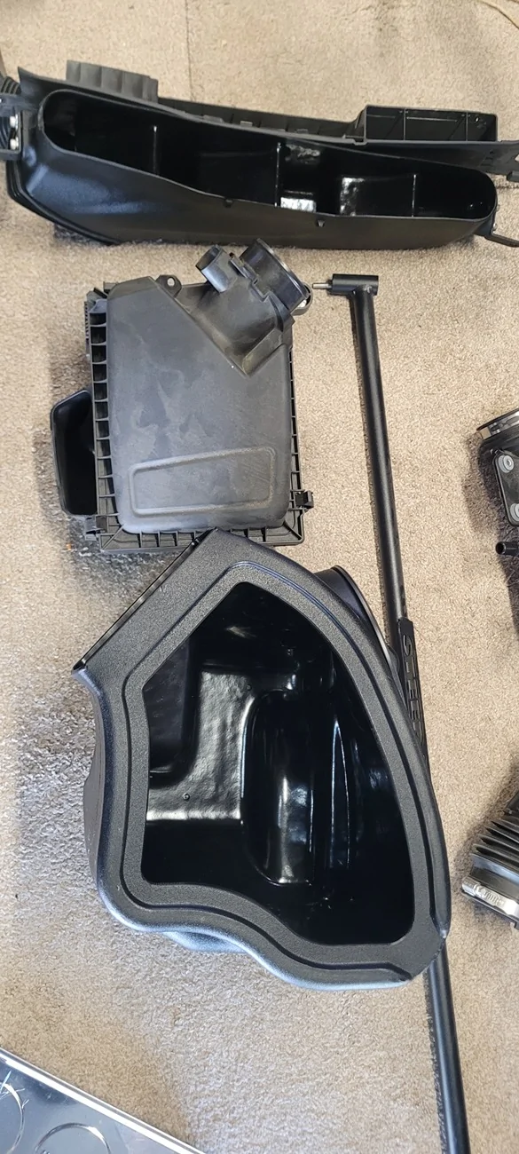

Ford Bronco Sport Quashish Family Ride Thread : 2024 Badlands 20250809_141544
Install complete. Not a bad install, ford's hose end clips are the worst. Also had to find the spacers for the steeda strut bar to clear the new tube. This thing is huge.

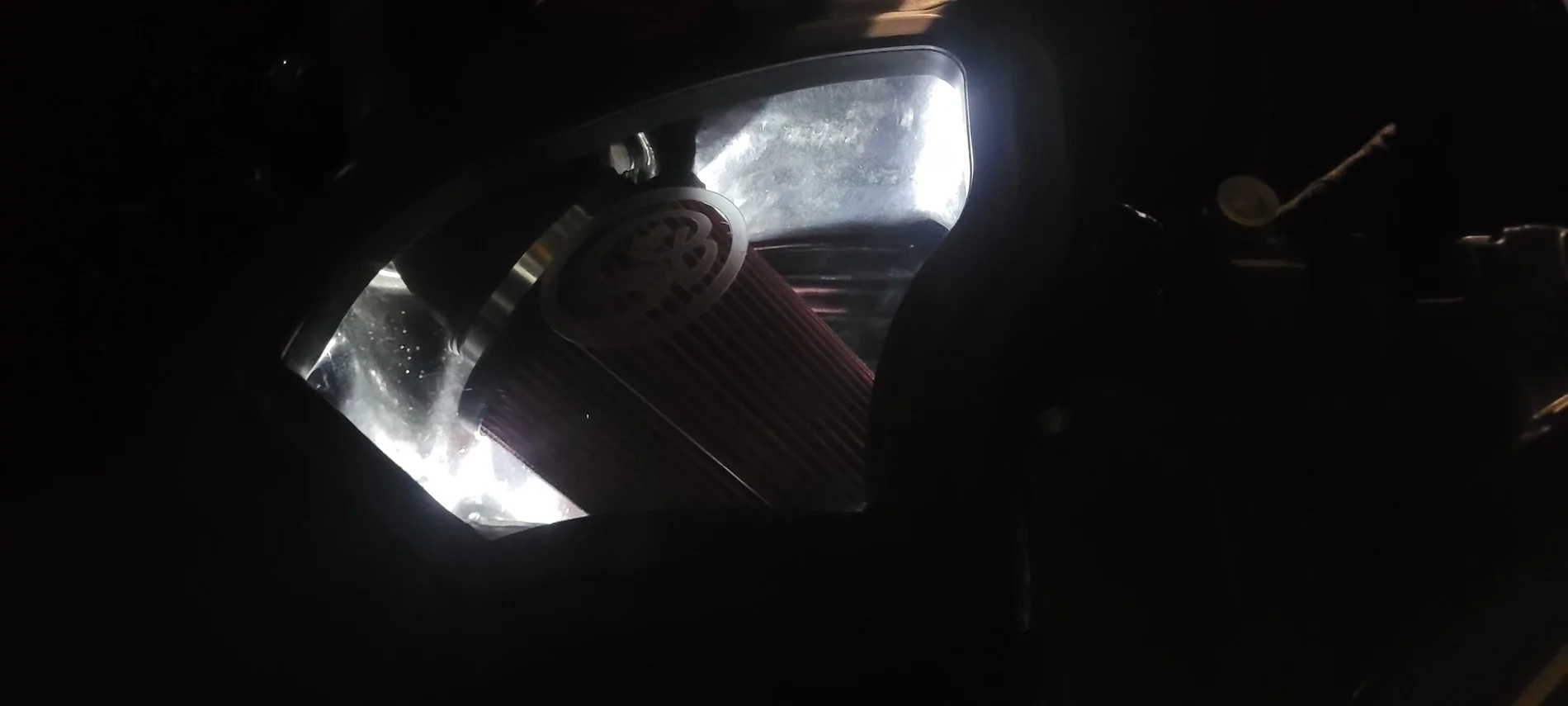

Made up this set up with two 194 morimoto leds I had lying around. Dressed it up with black expandable sleeving to cover the wires. Bullet connecting ends under the air box to the rest of the wiring going through firewall and across to all my acessory power connections on the passenger side.
Ford Bronco Sport Quashish Family Ride Thread : 2024 Badlands 20250810_085841
Ford Bronco Sport Quashish Family Ride Thread : 2024 Badlands 20250810_095859
Ford Bronco Sport Quashish Family Ride Thread : 2024 Badlands 20250810_101625
Ford Bronco Sport Quashish Family Ride Thread : 2024 Badlands 20250810_102332
Will get a picture once it's dark

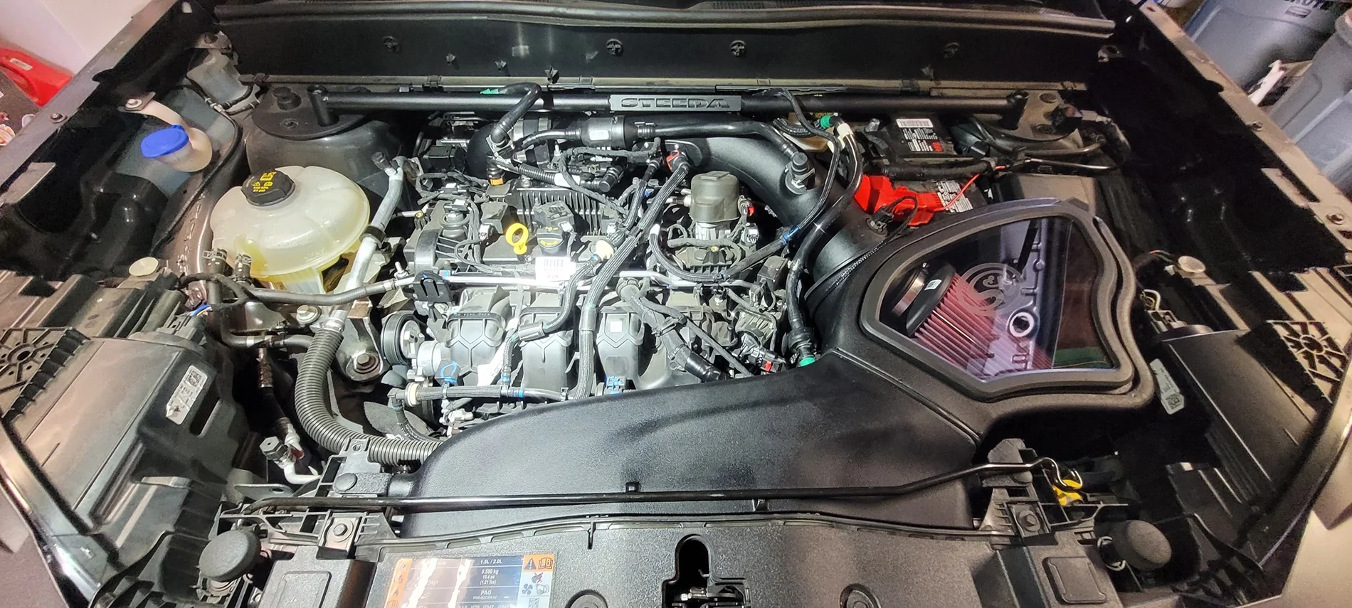

no new updates. Just been busy driving it and trying to keep it clean. After installing the S&B air box MPG raised back up now getting an average of around 22 -23.
still want to get some accent lighting for the engine bay. I always have a flashlight charged and ready at the bottom of the center console, but some built in lighting might be nice.

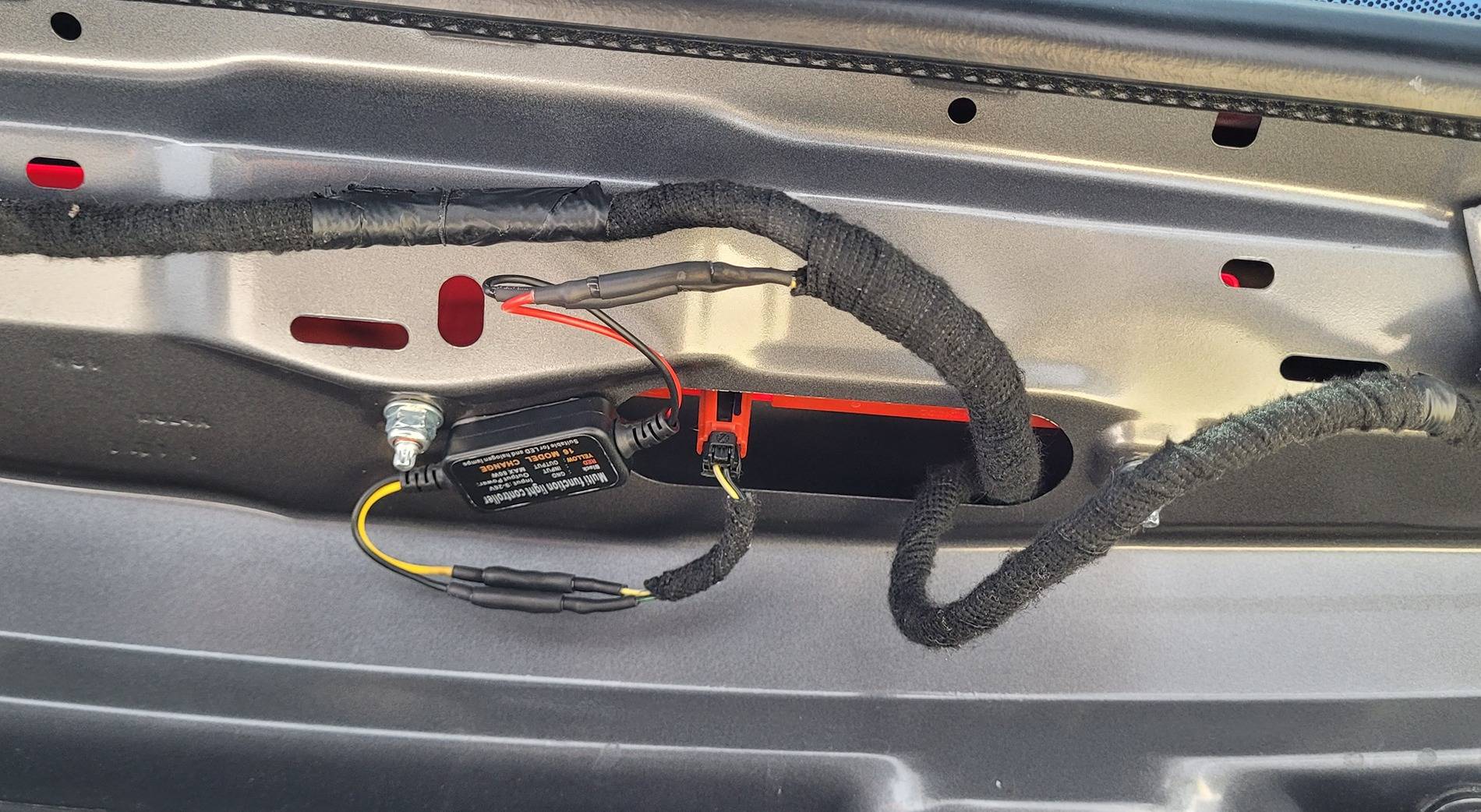

@Dude "emergency brake lamp" was just something i enabled but not sure if it works yet. have not tested it, but i was hoping it would be like what some European spec cars have where if you brake hard enough usually at a higher speed it flashes you hazard lights automatically.
the 3rd brake lamp flasher is an inline power module that has selectable patterns based on dip switch positions. i set ours so when you apply the brakes the 3rd brake lamp flashes twice quickly followed by four 1 second flashes then stays solid
Ford Bronco Sport Quashish Family Ride Thread : 2024 Badlands 55207-6f29ef40d85fce22958a3e023c9381d3
i have i think 4 more. and was going to put one on my car but decided i don't need more attention than i already have. in case a cop wants to be picky. technically CA law states any more than 4 flashes in the first 4 seconds is illegal.
