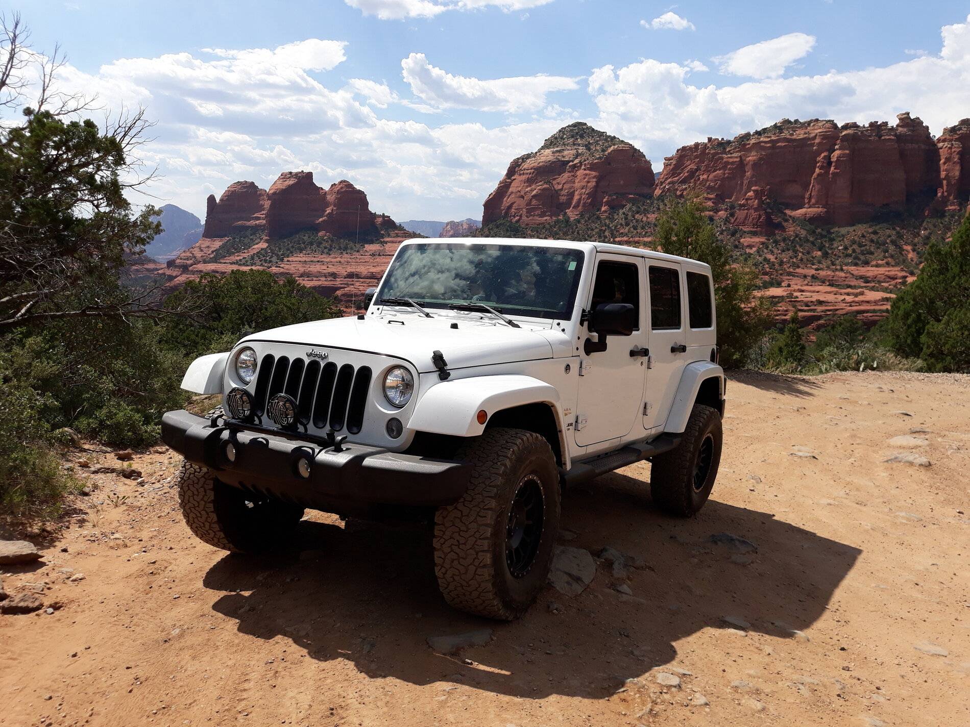

My fiance was driving. I was working. She said she moved over to the side to avoid the water and got stuck in mud. As she struggled back and forth to get out of the mud the car slipped sideways toward the water until it was in about 15 inches of water. It was a rural dirt road.
this is what she was driving when I first met her.
