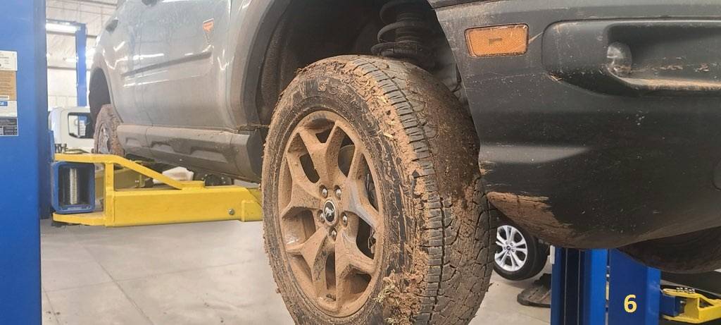

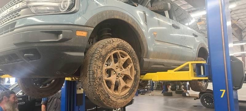

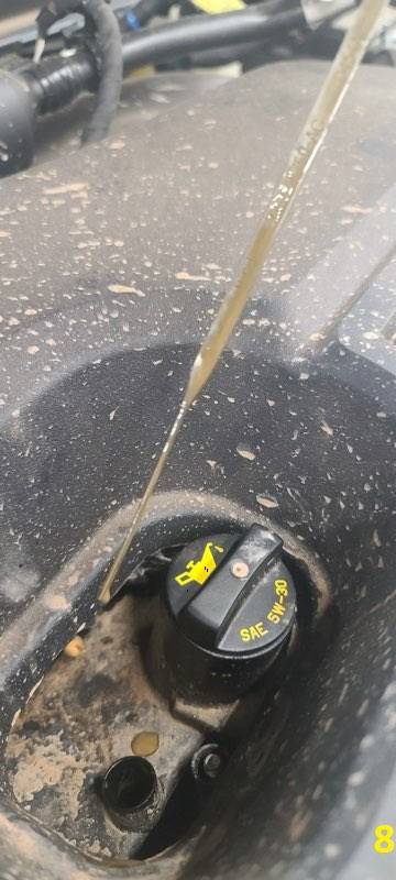

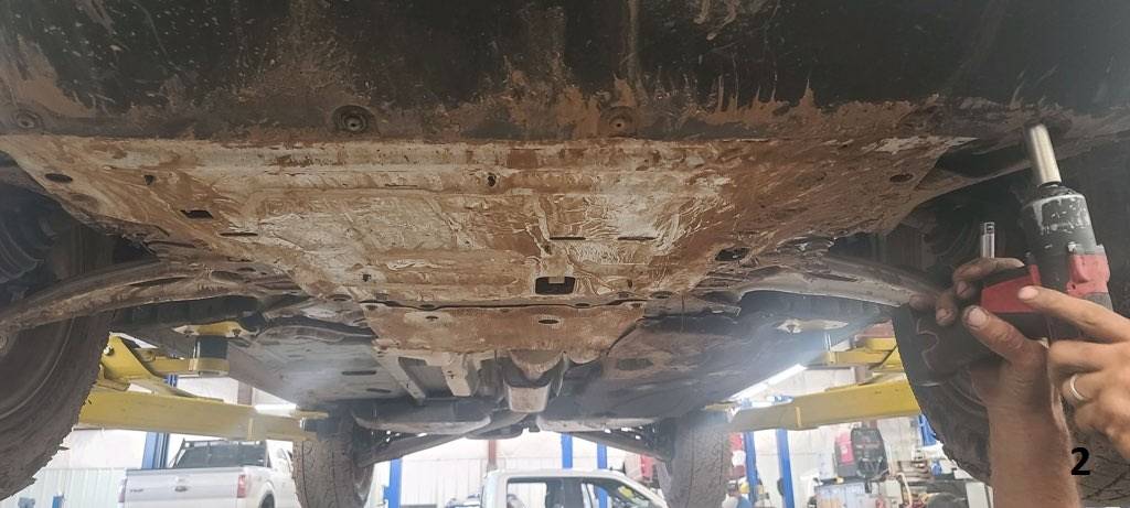

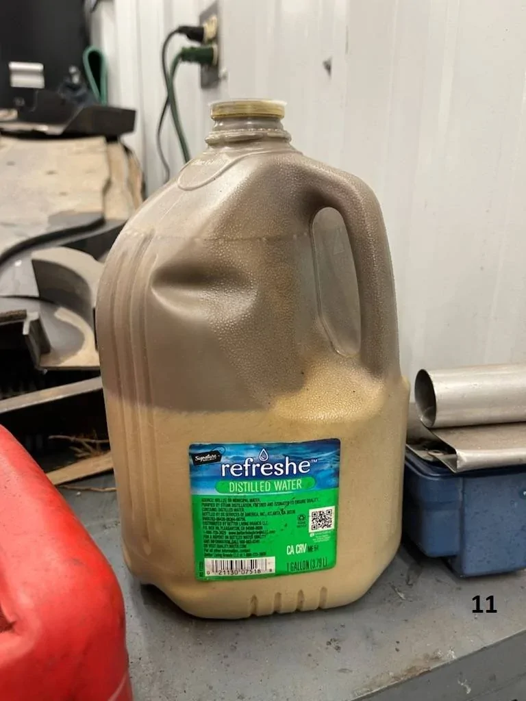

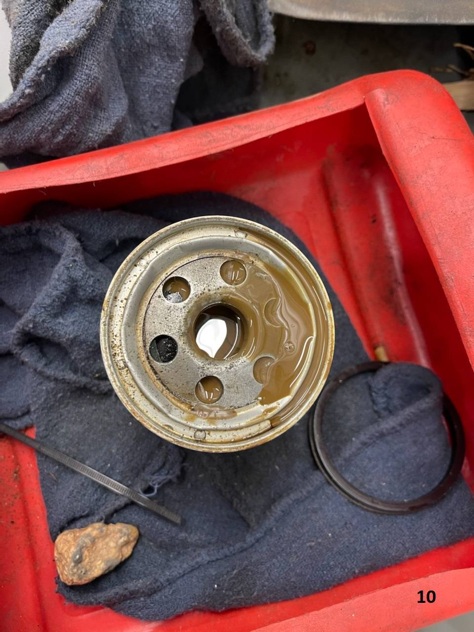

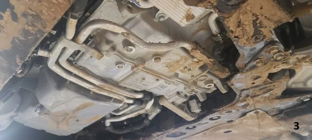

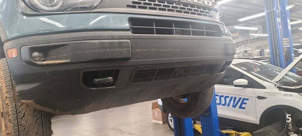

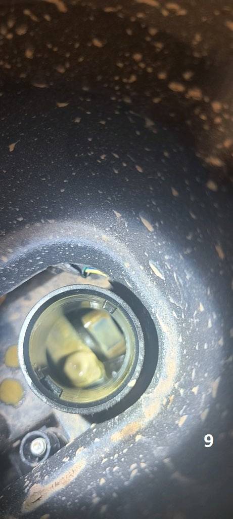

Here's all the photo's the dealer sent me. I appreciate everyone's help. To summarize; my fiancé was driving on a dirt road in AZ and came up to this area of water. She attempted to go around it but got stuck in mud. The photos tell the story...lots of mud. She wasn't able to get traction, the left side wheels were on more solid ground, the right side very slippery clay-based mud and water, she eventually slid down into the water. The air filter was completely clean and dry. The tow truck operator checked the oil and saw it was filled with water. We had it towed it to the dealership. It sat for more than a week with the muddy water in the engine before it was looked at. The insurance company was supposed to look at the car today for the first time, more than three weeks after it happened... this is strange considering one of their "claim response Vehicles" is visible in one of the photos. Please let me know if you see anything in the photos that might explain what happened. The Bronco Sport is supposed to be able to wade in 23.6 inches of water.

I've seen that happen with vehicles that were caught in a flood, muddy water finds it's way inside of the engine. Obviously the time it sat to when the dealer actually started looking at it makes it even worse, someone needs to check everything. Crazy sad situation.

The look of that mud spray appears that she was going faster than 4 mph.
Read back he said she was going around and slid sideways into hole. Spinning tires can sling mud everywhere especially when turned.
