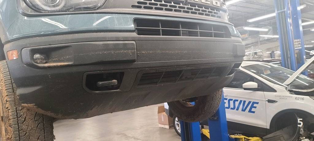

Two options are being considered. Engine replacement or totaled.
UPDATED with photo and questions/answers:

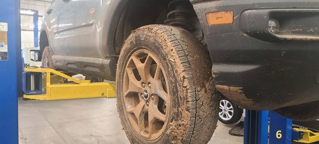

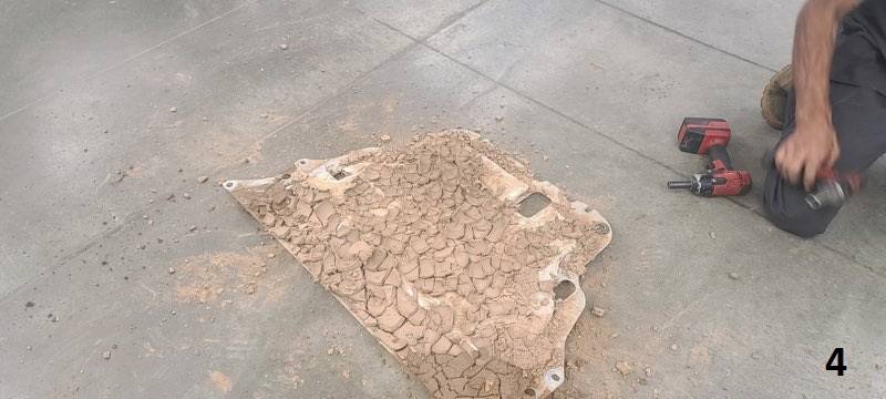

Ford Bronco Sport Our Bronco Sport either needs engine replacement or may be total loss...and the water barely reached the front bumper. For Parts, For Scrap, For Sale? 20210731_122535
If the engine is lost, it sounds like water got into it. Bad seal?
I've always wondered, what happens when the exhaust system gets submerged?
Don't think the engine would be a loss if it was just that computer module that is placed in the wheel well like the one guy on here had to deal with.
From what I understand if the engine is on the exhaust system has enough pressure that water won’t go thru it.
I have a big bend and I went thru roads flooded 12 + inches no problem ( big bend limit in 17” water crossing)

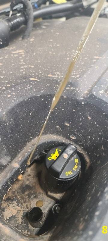

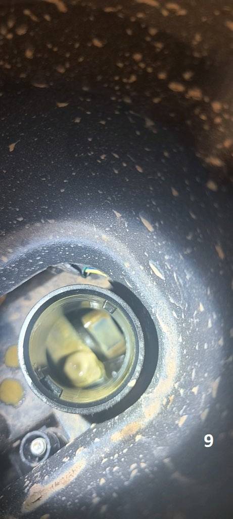

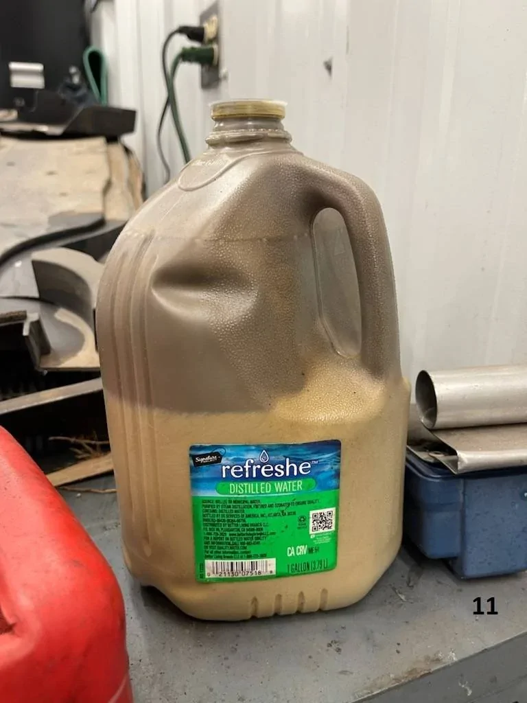

Still to early to tell what the outcome will be. The tow truck operator checked the oil and showed me it was mixed with muddy water. The air filter was completely clean. Towed it to the dealership.

a new engine should cost $4-5k on average. Your vehicle is worth $36-38k. I don’t know why anyone would say it might be totaled .
That creek looks under the 23” fording limit of the vehicle. Make em do it under warranty if they refuse you have can sue em for false marketing ( as a Ford stock holder I hope they just fix under warranty as opposed to paying the cost of fighting you in court )

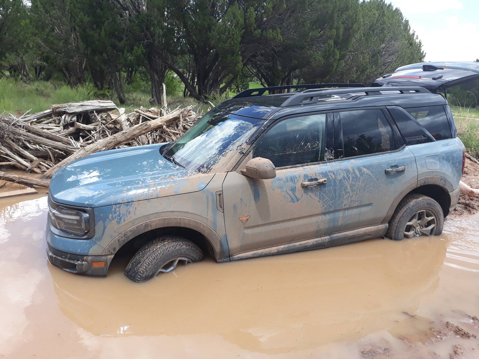

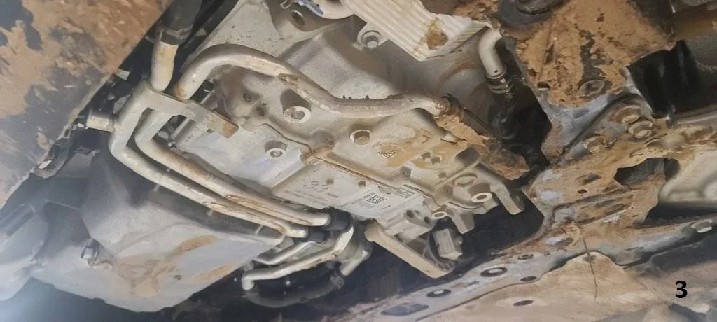

Interesting, how fast were you going entering the water ?
Did the Engine stall when you hit the water ?
Clean Filter may just mean water got sucked in down stream of the Filter . With the Engine running , exhaust pressure , even with a Turbo , will keep the Exhaust clear . Makes you wonder what else could be compromised to allow water in to the Oil system .

How much off roading were you doing before you got to that water?
Wondering if something could have hit the oil pan, and the water got in that way.

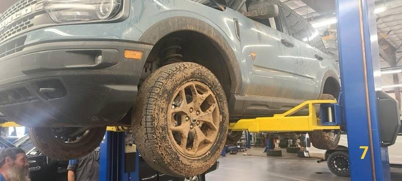

Seeing how far mud splashed up the A post I'd sure like to see an under hood photo
2,730
4,455
Yeah mentioning it barely reached the bumper....that A-post tells a different story all together. Granted I still think this sucks and should manage that kind of off roading based on what they advertise but hoo doggy...that's a mess.
