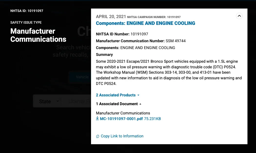

My bad on the verbiage, these engines seem to have an issue throwing low oil pressure lights and a P0524 code, which is exactly what mine would do at around 5000 RPM and then it would throw itself into limp mode. Ford checked the sensor and the associated wiring, all good. When the tech checked the pump, they found the pump had a lot of resistance so they replaced it. All is good now, I hit redline yesterday with no hiccups, but there will be future issues with these engines with that wet belt system driving the oil pump. There is no reason for an oil pump to be bad at 36k, it is just crappy Ford quality.
Ford Bronco Sport Need Forums Advice 1.5 vs 2.0 Screenshot 2025-09-01 at 8.47.28 PM
How do they replace the oil pump without tearing the engine down?
The oil pump is actually super simple to replace, just remove the oil pan and the belt cover and the pump is fully exposed. Sounds like the oil pump belt replacement is a whole other story.
