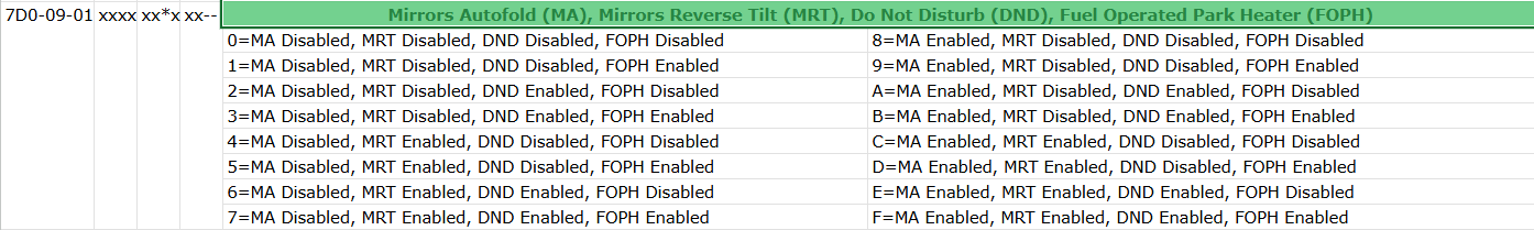

Well, when we were trying to enable the power fold mirrors, I never looked into the reverse tilt function in particular. Step one would be to enable it here in the APIM. My car shows a 2 there, so MRT is disabled.
Ford Bronco Sport Mirrors + tilt down + reverse 1760719151513-35
The difficult part will be where to find changes the needed to be made to the door modules (or maybe BCM?) to get it to work.
The difficult part will be where to find changes need to be made to the door modules (or maybe BCM?) to get it to work.
Yeah, tried this combination before...I will ask a guy that recently joined the Bronco BR WhatsApp group and he's family own a Ford dealership if he can check this info or if is possible to do the MRT

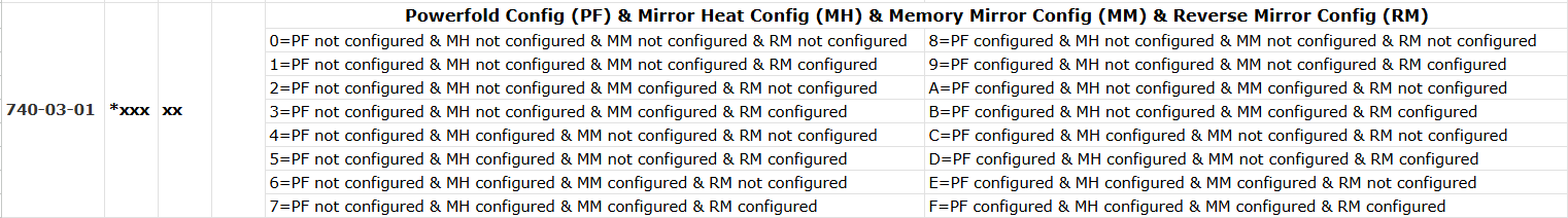

Ok, I found something in the FORScan spreadsheet for 2015-2020 F150's. First, for MRT to work, it must have memory mirrors:
Ford Bronco Sport Mirrors + tilt down + reverse 1760722985109-wt
Since my truck has a 2 there, then MM is enabled. So it would be a matter of changing that 0 to a 3 in both door modules, and enabling MRT in the APIM and then give it a try.
There is a possiblity the reverse tilt mirrors will need to be calibrated after they are enabled. That procedure is outlined here:
https://www.f150forum.com/f118/forscan-software-enable-disable-features-your-truck-348987/index392/?utm_source=share-link&utm_medium=button&utm_campaign=share&utm_content=post#post5071672
If nobody beats me to it, I will be the guinea pig later tonight when I get home.
Edit: My truck has a 0 there; not a two. This means MM is not enabled. This is my girl's car, so I am not sure if it has memory mirrors functions or not, or if it can be enabled. I will play with it tonight and report back.
Ok, we may be back to square one here, because I just made my girl walk out to the car to test if memory mirrors work and they do work, but according to what my truck shows in that location and above, MM should be disabled. So, the F150 is not a direct match in config.
