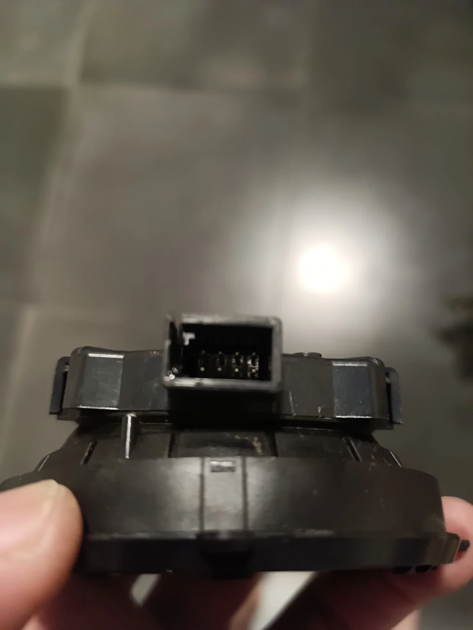

The 2025 model has mirrors with memory. I think it could be done in the new model! What Fodscan configuration needs to be changed?

After adding the same thing to the IPC, it works!
Now I just need to activate the automatic folding. (difficult but not impossible).
