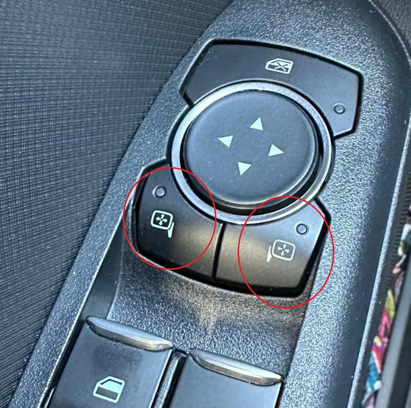

without changing the driver side window switches as well?
If it works as mentioned in the link above, it won't require different hardware. You just have to manually push one of these two before (or after) you shift into reverse and it will tilt that mirror down and back up when you shift into park. I'll be home in a few hours and try it. The more I think about it, I kinda like it to work this way instead of tilting automatically. Depending on the situation, auto reverse tilt mirrors can be an inconvenience more than they help.

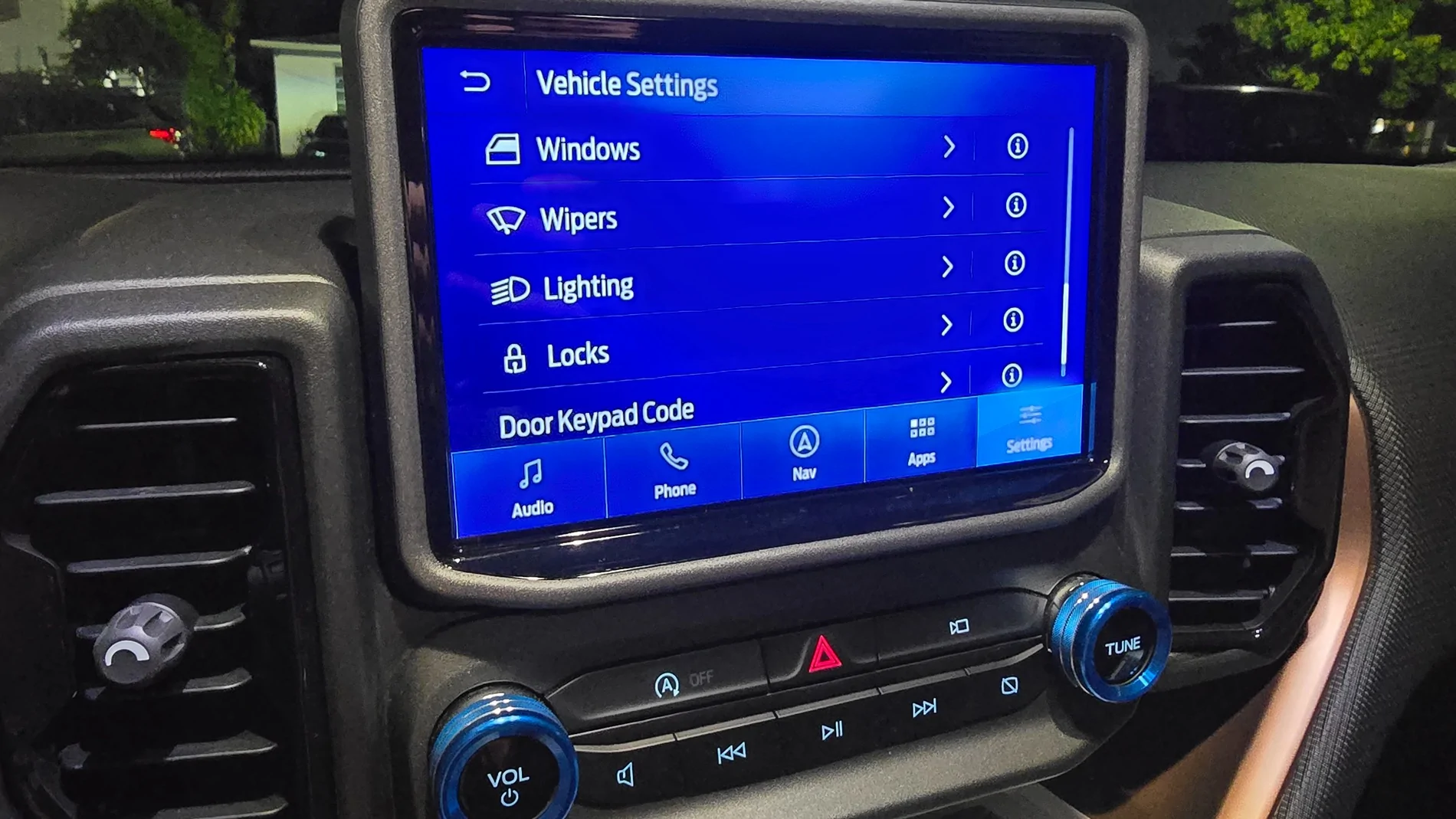

Can anyone with a 21-24 confirm there are no mirrors options in the touchscreen settings? If there aren't, I don't see how this will work.
Ford Bronco Sport Mirrors + tilt down + reverse 17607501550597745476378642980947
Quashish
Tomas
Jun 2, 2024
1,273
1,811
Sacramento
2024 Bronco Sport Badlands
I seen the video with the gross eletric mach-e but figured it already has memory seats and mirror features available. This car has to be missing a module or two compared to that battery on wheels.
And it's a negative for me. My menu looks the same a yours. And it used to not have the door keypad, I had to add that when I installed mine.
Yes, I can see both options - tilt down and mirror fold. Rememberer we talked about that 1:1?

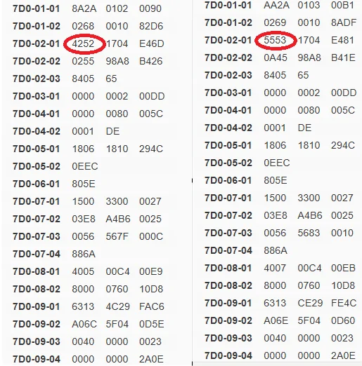

@hefler and anyone else still following:
Below is what Ford shows online for your truck and mine. Yours is on the left side. I compared every difference using the 2023 Explorer APIM which has the exact same amount of lines of code and seems to be identical. I don't see anything. The only think I can think of is what I circled below. 4252 is the country code for Brazil and 5553 is for the US. Maybe if I change the country to code to yours, it may open up some features that are not enabled with the US market programming?
I will try it out tonight and report back.
I don't think because 7D0-02-01 cross 9 different sector but no-one cover more than temperature stuffs, heating...
but please, try and post the results.
Tbh, I don't think it will work either, but there is nothing else I saw that would make sense to try.
