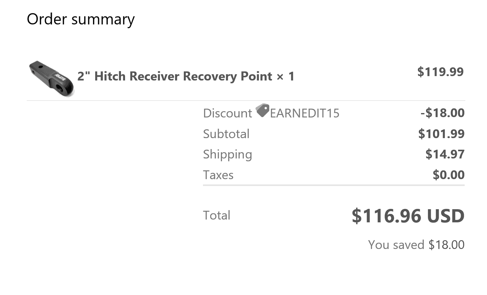

Closing this out.
To answer @CableXJ question. $116.96
That's the cost of my peace of mind, as a novice off roader.
Ford Bronco Sport How Strong of a Receiver Shackle Mount? 1693572109587
Ended up getting the Yankum piece. They are back ordered. I will update the thread when I get it in about a month or so. I didn't want to spend that much at first. But this thread really opened my eyes to the possibilities of aluminum over steel. I really had thought that steel was a no-brainer.
I appreciate everyone on here that threw in some input. It all helped.

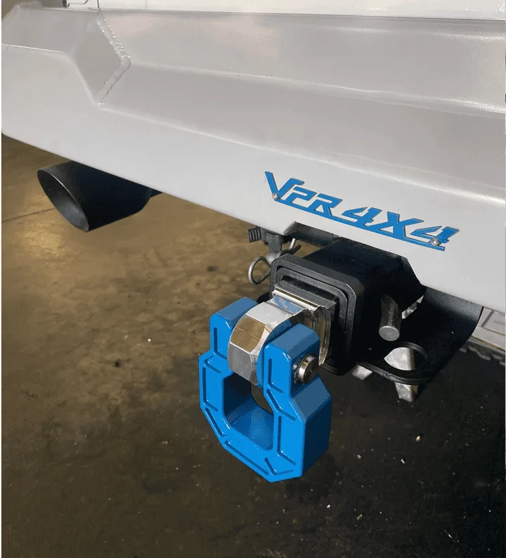

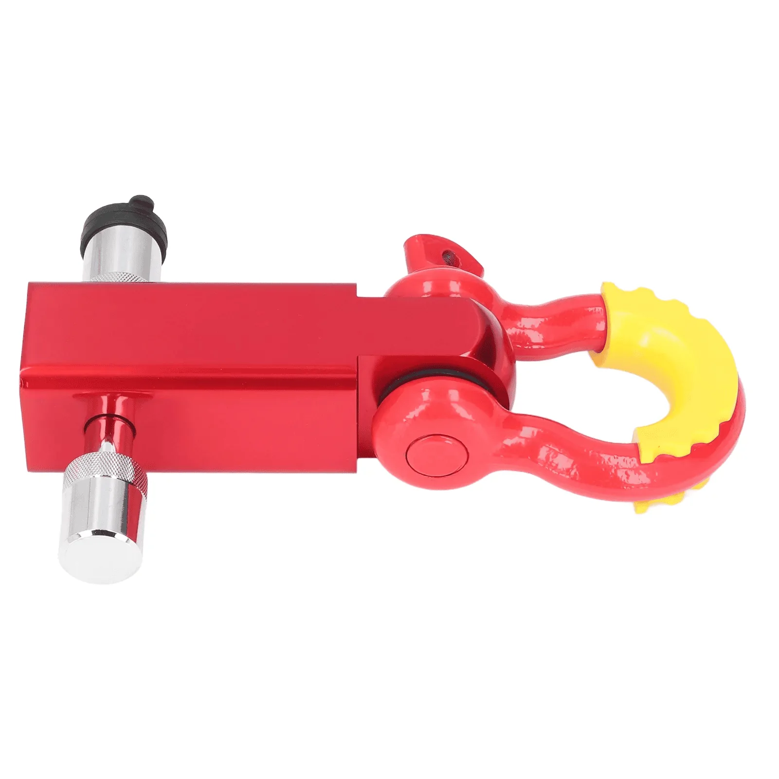

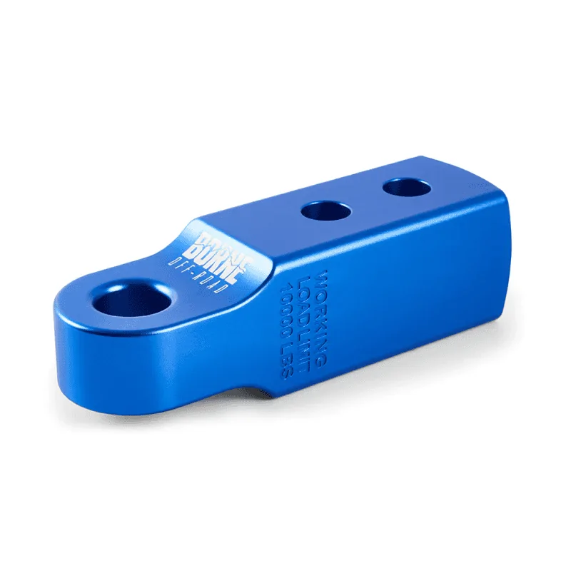

Some come in pretty colors:
Ford Bronco Sport How Strong of a Receiver Shackle Mount? 1693596587331
Others are shiny and X-treme:
Ford Bronco Sport How Strong of a Receiver Shackle Mount? 1693596790944
Some look like kids' toys. Bam-bam!:
Ford Bronco Sport How Strong of a Receiver Shackle Mount? 1693596974772
Others are like modern art:
Ford Bronco Sport How Strong of a Receiver Shackle Mount? 1693597335595
At the end of the day, the main concern is the strength of the hitch.
Another is having 2 offset holes for the hitch pin, 90 degrees apart -- unlike the units shown above.
PS: I just grabbed those photos off of Goggle Images. I know nothing about them. If anyone here owns one of them the fact that it's shown here is just a coincidence.
