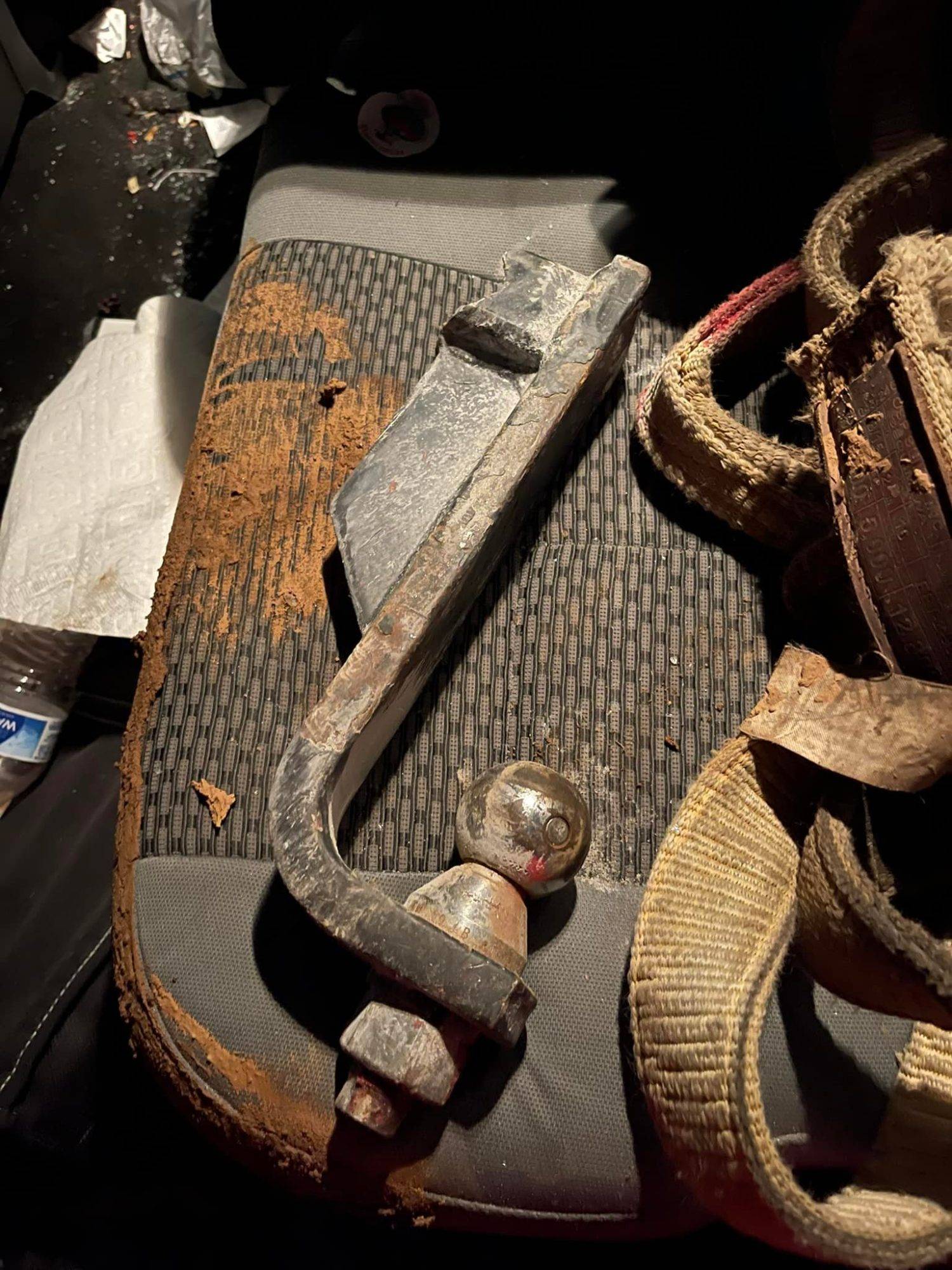

Then....I started digging around into "proper recovery gear" and came across this story about this poor guy in Arizona.
Father Killed In ORV Recovery Accident When Tow Hitch Snapped (roadandtrack.com)
His SuperDuty with rear locker got bogged down up to his nips. He called his buddy who came out with INADEQUATE recovery equipment for this job. They ended up shearing the receiver. Now, granted, the receiver was NOT a shackle mount receiver, but a tow ball receiver. This is not intended for a recovery. Especially one like this. But its given me room for pause. Maybe spending a little extra money might be worth some peace of mind?

I did read your OP; it wasn't just a tow ball receiver, it was a drop hitch receiver. The leverage placed on the joint between the down tube and the receiver tube when used in that fashion is the primary reason it failed. A shackle mount has no down tube, therefore cannot generate the kind of leverage that caused this failure. In other words, the failure mode that caused the death in this accident is not possible with a shackle mount.
