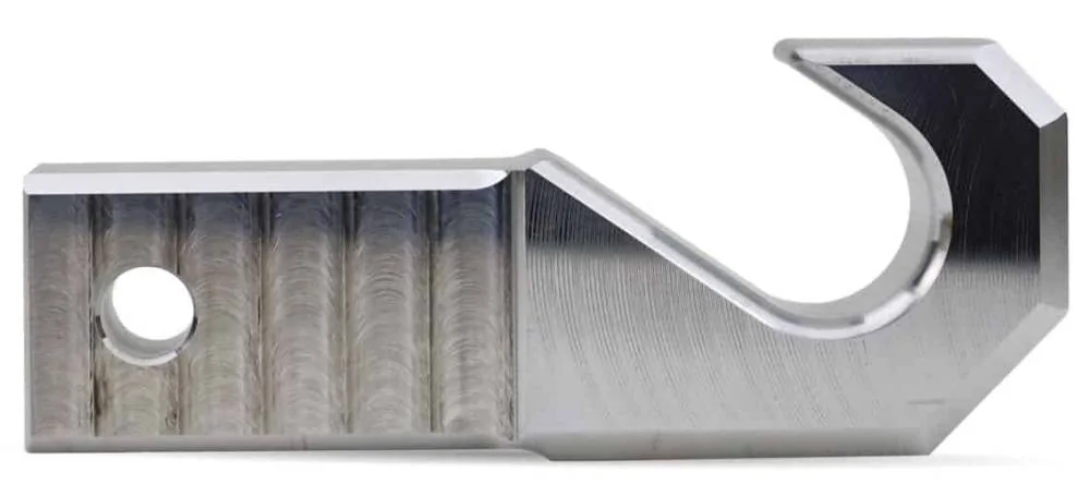

But I'm not really talking about a tow situation. This is a thread specifically about recovery.
In a recovery situation, isn't it possible (while not necessarily advisable) to exceed the manufacturer's GVWR on the tow point? If you're in a dire situation, and your wheels are halfway into some thick mud, you might not be able to accurately calculate how much force its going to take to get you out. Isn't it better to be safe than sorry with a stronger piece? Or do you feel confident enought to know when a recovery might be too much for your setup and you need to call for help?
The aluminum recovery points rated to 9500 lbs are giving working load, so recovering a vehicle that weight. So you’re doubling the safety factor. In the case of the Factor 55 Hitchlink with an MBS of 51,000lbs, taking it over 10:1. There aren’t any big concerns with cycling loading or abrasion, so I I don’t see any advantage to steel.

So I'll ask you guys. My basic question is, how SAFE should I play it and opt for a stainless steel receiver shackle mount (maybe even finding one that accepts a 7/8 shackle pinhole) over just a normal aluminum receiver with a 3/4 inch shackle pin hole.
The latter is about twice the price of the former (often more).
That person made a lot of bad decisions on attempting that recovery: Using static straps and chains for a "jerk" kinetic recovery attempt, and not opening the hood on the stuck vehicle to act as temporary safety blocker in case of chain, strap or hitch/receiver failures.
There are 2 metrics usually quoted for Tow Points: WLL and WBS. Working Load Limit and Working Breaking Strength. The WBS is effectively the UTS (Ultimate Tensile Strength) of the material multiplied by the cross sectional area at the thinnest cross-section of the device. Neither of these metrics account for the toughness of the material (Impact strength) which is important in a kinetic recovery.

The Q&A section on that link says that the WLL is 4-3/4 tons: 9500 pounds.
In comparison, the 6061 aluminum Yankum Toe Point has a WLL of 13,500 pounds.
MBS 66,400 lbs
It weighs something over 2 pounds.
It's a lot more money though. A LOT!
When I finally do get my BS BL, I'll be buying the Yankum. I don't intend to do any recoveries, but just to have to have it in the car to save my own butt should I get stuck in icy/snowy conditions.
I like that Yankum also posts warnings on their website:
  • Pin can sheer before tow point failure. Only use quality hitch pins
  • Pull IN LINE with hitch. DO NOT side pull (may damage shackle, receiver, or tip over vehicle)
  • DO NOT exceed posted ratings
Disclaimer: I'm not an employee, of Yankum nor do I have any association with Yankum.
And I'm not even a customer, yet.
Food for thought. When It comes to safety, money is not a major consideration for me.
MBS 66,400 lbs

I actually have been considering the Yankum.....didn't want to get laughed at my posting it and everyone seeing the price....so I've just been keeping it in my back pocked. lol
But if you're gonna out, then I'll out. lol
Its actually what kinda got me started on this whole aluminum vs steel.
So let me ask you, you'd feel safer with that pieceof Yankum aluminum, then that Quadratec piece of steel? I do appreciate the fact that I can take solace that the Yankum piece was designed and fab'd in the USA. And I also like the way they tout the design on the webpage. Most products don't offer up that kind of information.
Another aluminum piece I've been looking at is the Moose Knuckle.
But I'm really wanting to fit the WARN 7/8 D ring, and the Moose Knuckle doesn't offer that.
Im not paying the premium on the Factor55 pieces (I don't like the fact that everyone says its made in China, while they stamp it 'MADE IN THE USA), and have never trusted Mishimoto

Yes, I'd have full faith in the Yankum aluminum tow point. These folks are experts in vehicle recovery and recovery equipment. I'm not so sure that these other tow points have even been tested to failure to produce the quoted WLL and WBS numbers.
The lighter weight is an advantage in storage and convenience.
One question which I don't have an answer for is: what is the yield stress on the car? That is the stress which would do permanent deformation to the unibody.
Or what about the strength of the hitch pin? Or the hitch itself?
The Moose Knuckle Mohawk 2.0 Receiver appears to be nearly equivalent to the Yankum Toe Point.
The Moose Knuckle has 10,000 pounds WLL rating on the receiver as well as their jowl split shackle.
And pricewise, one can get the shackle and the toe point for the price of the Yankum Tow Point alone.
