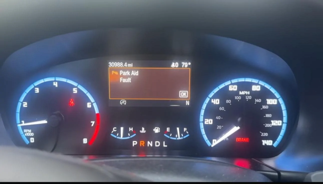

Guys! I F up ? idk what exactly and where I made a change in forscan but now I have a notification on my dash that says “Park Aid foult” if someone can tell me where in all the settings should I enter and see if I can fix this I will be really appreciated!
Ford Bronco Sport Bronco ForScan Thread IMG_8610
You have your backup that you before making any changes right? The instructions state to make a backup then you can restore the backup. (https://docs.google.com/document/d/1-8dKaS_Spu4Zw4hV_CrKC4tLoP9G8yejqegF1wxIqxY/mobilebasic)
If you didn’t make a backup then I think you can locate the “as-built” for your vehicle and restore from that. The instructions tell you how to get the as-built. But you should find out exactly how to do that restore so there’s no chance of bricking your vehicle. (Look for “Restoring a module to original as-built values” on the link above)
