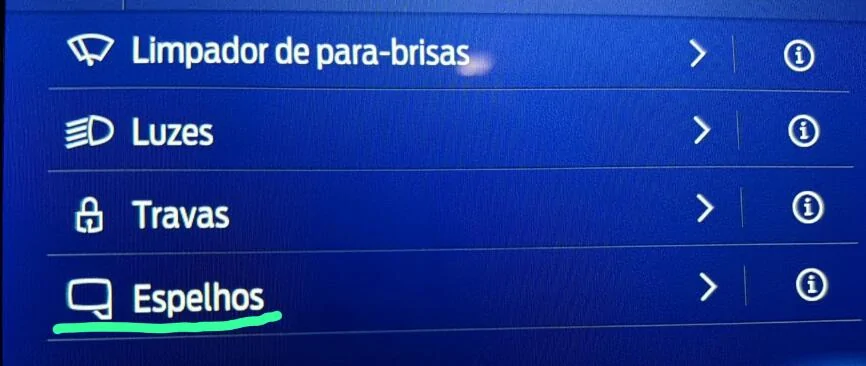

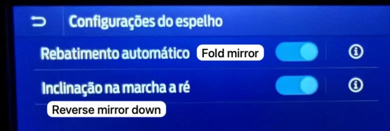

I have photos showing that is activate but is in portuguese.
Ford Bronco Sport Bronco ForScan Thread Screenshot 2025-08-11 at 10.26.41
Ford Bronco Sport Bronco ForScan Thread Screenshot 2025-08-11 at 10.28.35

@hefler might have to look in other folders and enable there also if listed.
do your side mirrors have the signals built in on the outside as well?
Yes, it does have.
I checked the APIM as build it and the APIM normal module

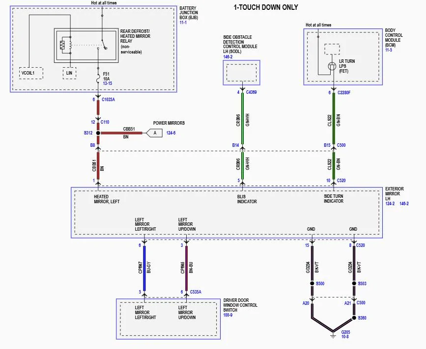

In PTS, when I pull the wiring schematics for my 2023 BS, I get two possibilities for the the way the mirrors are wired: One for vehicles that have one touch up and down that DOES include wiring for the mirrors to fold in and out:
Ford Bronco Sport Bronco ForScan Thread U&D
And another for vehicles with one touch down only that do NOT show anything in terms of wiring that will support power-fold mirrors:
Ford Bronco Sport Bronco ForScan Thread Down only
I am not sure if ours is one touch down only or if it does both up and down; my girl is going to check later when she gets off of work since it's her truck. However, assuming the the hardware is there for power fold mirrors to work, it would also need to be enabled with FORScan in the PDM and DDM for it to work.

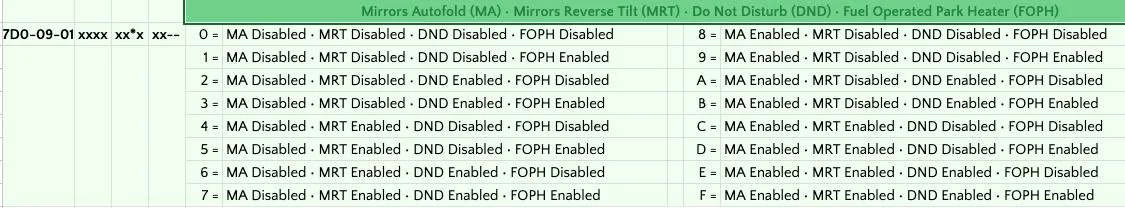

Looking through the FORScan spreadsheet for the Maverick, it seems like the door modules are the same as the 2023 BS, I see this in there that looks interesting:
Ford Bronco Sport Bronco ForScan Thread 1754941590418-y
My BS shows a 0 there for disabled in the DDM and PDM.
Ford Bronco Sport Bronco ForScan Thread 1754941619681-8a
Ford Bronco Sport Bronco ForScan Thread 1754941790276-af
You can try changing that value to a one to see if it works.

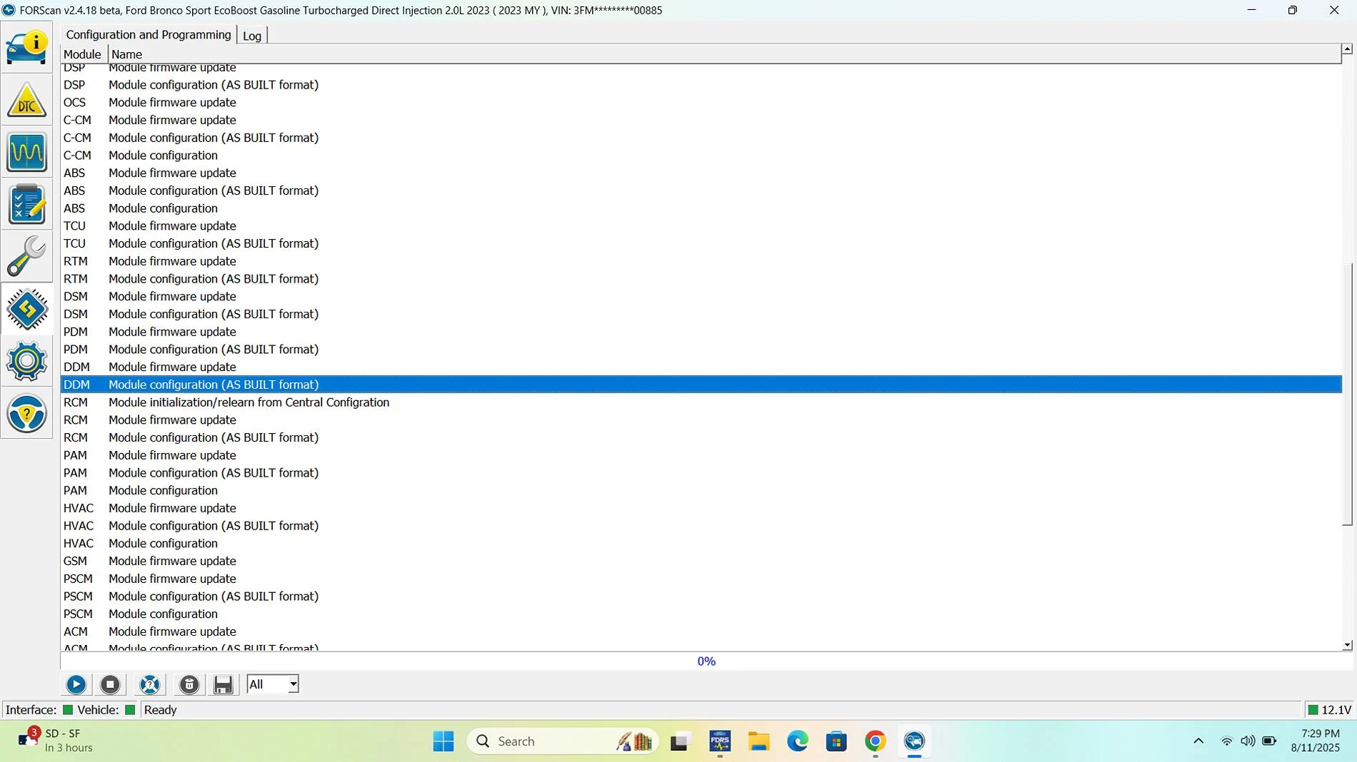

Ok, so I can for sure access all the modules. Using my VLinker and not the Mongoose. Give me a bit to play with it.
Ford Bronco Sport Bronco ForScan Thread 1754955029683-ej
rugedraw
Javier
Jul 13, 2025
593
1,151
Miami, FL
Well, it was worth a try.

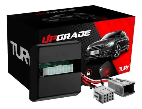

Same here. This is a weird situation. The config is there, and right. The module is there, the option shows at the car configuration (to enable and disable) but when we try.
NOPE
I have a friend here with the same car and year and he can fold. But since he is the second owner he doesn't know what the first owner did it. I guess the used a plug and play module to do that (like the image below)
Ford Bronco Sport Bronco ForScan Thread 1754956200202-g8
I don't want to use that solution since I guess the solution already exist in our car

If the motor is in the mirror assembly, there has to be a way to do it. It could be the Maverick config is different from these. We're still working in the dark here. I reached out to Livnitup today and he's still unable to make a spreadsheet for us. I'll check back with him in another month or so.
