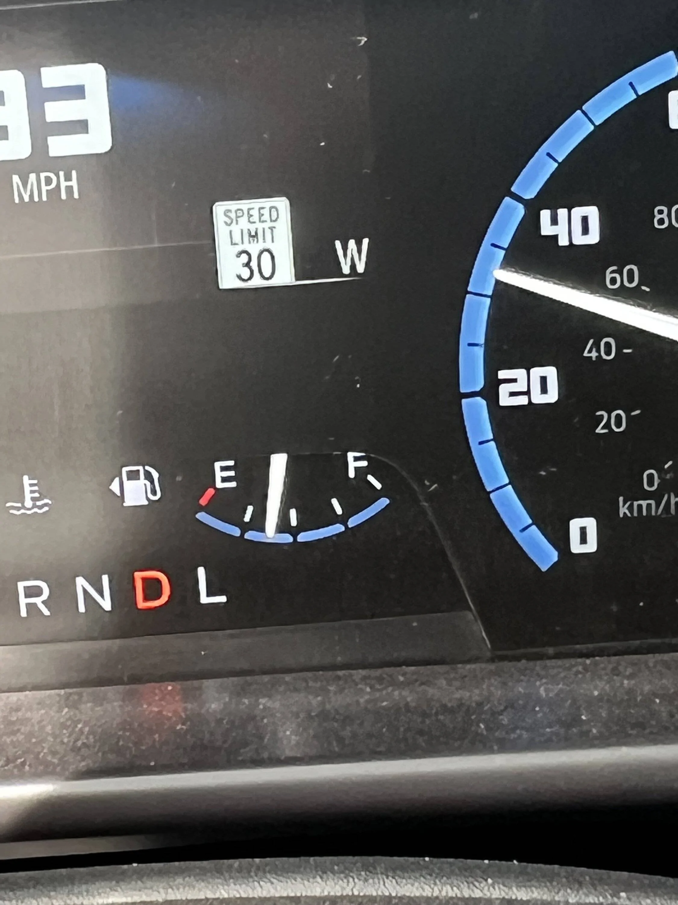

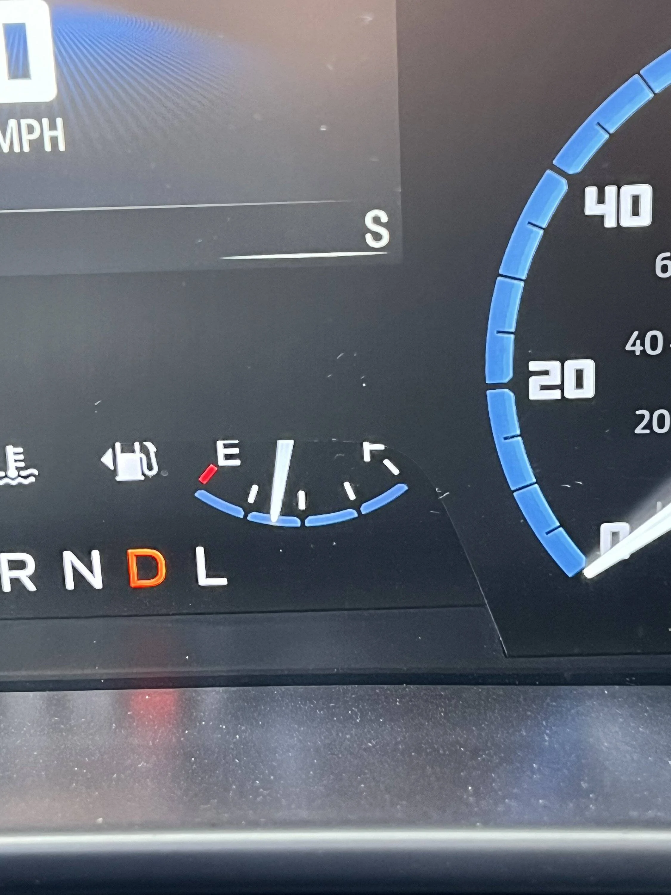

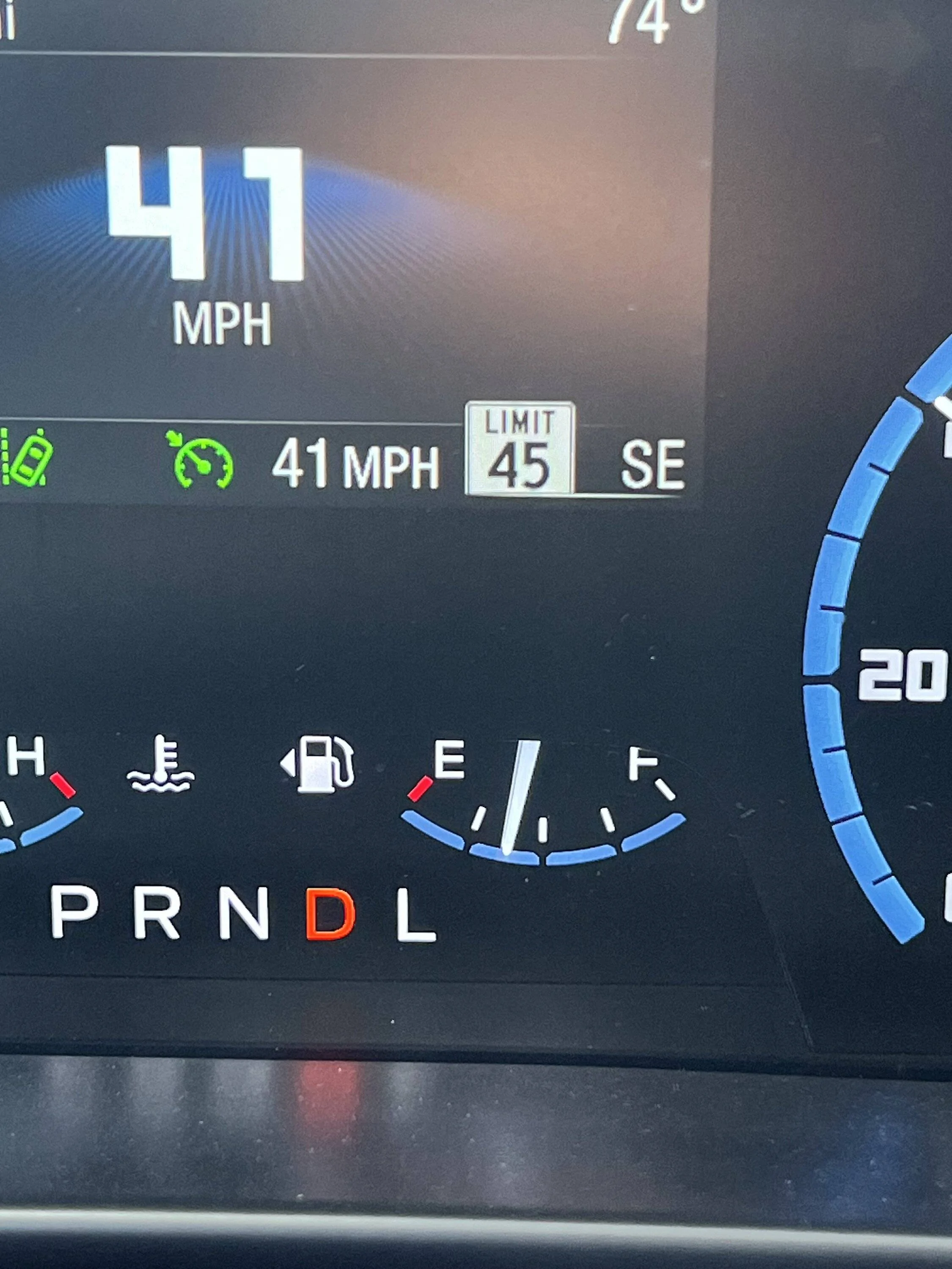

DISCO! Was able to achieve only the Speed Limit sign to show on dash on my BS Big Bend without having the Assits360+ or whatever it’s called package.
It does leave a line under the compass reading/heading but that’s tolerable.
Ford Bronco Sport Bronco ForScan Thread IMG_4709
Ford Bronco Sport Bronco ForScan Thread IMG_4712
Ford Bronco Sport Bronco ForScan Thread IMG_4711
What settings did you change to achieve this? I've got a Badlands without 360+ but would like the speed limit display if possible.
Was able to achieve it by enabling Traffic Sign Recognition in the IPC Module, IPMA Module, and APMI Module - although not sure if this last one was necessary as it didn’t put the menu/option to turn it On/Off on the display under Settings/Driver Assist.
