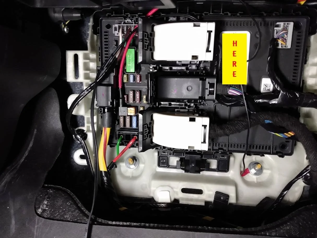

It's printed inside the lower fusebox in the passenger footwell. The 5 digit code on the security module.
If this is true, I love you. I will check later today. I only got one key when I purchased mine and I haven't bothered to go get the second one so I can't retrieve the code with the 2-key method :cwl:
They put it in mine. Though I wish accessing this fusebox was easier overall. Pulling the panel is rough, getting it back is a chore.

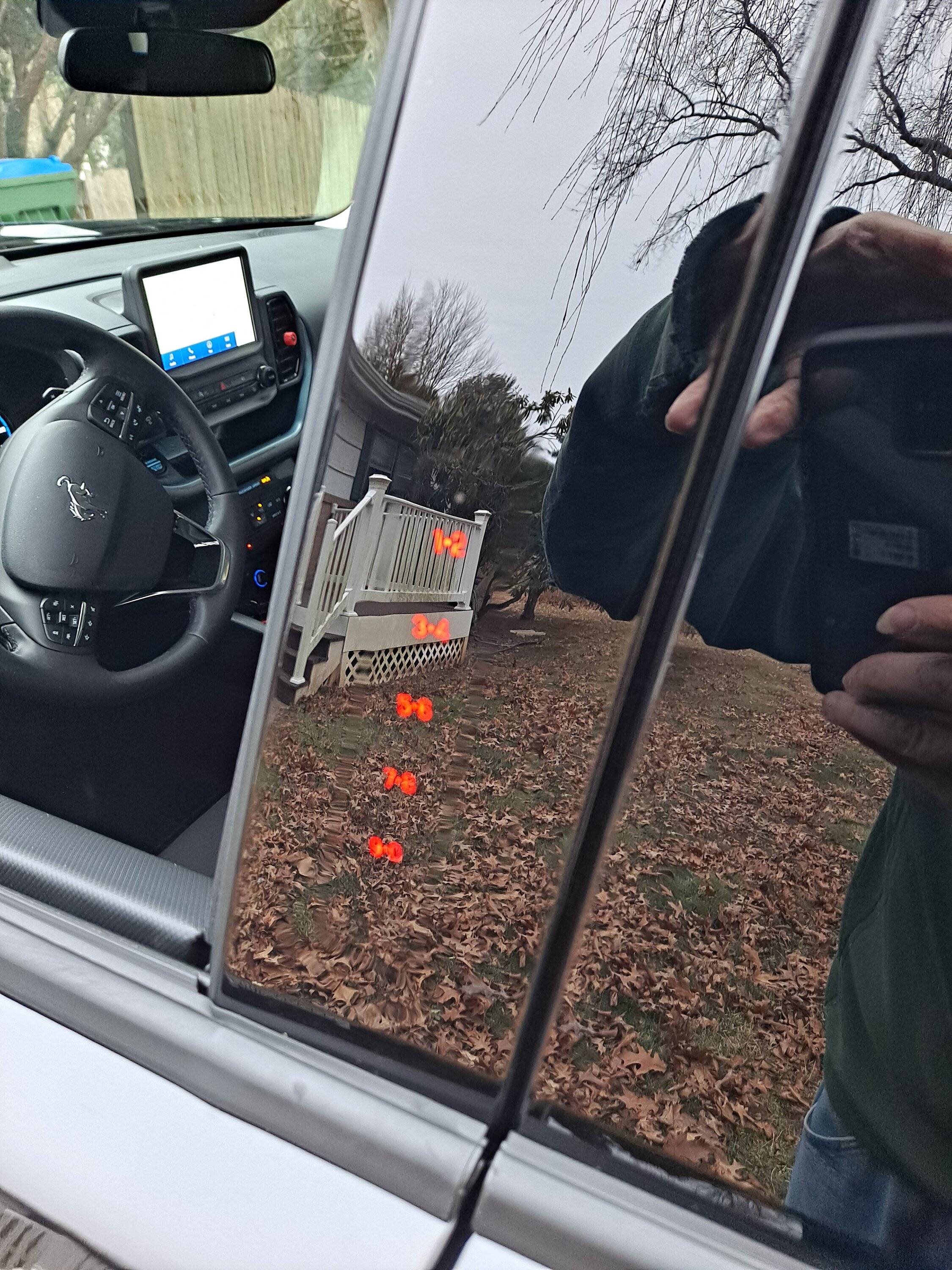

I wonder if this will work for the new style keyless entry on 2024 models. It is a dealer installed option so there will be no code listed in the manual or under the passenger footwell.
Yes, the 2 key method for keypad retrieval works with the Dealer Installed keypad on the '24 Bronco Sport.
https://www.broncosportforum.com/forum/threads/list-the-deleted-items-from-the-21-to-23.9451/post-180161
The keypad is integral to the B-pillar and identical to the keypad on earlier models, not like the black stick-on keypad used on the Maverick and full size Broncos.
