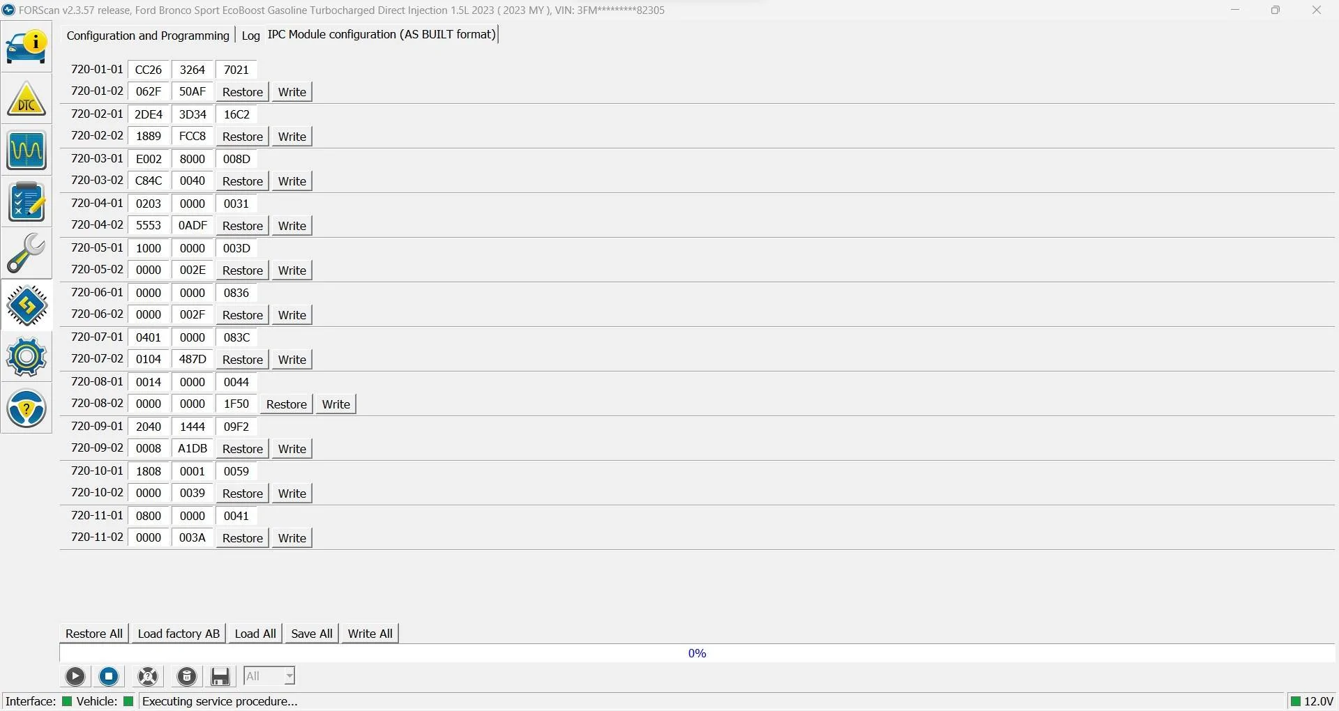

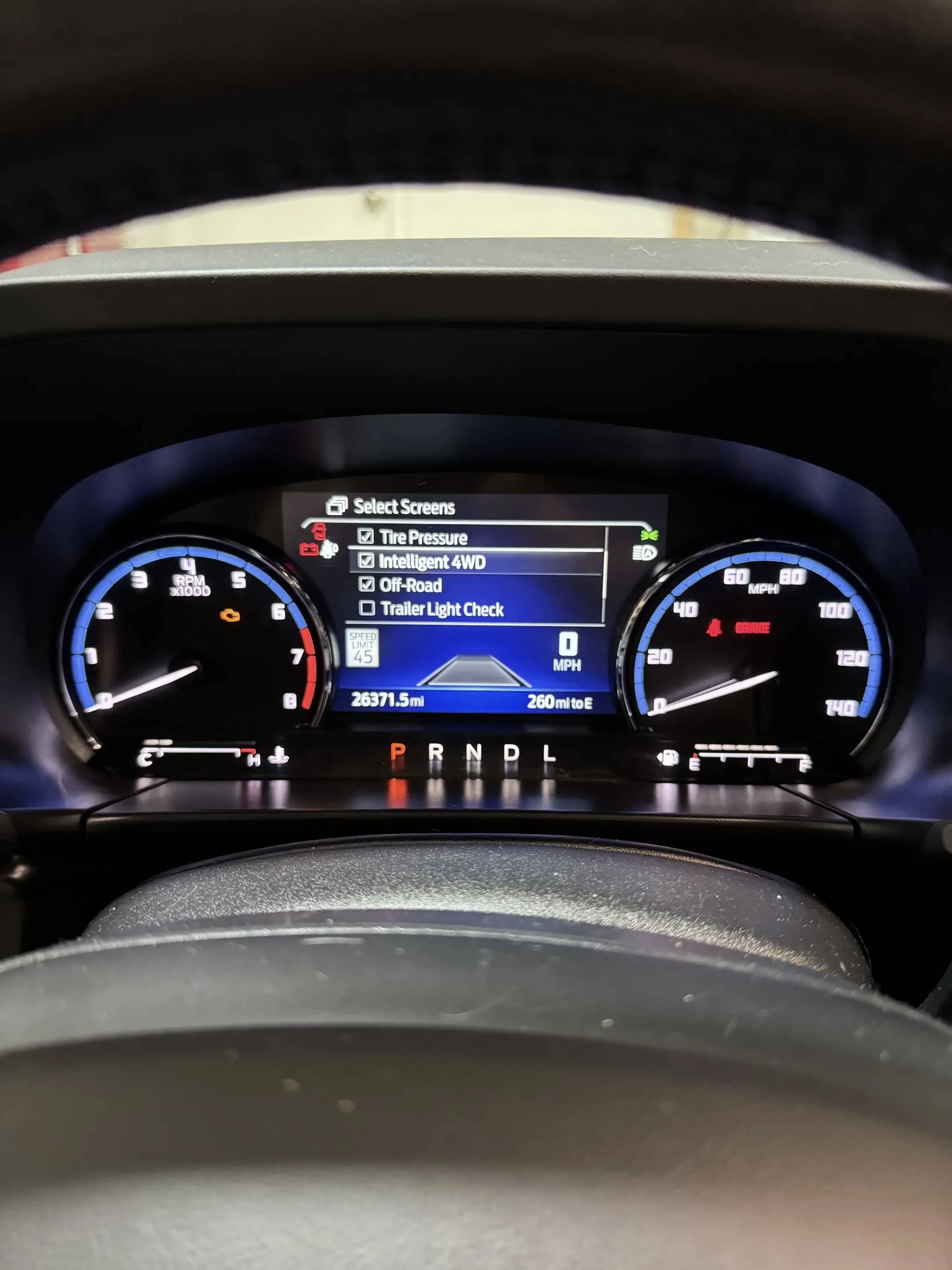

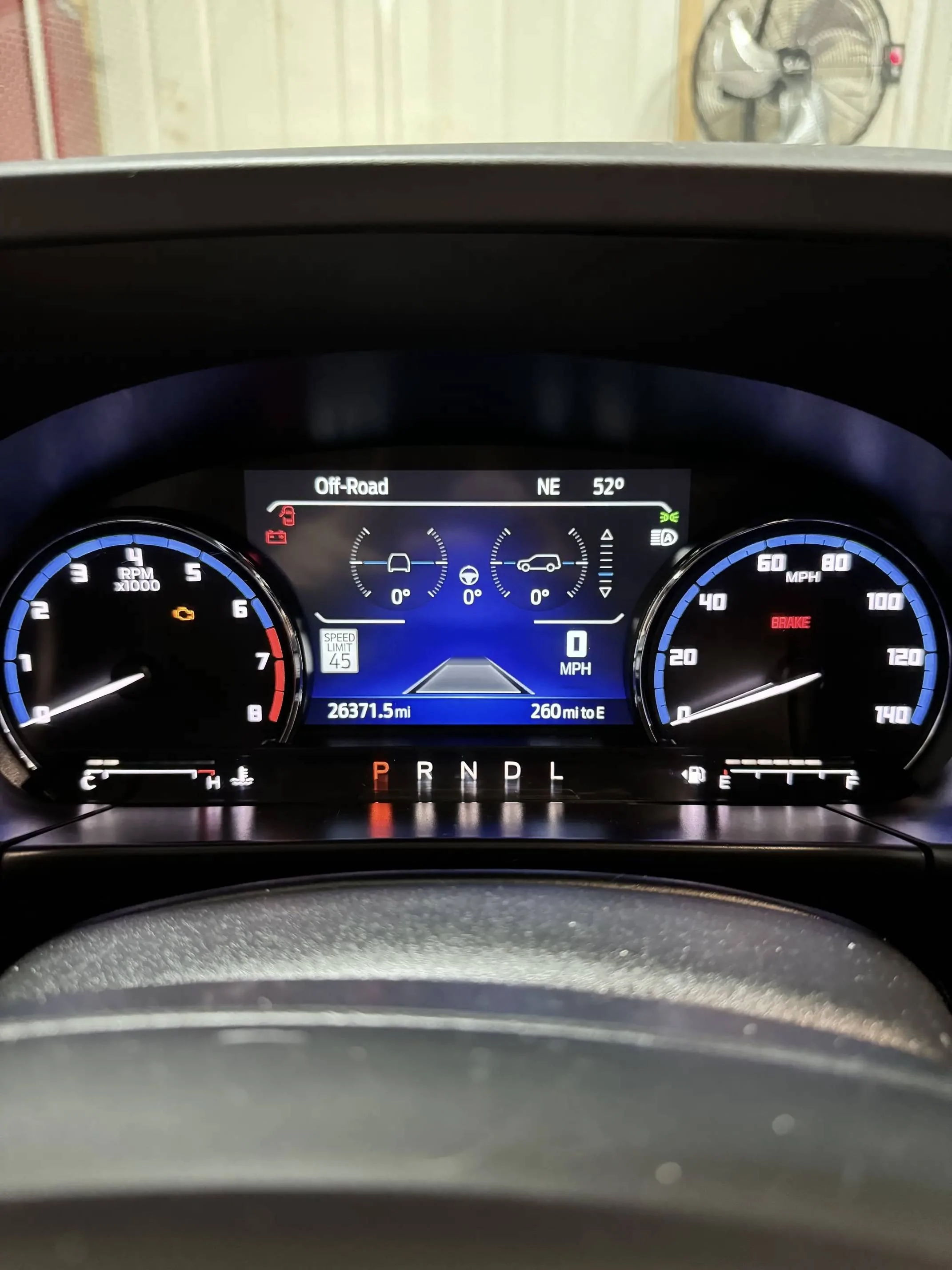

Here’s an easy fun one for y’all; you can enable the “off road” tilt and angle screen on an OBX. Requires the 6.5 inch screen to work, smaller screens won’t
Offroad Cluster Screen
IPC:
720-07-02 0704 4883 < First Edition
720-07-02 0504 4881 < Outer Banks
Change 5 to 7, accept any checksum errors, write
Ford Bronco Sport Bronco ForScan Thread IMG_9667
Ford Bronco Sport Bronco ForScan Thread IMG_9668
here it is on my angled driveway with the wheel turned; totally works!!!

Nice!!

I can't figure out this one. Am I in the right spot?
Ford Bronco Sport Bronco ForScan Thread Screenshot 2023-12-09 121646
