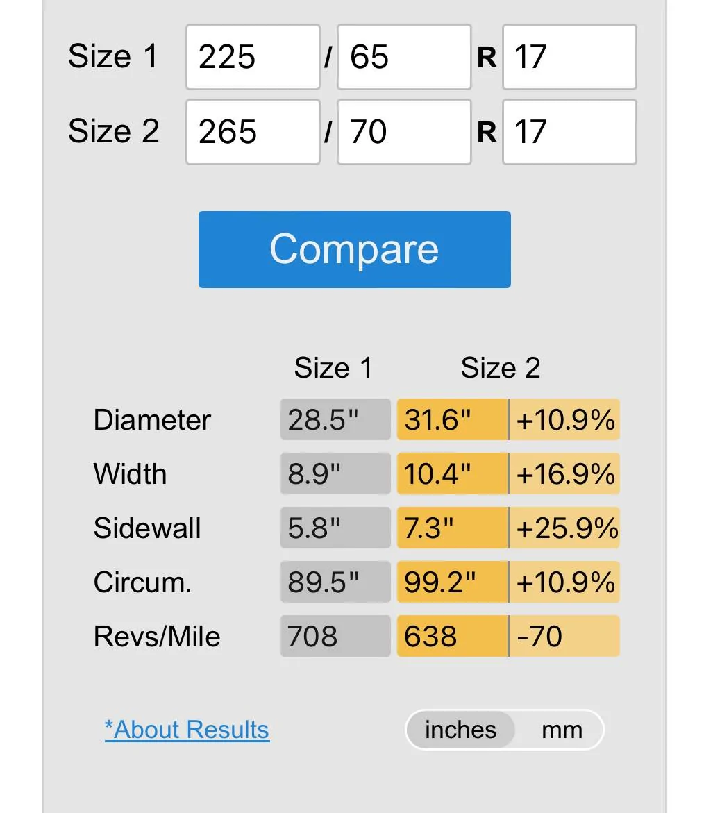

Does someone know what is the biggest MM I can put on the tire size? Now I have 265/70/17 “that’s 2520mm circumference” and got a message saying that the number is not supported and now I don’t have hill assist,goat modes,cruise control,etc.
I don’t know the largest value that fits in that FORScan parameter… but I’m surprised that tire size fits without runbing at full lock/articulation.. congrats!!

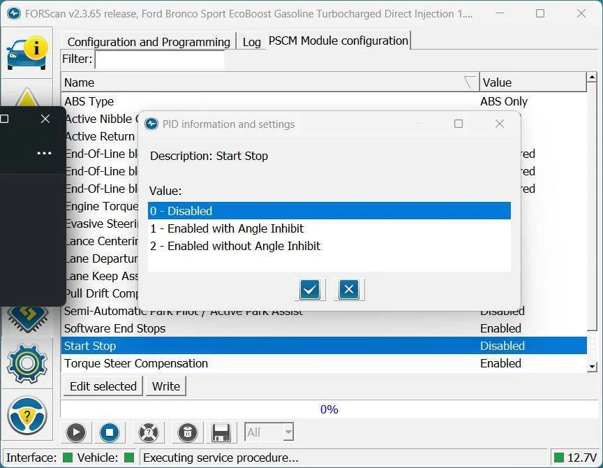

“Forscan 2.3.65 has been updated to support '25 model year vehicles, including the BS.
I was able to permanently disable A.S.S. using Forscan. No errors or warnings on divers display.
Confirmed it is PSCM PID 730-03-01, but Forscan provides an easy to find text description and drop down. Took less than 5 minutes.
No expensive third party wiring solutions required, which may void your warranty.”
https://www.broncosportforum.com/forum/threads/auto-start-stop-technique.9816/post-225952

I can confirm this about the 2025s. It did take them 24 hours to add my 2025 Bronco Sport Big Bend Black Diamond before I could connect it, but it seems to work now. I was able to turn off Start Stop and add traffic sign recognition to the dash. I couldn’t find GOAT modes to activate though. I know on the Maverick forecan it’s under ABS. That doesn’t show up on the Forscan for the Bronco Sport.

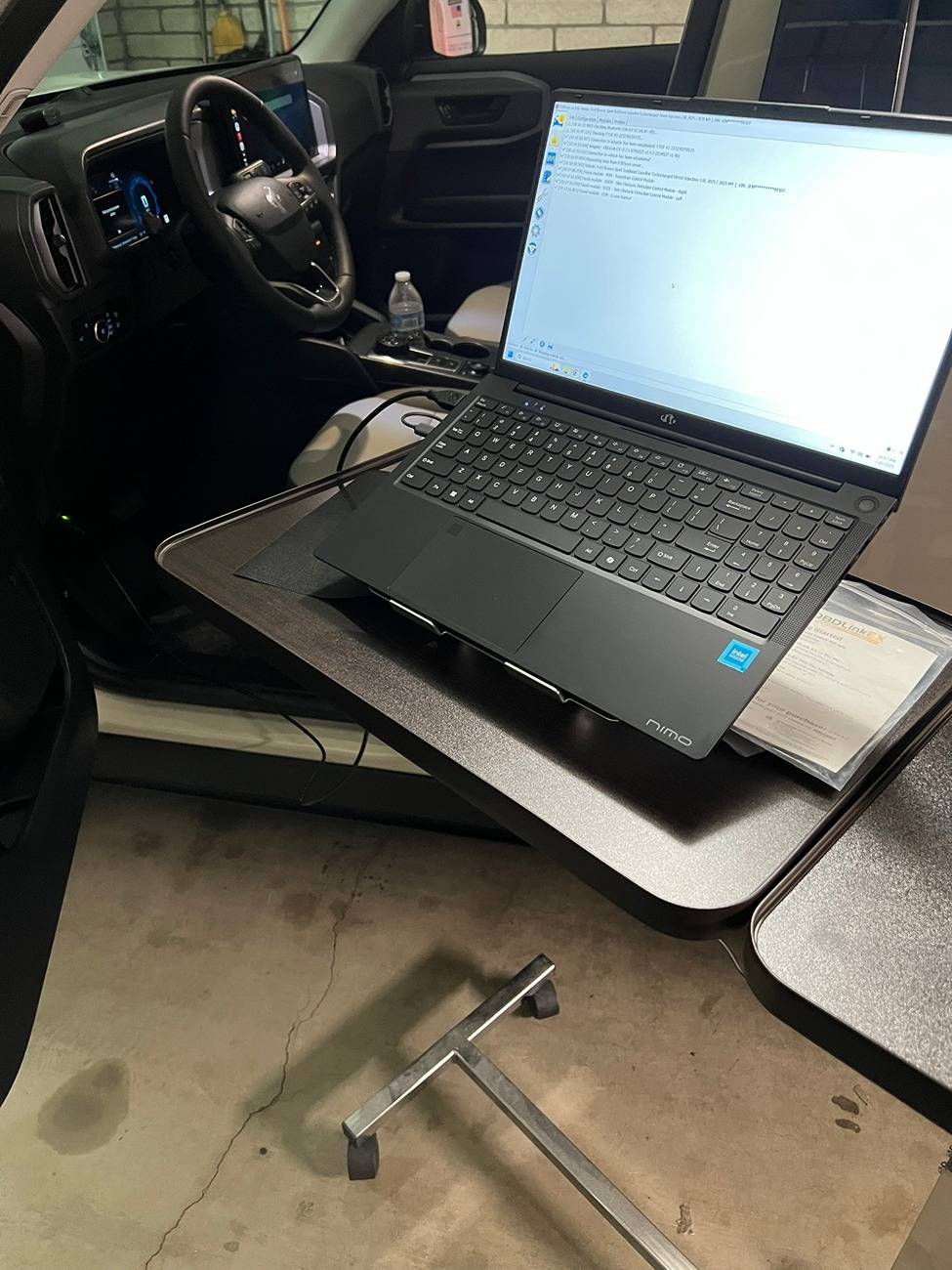

All ready to go, and find out I need the extended license to make changes. Not sure how I missed that. But hey, my workstation's up and ready! The cart is also perfect for wheeling over to the laser and 3D printer, so there's that.

All done, ASS disabled. Not that it makes much difference in Phoenix most of the year as it rarely does its thing. That makes it worse, IMO, because it's always a surprise when it "engages". Same thing with my last car.
