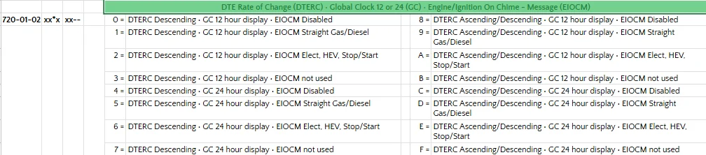

so has anyone found the setting for "Triple Ding at Start Up Disable" for the 2025? i don't know the right name for the feature, and it looks like it's found here for 2021-2024:
Triple Ding at Start Up DisableIPC*720-01-02xxxxx2--
I searched the extensive Maverick 2026 FORscan sheet i found but can't correlate it yet...
Google Sheet - 2026 Maverick
Maybe here? Worth a look.

not there, but either what spreadsheet is that, or can you go a few rows down to this set of values:
IPC*720-01-02xxxxx*--
that would help determine the name of the parameter so i could find it in a compatible vehicle - thanks!

That is from the 25/26 Maverick sheet. The value you posted does not seem to have anything to do with what you want to accomplish.

actually that might be it - as per other spreadsheets the entry for IPC* 720-01-02 xxxx x*-- lists the parameter as "Disable key-in ignition chime" which might correlate with "Engine/Ignition On Chime - Message (EIOCM)." I can check and connect FORscan this evening and see if that matches and/or if that's listed in Easy Mode for the IPC. Thanks all!

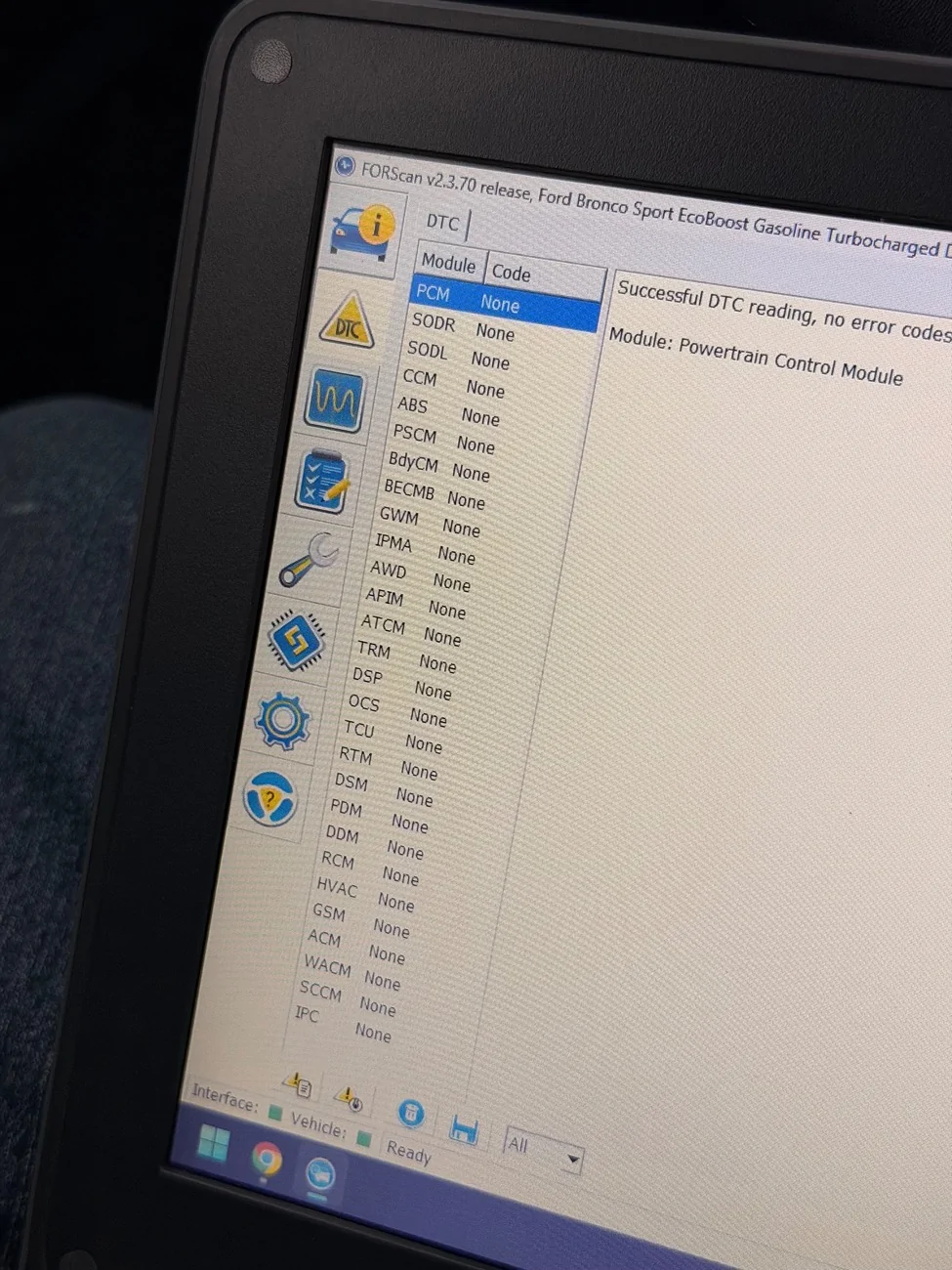

So, here's what I came up with.
Just like most of the other tutorials, you start by opening the BCM, and and modifying your tire size there. I did some GPS calibration for my 235/65/17 AT3Ws, and input the value of 2215 mm's.
Ford Bronco Sport Bronco ForScan Thread BCM - Tire Siz
After you enter that you write, and move on to the ABS configuration. They have my tire size as an option there so I updated that as well, though this didn't seem to be critical in the process.
Ford Bronco Sport Bronco ForScan Thread ABS - Tire Siz

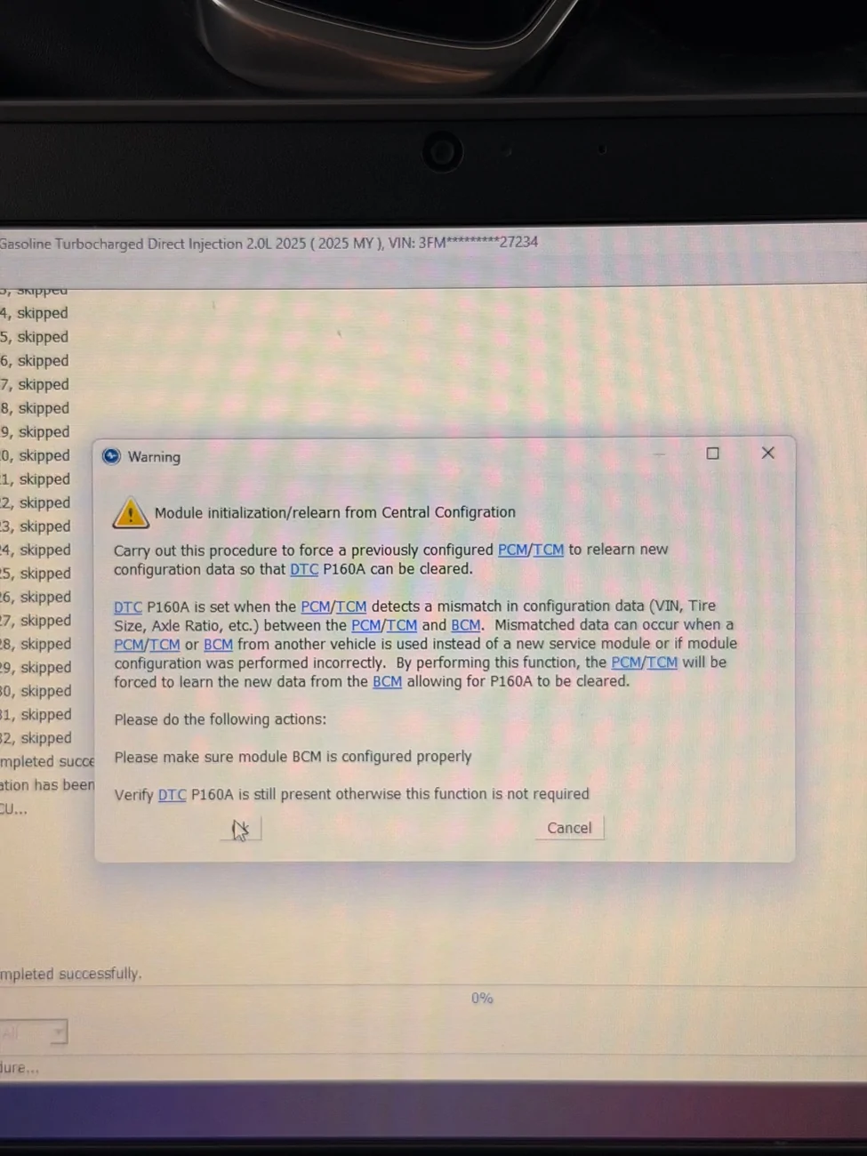

After this was done, I cleared errors, and then did the PCM relearn, though the errors popped back up immediately which I expected.
Ford Bronco Sport Bronco ForScan Thread PCM - Reset
After the reset, the key that I spent 3 hours trying to find is that you now need to re-initialize AWD in the configuration module.
Ford Bronco Sport Bronco ForScan Thread AWD Re-Learn
This is the most important part. It re-initializes the AWD info from the central config that you just updated. You do a full restart of the vehicle (wait 3 mins after opening door), then clear errors one last time (likely residual, not showing on dash) and you should be good.
This cleared all of my errors, my fuel economy, and speed are now reading correctly.
The only weird thing is I'm surprised by the tire size in mm that is actually working, so I may toy with it with other speed tools to ensure that it's actually correct.
That said, this all worked for me, and I was good to go after that final bit.

Ford Bronco Sport Bronco ForScan Thread IMG_5366
Ford Bronco Sport Bronco ForScan Thread IMG_5367
I finally had time to get to this 🤣
