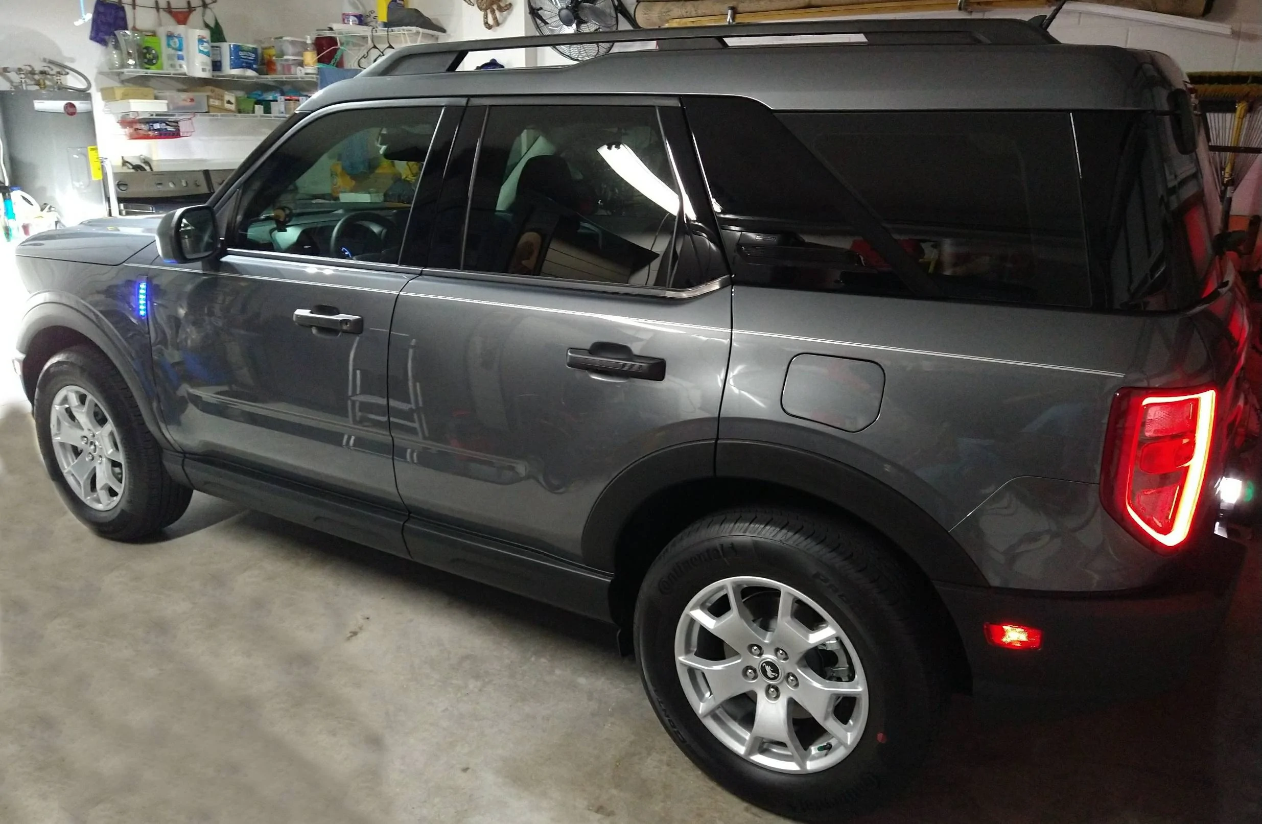

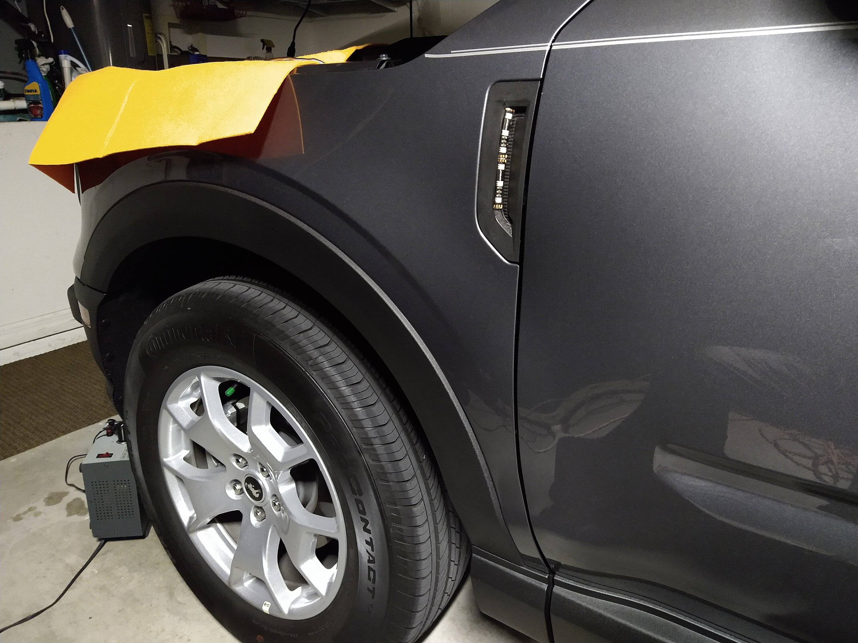

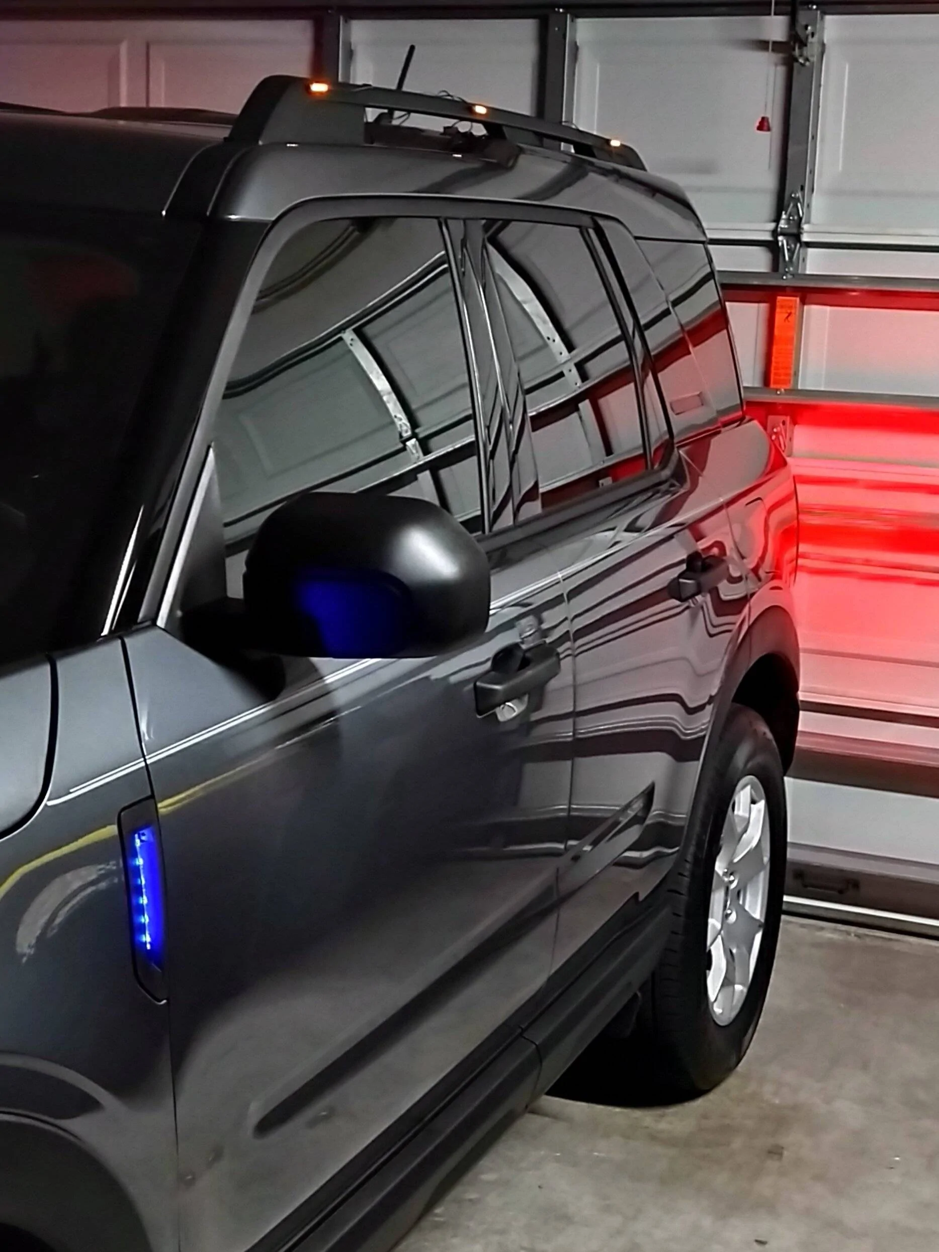

That's nice. I wish those were around when I did my vents last year. I had to build mine from scratch. They do not interact with the blinkers, they just come on when the lights come on.
Ford Bronco Sport Tectico LED fender light side marker install IMG_20210422_041701968
Ford Bronco Sport Tectico LED fender light side marker install IMG_20210501_152631490
Ford Bronco Sport Tectico LED fender light side marker install IMG_20210527_034656067
Ford Bronco Sport Tectico LED fender light side marker install IMG_20210529_024850558
I like the blue of yours

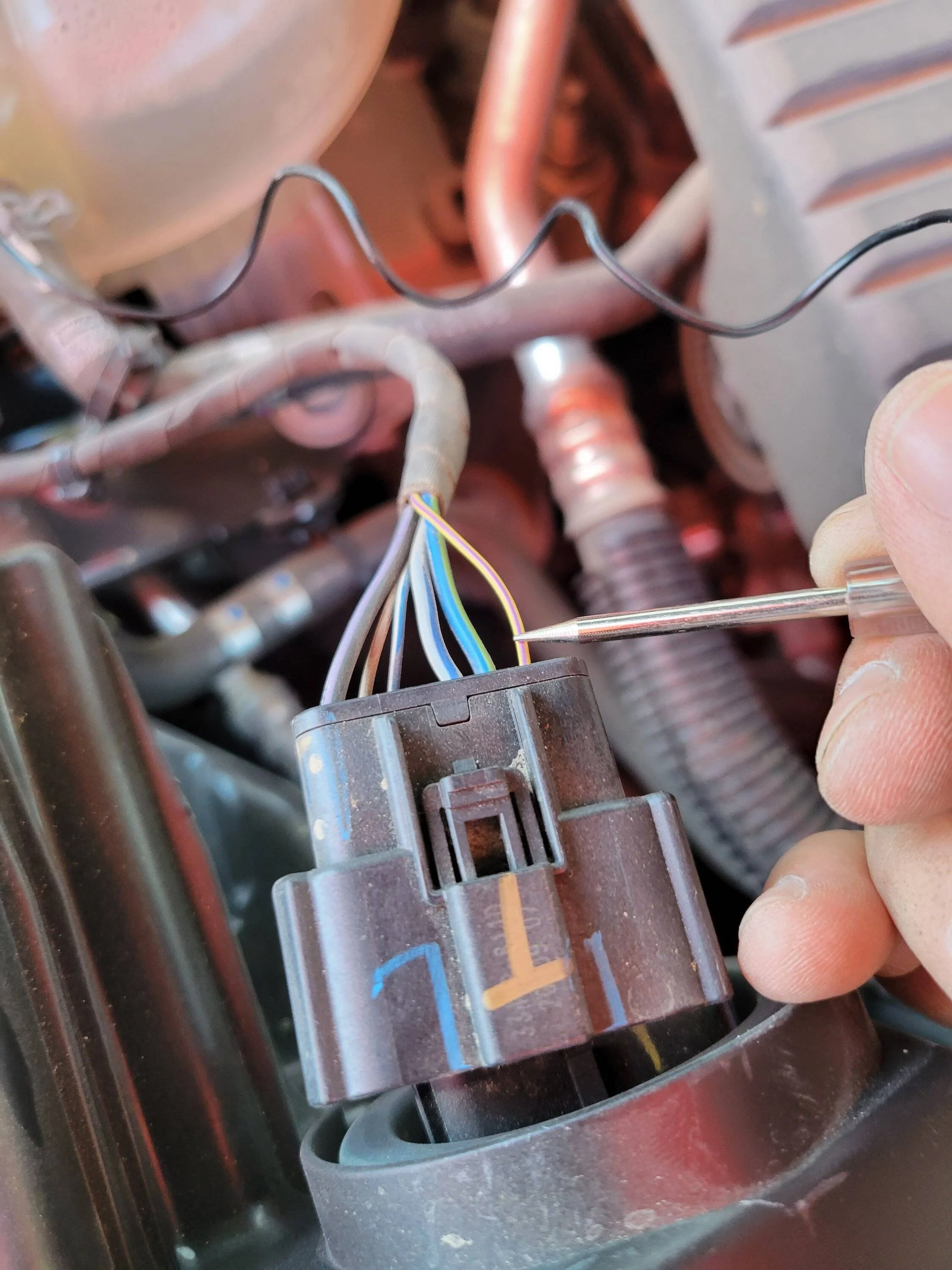

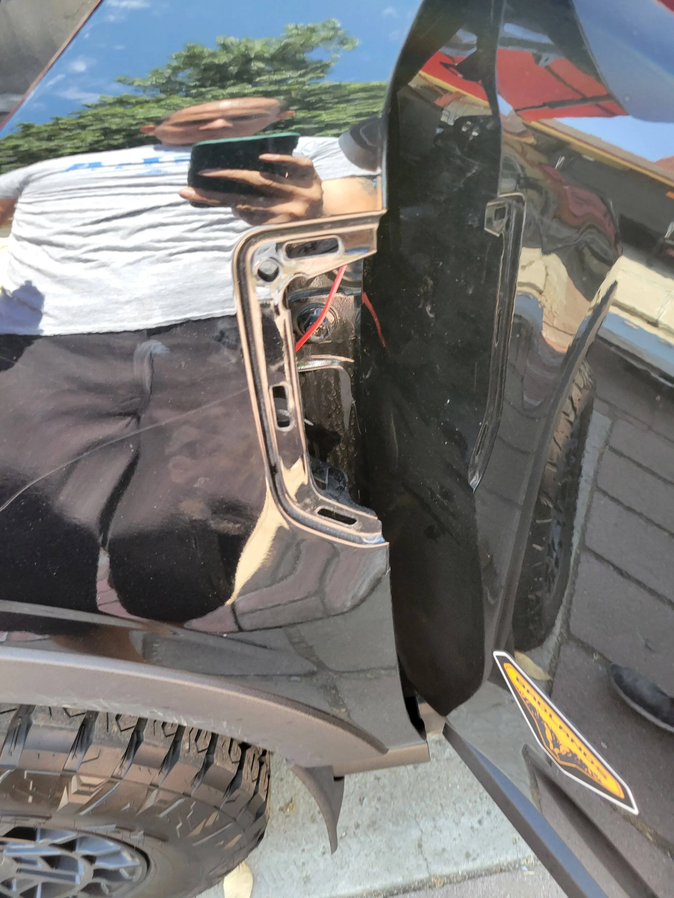

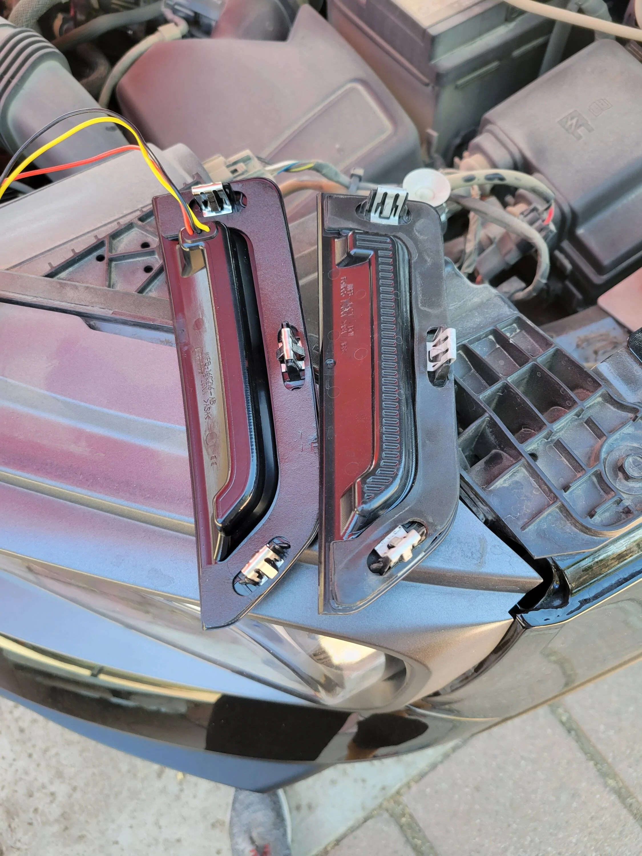

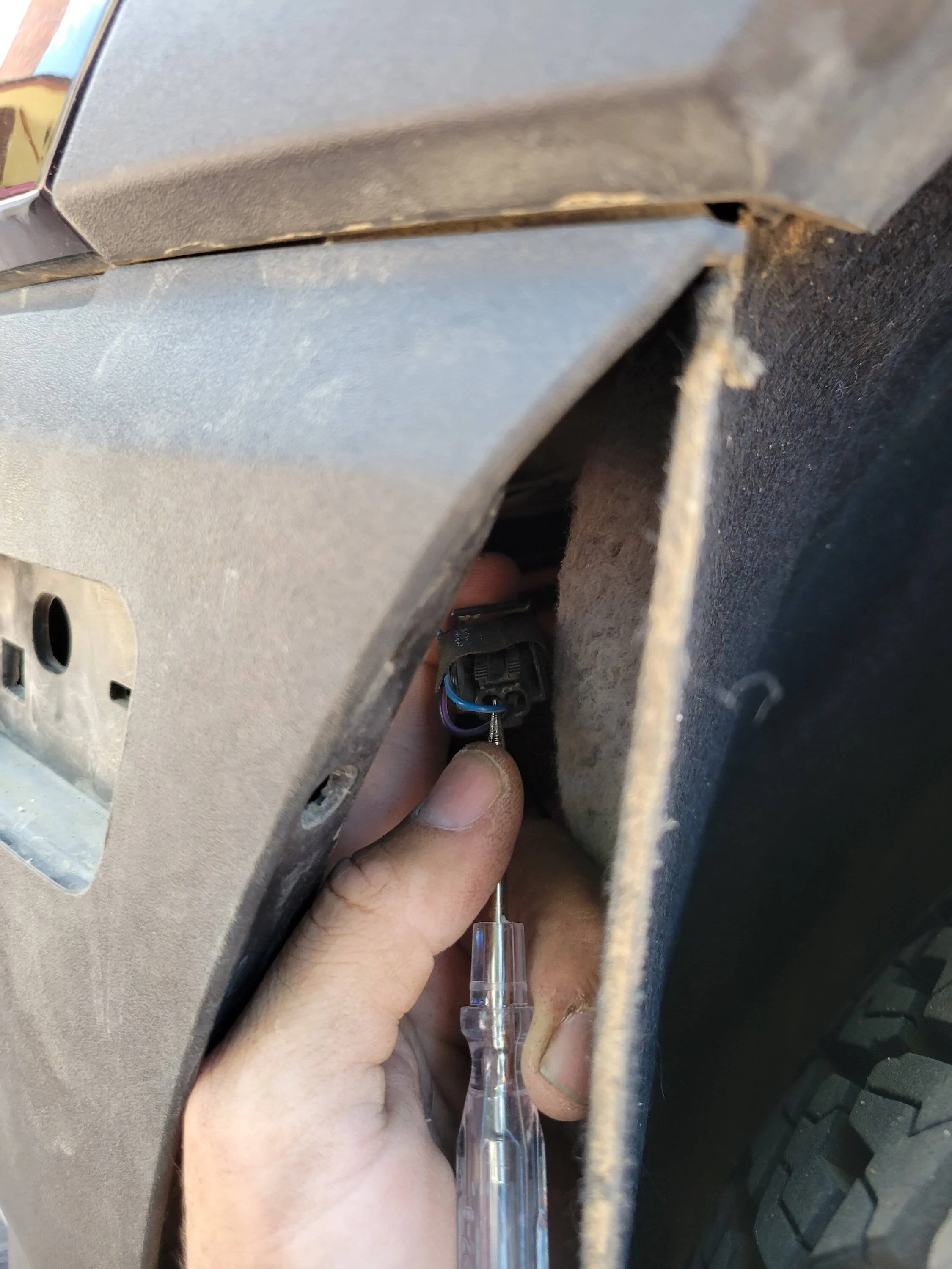

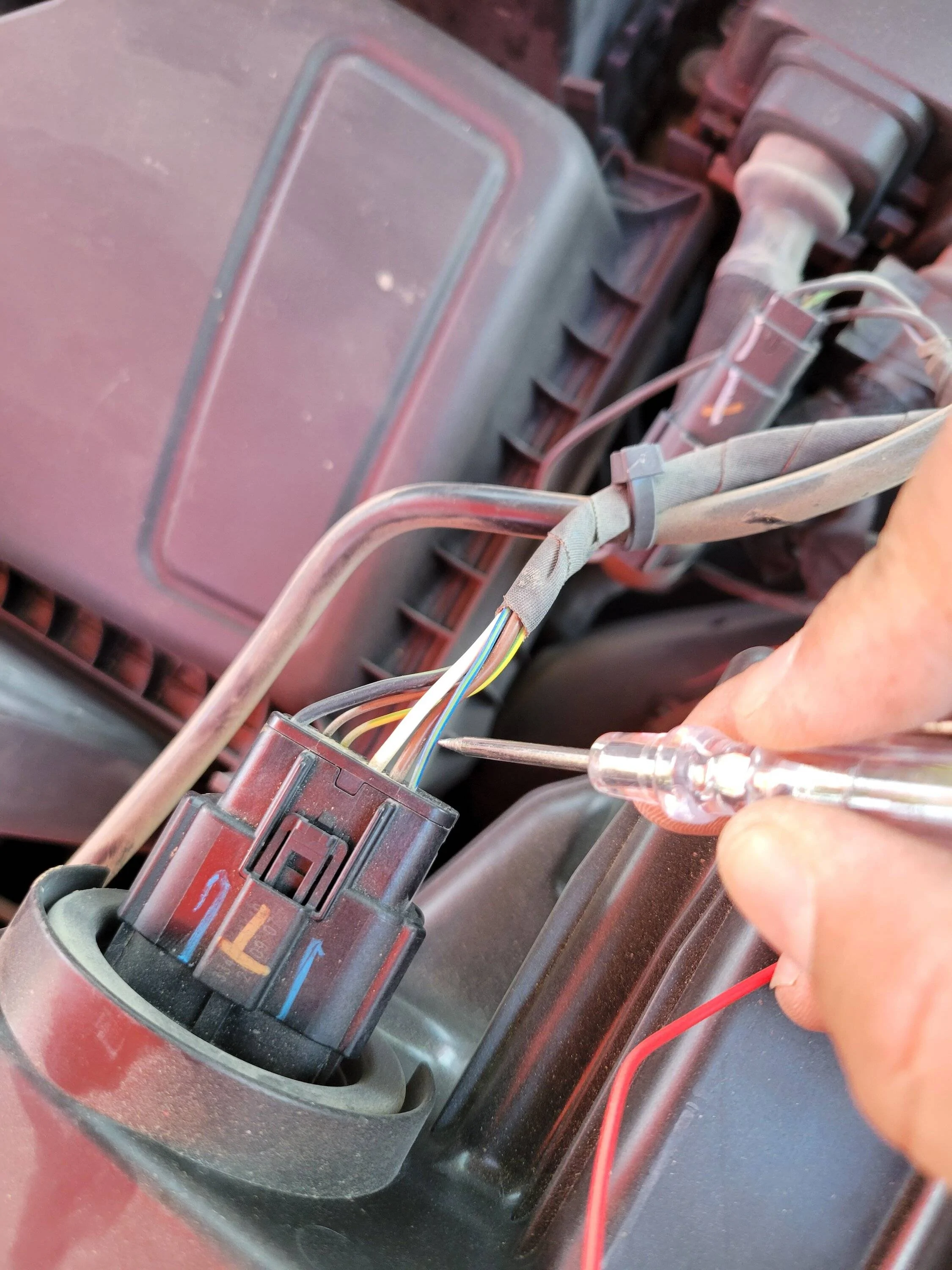

I installed the side marker install from Tectico today, it was a easy install 3 wires install and that's it. Red wire down to the courtesy side marker, to the blue wire. The yellow wire to the turn signal blue with green wire driver and yellow with purple passenger. Then just the a ground wire on both sides and that's it. They look good and well built

I tried what you suggested Walter. Impossible to get to. I don’t know how you did it. There must be a DRL wire into the headlamp box because there is a running light there. I’ve tried the multimeter to read other wires. It’s only a 7 volt reading and then when I turn DRLs off the reading remains on meter even after all other courtesy lights turn off.
It is a tight squeeze, it's easier with the tire off
