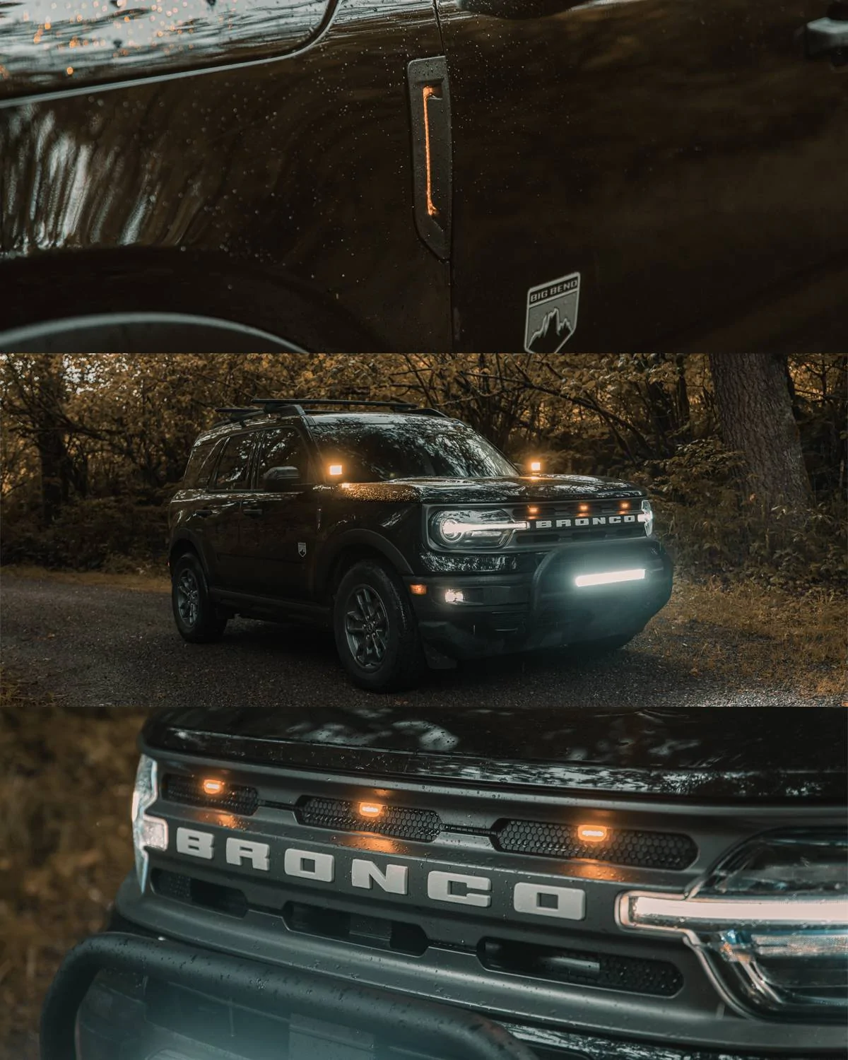

I have such a dumb question, but what does the stock set up do or look like?
In all the night photos of the BS, I've never seen that area lit up.

The original set up doesn't have lights it's just plastic
