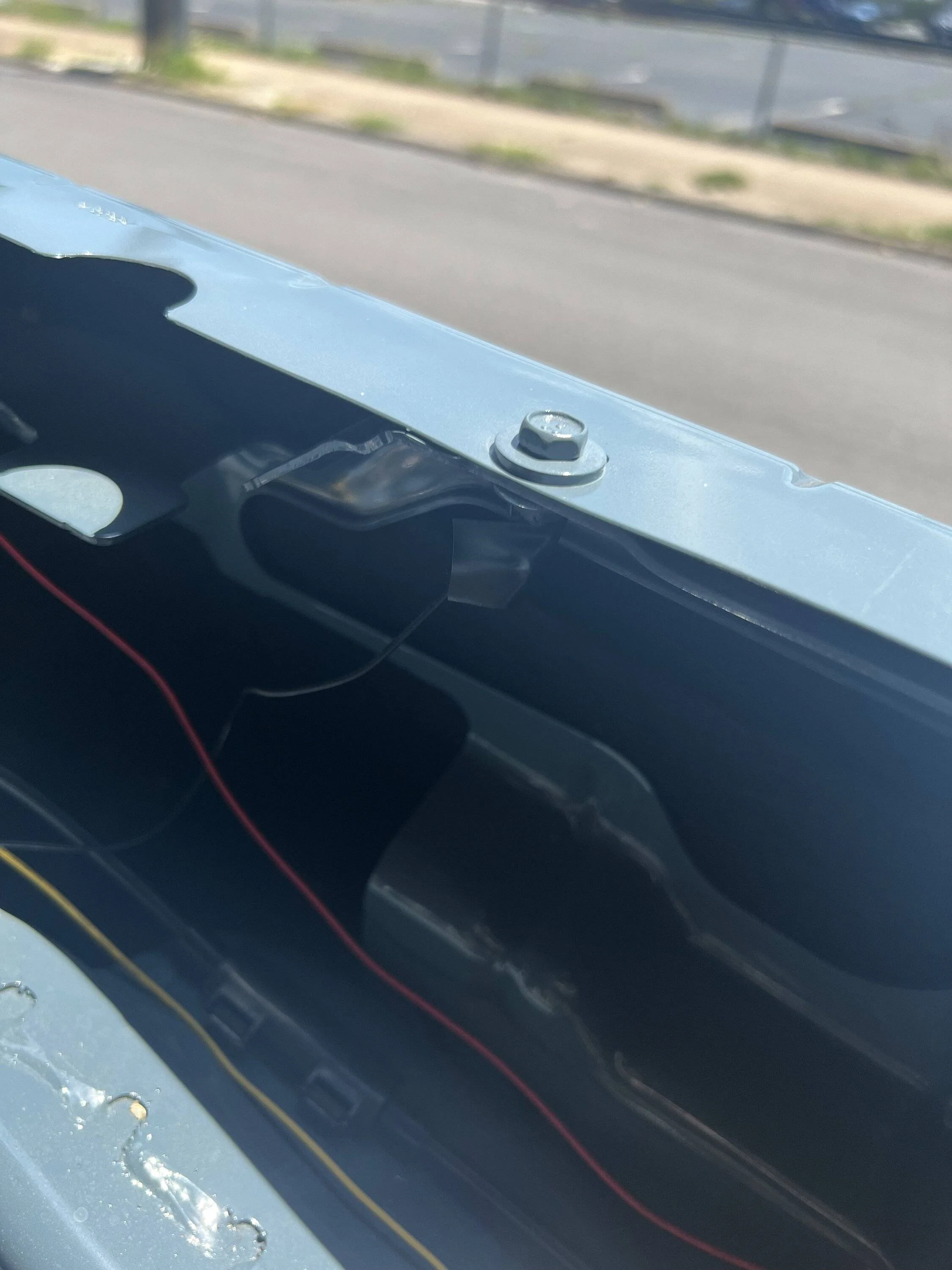

@Wabarca2 ok so - yellow wire connected to driver blue/green, red wire run down to lower light blue, black attached to bolt on fender.
Ford Bronco Sport Tectico LED fender light side marker install IMG_5553
Ford Bronco Sport Tectico LED fender light side marker install IMG_5554
Ford Bronco Sport Tectico LED fender light side marker install IMG_5555
still no luck - same as before, amber never turns on, but white does (including hazards and turn signals). starting to pull my hair out on this one.

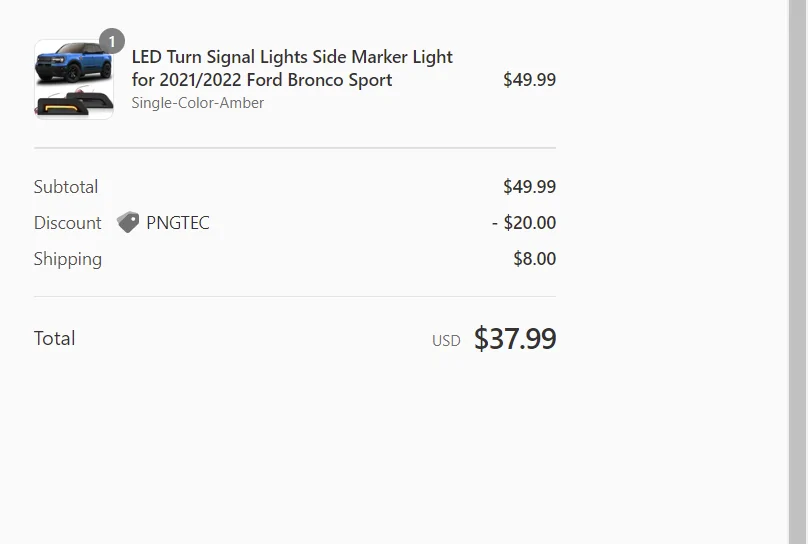

Ordered these the other day and get a new email every day offering me a higher discount even though I already ordered them.
In case anyone is shopping..
40% off - PNGTec
30% off - 3WVTEC
