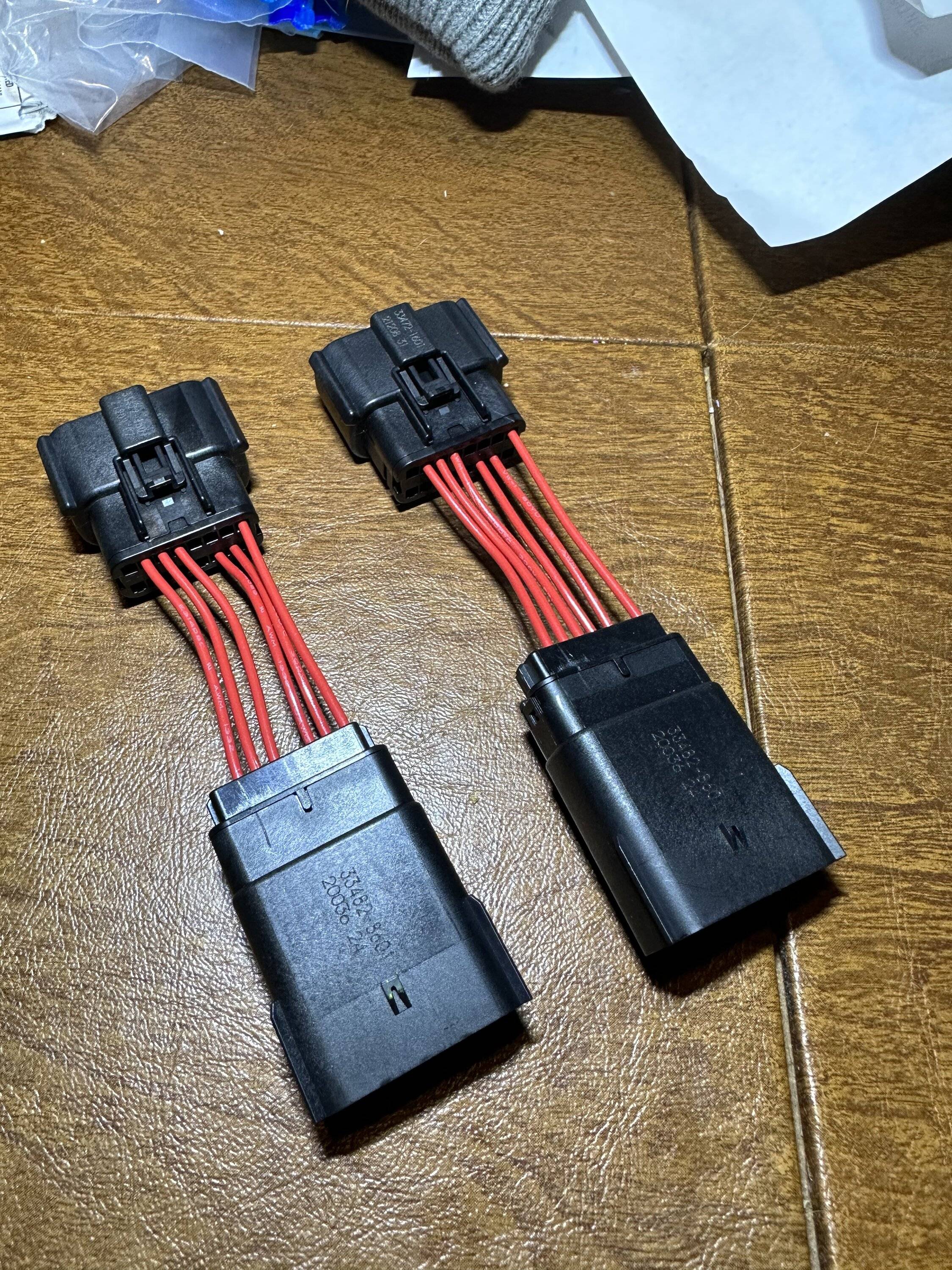

For those that might be interested I wanted to share my journey on trying to get these side marker lights working. For reference I have a 22 Badlands but I think the wiring should be the same in all.
Like others I did not want to ā€œtapā€ into or cut and splice into the factory harness. So to get around that I contacted Specialty Performance Part over at https://specialtyperformanceparts.com/ and after some back and forth I spoke with John and he sent me a ā€œkitā€ so I could make my own adapter to go between the factory harness and the headlight assembly. This is what those look like:
Ford Bronco Sport Tectico LED fender light side marker install D37C0EF7-F2C8-4BDD-8A5A-F3F6E97A3694
There are only 6 wires total and they correspond to pins 2,3,4,8,14, and 15 of the connectors. I then cut the wires off the newly made adapters and using the supplied non-insulated crimp style connectors and heat shrink I connected the side marker light to the adapter.
One thing I learned is that the wire colors and their associated function that have been discussed in a couple of these threads are a little confusing.
Obviously the Black wire of the side marker light connects to Ground, I thought about connecting this to a metal part of the car but decided to use the Ground connection on the adapter which is pin 8 and connects to the Black/Green wire on the Drivers Side and the Black/Purple wire on the Passenger Side.
Next I connected the Yellow wire for the Blinker function of the marker light to pin 2 of the adapter which connects to the Blue/Green wire on the Drivers Side and the Yellow/Purple wire on the Passenger Side.
I have the 3 wire version so next was the Red wire for ā€œDRLā€ and this is where the confusion started. I though about connecting it to the wires shown in a YouTube video but I also saw mention of people connecting it to a different wire on this forum and after searching around the internet thought that I had it all figured out. Well I can tell you for certain that connecting it to the White wire, pin 4 of the adapter, is the WRONG option. Connecting it to that wire caused the white lights to be on constantly even when the car was not running and locked with all other lights off. I’m just guessing here but I think that wire provides power to the ā€œfanā€ that I think I hear running when the car is off.
The ultimate solution for the Red wire was to connect it to pin 3 of the adapter which connects to the Brown/Blue wire on the Drivers Side and the Blue/Green wire on the Passenger Side. The unfortunate result of this connection is that it is not a true DRL connection but actually Headlight connection itself meaning that the White light is only on when the Headlights are on and not just when the true DRL lights are on.
I only did some preliminary tests tonight as for one it’s dark out and for two I haven’t decided if I’m going to keep the Red wire connected. I really wanted the white light on during the day and could care less about the night time.
It is worth noting that hooked up that way the white light does go off when the blinker comes on but that it a function of the circuitry in the little box more that anything else.
Sorry for the long post and as soon as I have things fully installed I’ll post more pictures. Finally this solution did cost more than the automotive store crimp connectors but if I want to put it back to factory all I have to do is unplug everything.

So basicaly this would be an extension harness that could be used for the splicing and not tapping into factory wiring correct? do you have Part numbers and pricing?
