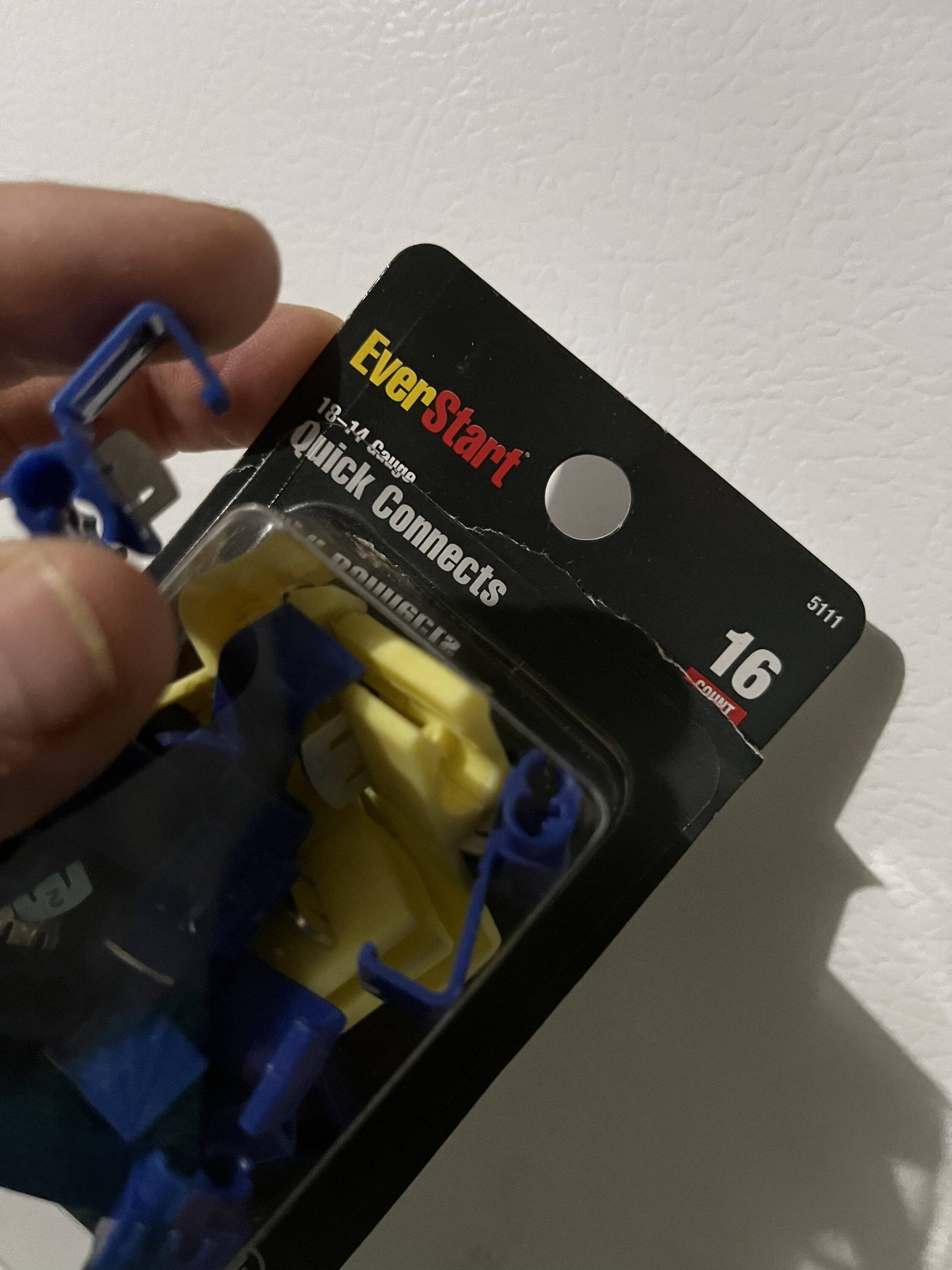

I know it works and people are not having problems but I cannot bring myself to tap onto/into the factory wiring system. Now if I could unplug the headlight, plug that into an adapter and plug that back in the head light I’d feel safe doing it.
FWIW, I was worried at first too but used the quick connects for the job which does not require you to cut or strip the factory wires, it merely knicks the wire enough to make a connection to the metal clip in the quick connect over to the product wire and I was able to remove and redo several times with ease and minimal impact to the factory wires.
This style of connector is problematic. These are designed to cut through the insulation to get to the wire strands on the inside. Breaks in the wire insulation allow air to get to the wire strands, which means eventual oxidation and corrosion. If you install and remove one of these connectors you leave behind more breaks in the insulation.
If you plan to get rid of the car a few years from now you'll likely be fine--you'll just be passing the eventual problems on to the next owner.
This article explains the problems associated with this type of connector. If you absolutely have to cut factory wiring you should select a type of splice that seals and protects the wire from the elements.

All you guys better read what Mark posted.

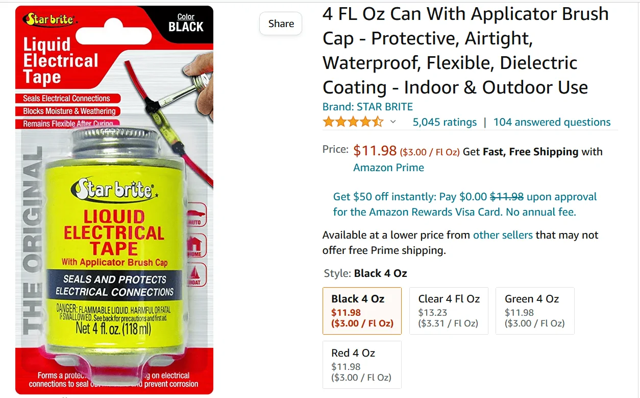

color coded options available
found to be a very practical and durable solution
Ford Bronco Sport Tectico LED fender light side marker install 1666787578490
This can work. You can also apply appropriately sized heat shrink. Note that appropriately sized means it shrinks to seal tightly around the wire insulation. The other options, in my opinion, are easier to use (less messy), take fewer steps, and once you know how to use them are less prone to installation error. I'm referring to solder-seal connectors, or sealed, step-down crimp connectors. Solder-seal connectors require a heat gun and a bit of skill to install properly, but the splice they produce is as durable as the original wire insulation. Sealed, step-down crimp connectors also require skill, a properly sized crimp tool, and a heat gun to activate the sealant.
To make a splice in existing wiring using either of these connectors you would cut the wire you are splicing into, strip the insulation, and insert the cut ends into both ends of the connector. You then strip the wire you want to add to the circuit and insert it into the appropriate end of the connector.
Note that for both of these type of connectors you must use the proper size. If the connector is too large for the wires you are splicing it will not shrink down enough to provide an environmental seal.
This video explains how to use the connectors described for a three-way splice. It also covers the pros and cons of different splicing devices/strategies.

Well :ontheloo: now you tell me ?ā€ā™‚ Woulda been nice to know this at the top of the thread but oh well, it is what it is and for my level of expertise, the snap connectors matched my skill level. I’ll do what I can to tape or liquid tape to protect from the environment, but IMHO, I don’t feel like it’s that big of deal. I guess it’s all about risk vs reward and what you feel comfortable with. For now, everything works great and looks good, but do appreciate the info.

big fan of shrink tube use
last application
old wood rake handle kept dealing out slivers
shrink tubed select sections of handle
slivers no more
