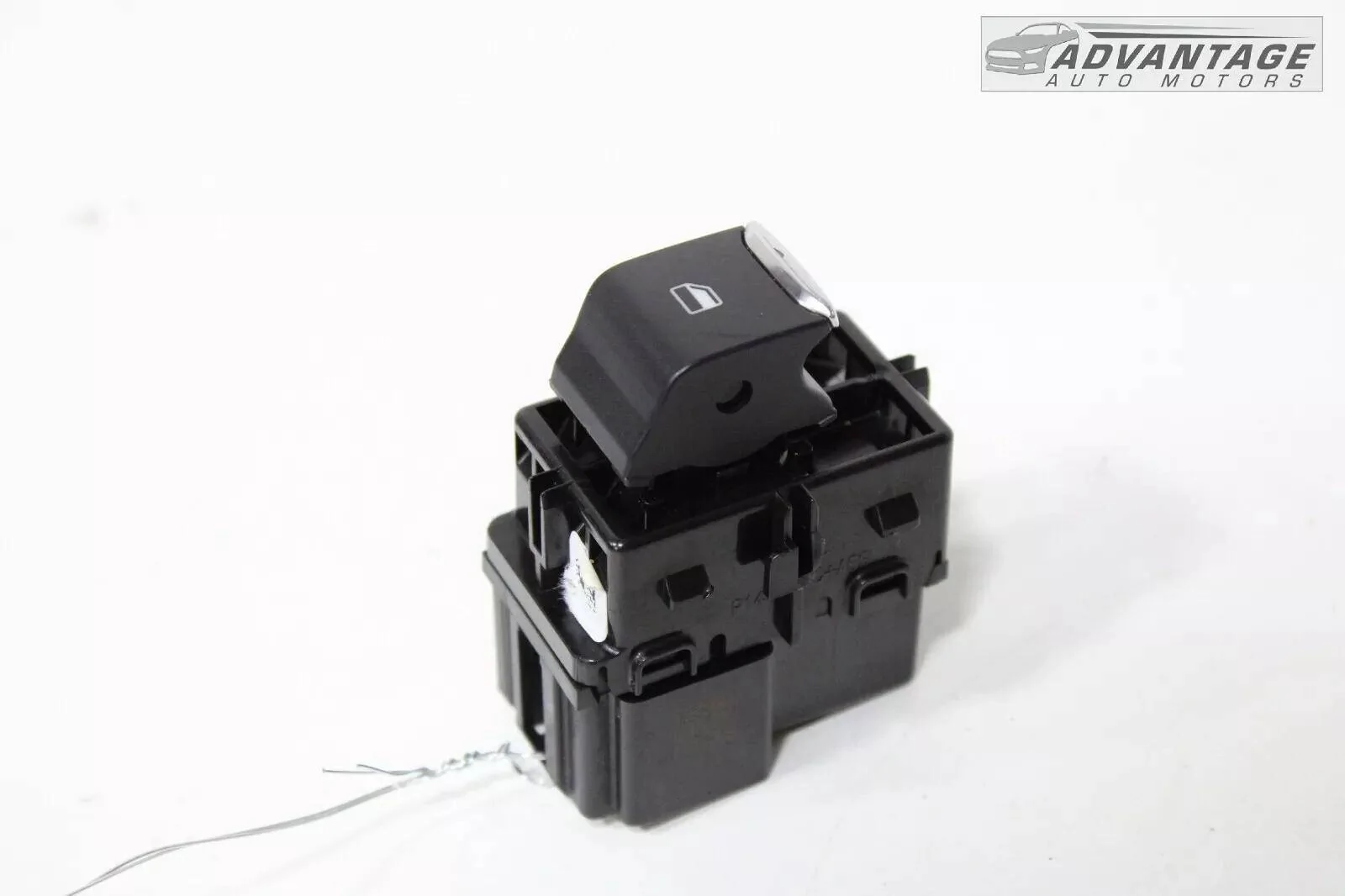

not the first I've seen it happen with this style ford window switch. best to find a replacement and swap yourself. super easy to remove. pop that piece out and look for a part number so you get the right one.

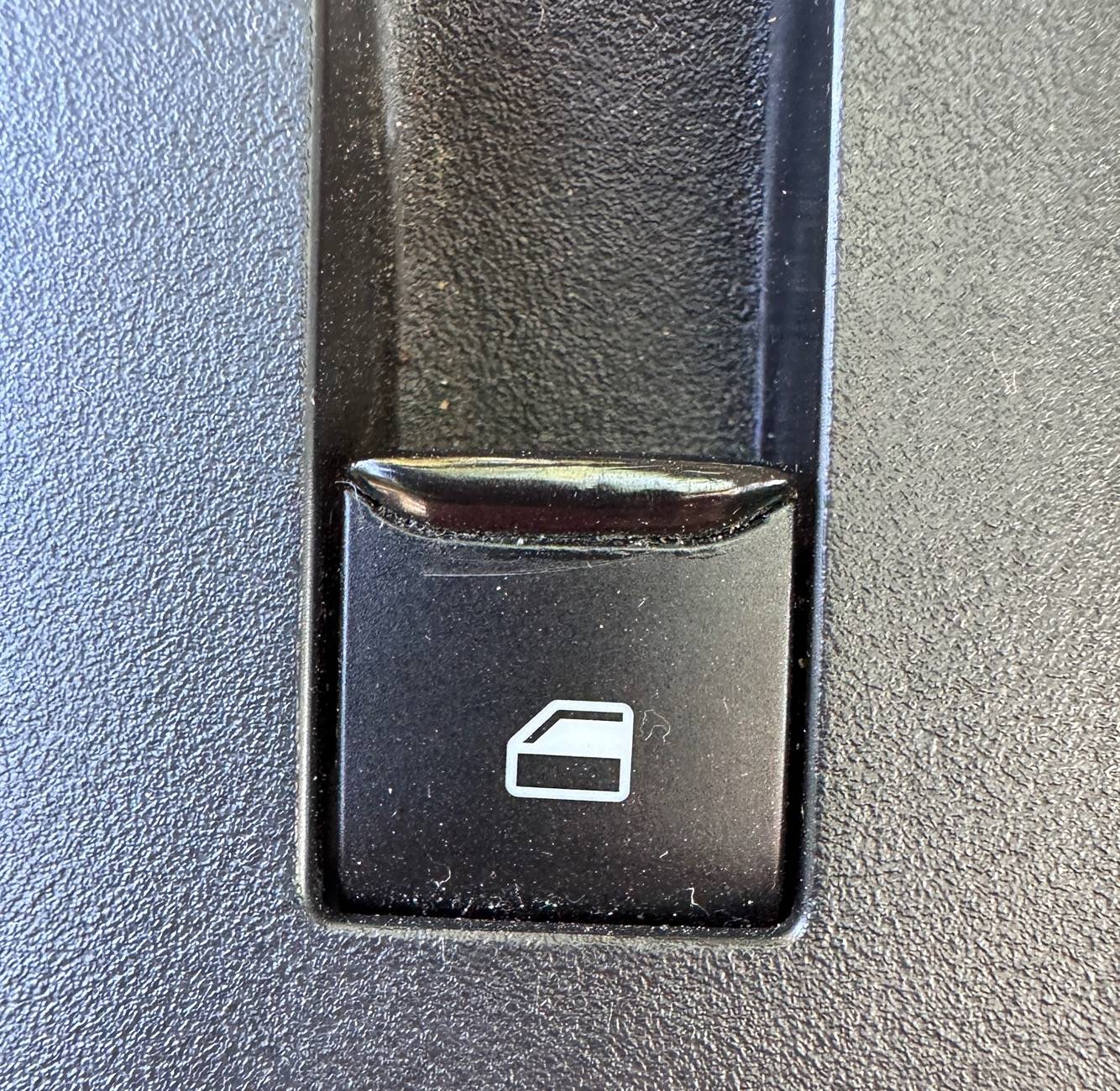

It happened to me as well. I fixed it with my girlfriend's black nail polish. It's been like that for a year, I can't even notice it. Of course, the silver is gone and it is a black with now. No biggie for me.

With this program Ford was only replacing the silver cap. The part from the Customer Satisfaction Program listed is the cap. The part number for the tip is listed as well as an illustration of the service repair procedure in the link which is for the original program 22N17 on the NHTSA website.
MC-10237448-0001.pdf
Ford Escape part number. Maybe the same on the Bronco Sport or parts department should be able to give you the correct number for the BS.
  • Manufacturer:Ford
  • Part Number:LB5Z-14A268-AB
  • Replaces:LB5Z-14A268-AA
This is how it looks if you just paint it with nail polish.
