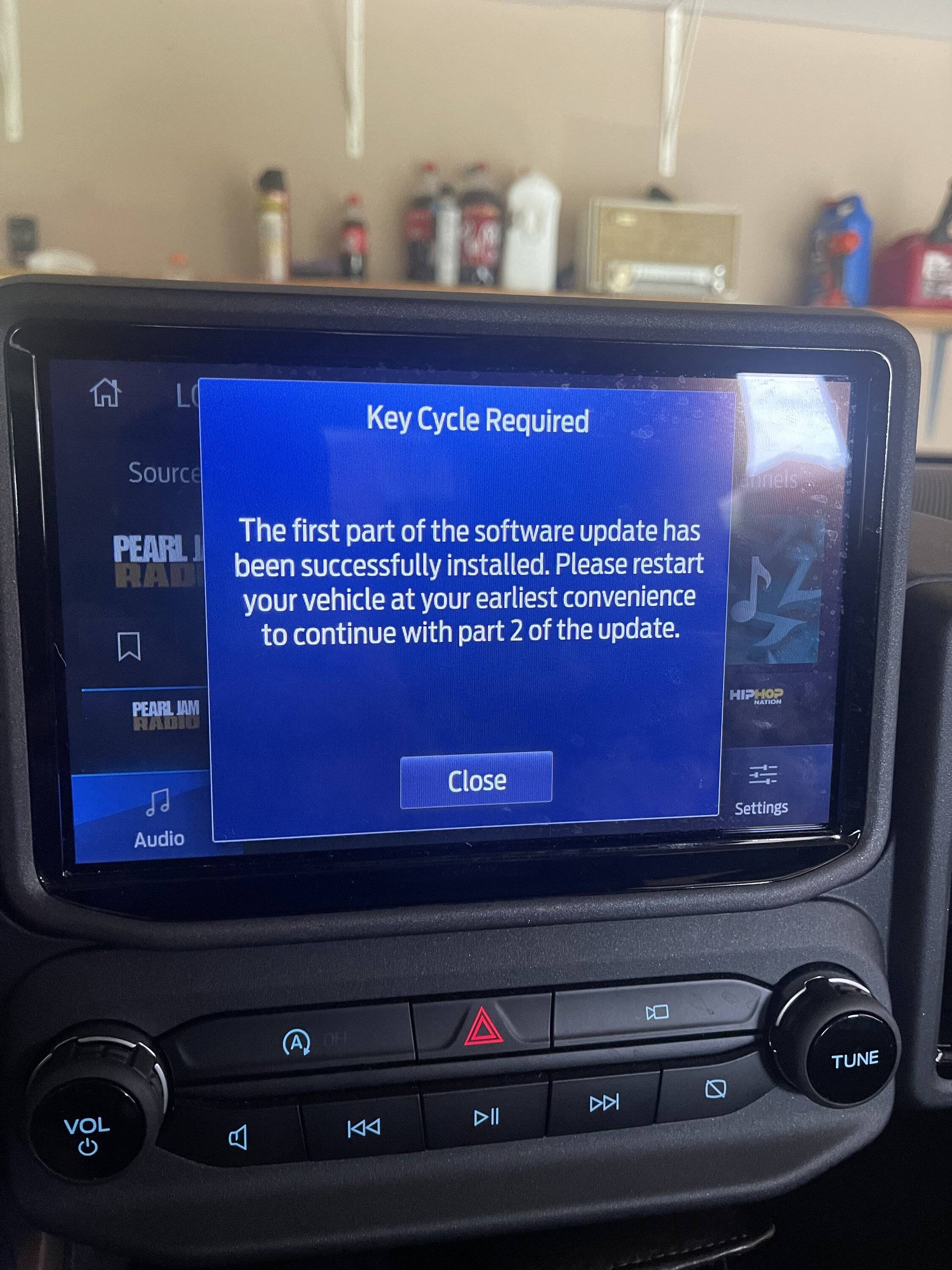

So I have had major issues w the 22251 version. Can’t perform a master reset the screen freezes. Have done more of the 2 minute hold the buttons resets than I can count. Loaded the update on my USB. Update starts then I get this screen. After a few seconds the system restarts and no update. If I leave the USB in the whole process starts again. Any advice is appreciated!

Alright, it doesn't let me copy and paste... not sure why.
But after the installation is complete, the instructions say to remove the USB drive then turn off your vehicle, open and close the door, then restart the vehicle.
Ford Bronco Sport SYNC update help! IMG_3503
The engine in the vehicle should be running during the entire update process. The message is telling you to stop the engine, open the drivers door, close the drivers door, lock the door, wait 2 minutes and restart the engine.
Keep the USB flash drive in the port. Follow instructions.

I’ve done everything you guys are saying. I’ve done this before, and understand the process.
It’s not working.
It’s not working.
I would recommend calling the Ford
Connected Services Team
+1 (833) 389-0848
They are not working today. Call tomorrow.
