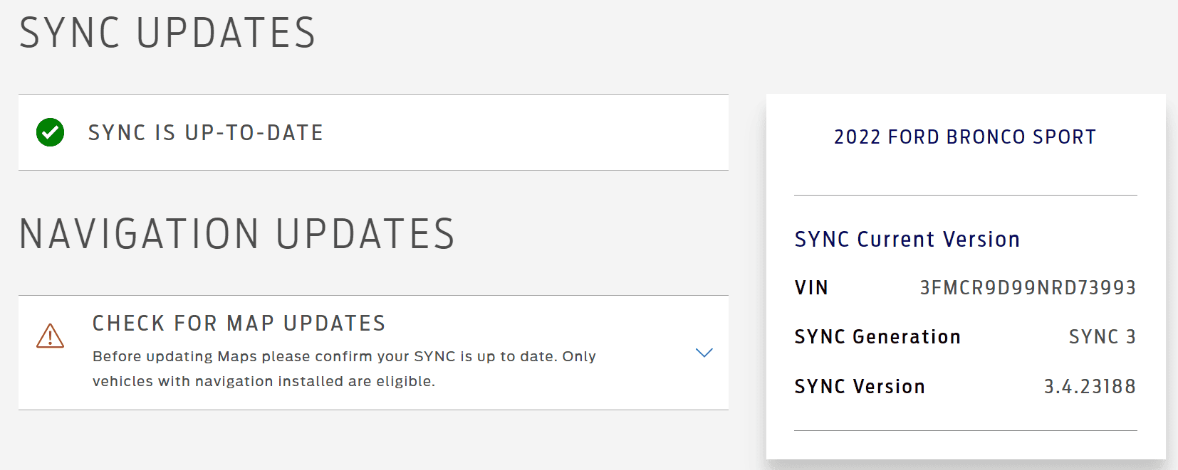

I should buy a [expletive] lottery ticket. It actually created the log file and I was able to upload it on the website. The maps can wait until tomorrow.
Ford Bronco Sport Sync 3.4 Build 23188 Now Available 9/2/23 Screenshot (126)
112
4,482
5,307
Yep for me too. But i hedged my bets and after installing 23188, I did the check for latest Sync update while in my bronco sport (said it was up-to-date) then I uploaded the log file to the Ford website.
First time since Oct 2022 the Ford website shows Sync is up-to-date in my ‘22 Badlands.

Same with me. I installed 23188 in my '23 OBX last week. The My Ford site finally showed it as updated. For a long time, it said both my cars needed updates, but when you checked the vehicles, they said they were up to date. Now if could just get the update installed in my wife's Ecosport.

Like others, after uploading the xml file I received a message stating something about it being corrupt and it will be checked by someone and my update status will be set to updated.
I did check through Wi-Fi after that, and received a message in the vehicle screen that my vehicle was up to date. That didn't change my online status at Ford.com.
A week passed and my update status had not changed (profile at Ford.com), so I tried checking through Wi-Fi in the vehicle again, received a message again that vehicle was up to date (as expected).
This time at Ford.com my vehicle now shows as current. The second time checking through Wi-fi seems to have done it. No idea if it's because I tried again after a few days, or simply the second time made a difference.
Best of luck to all of you. I think next time (as others mentioned) I'll skip trying to upload the confirmation file to Ford.com and just go check for updates on Wi-fi instead to get the confirmation for Ford.
