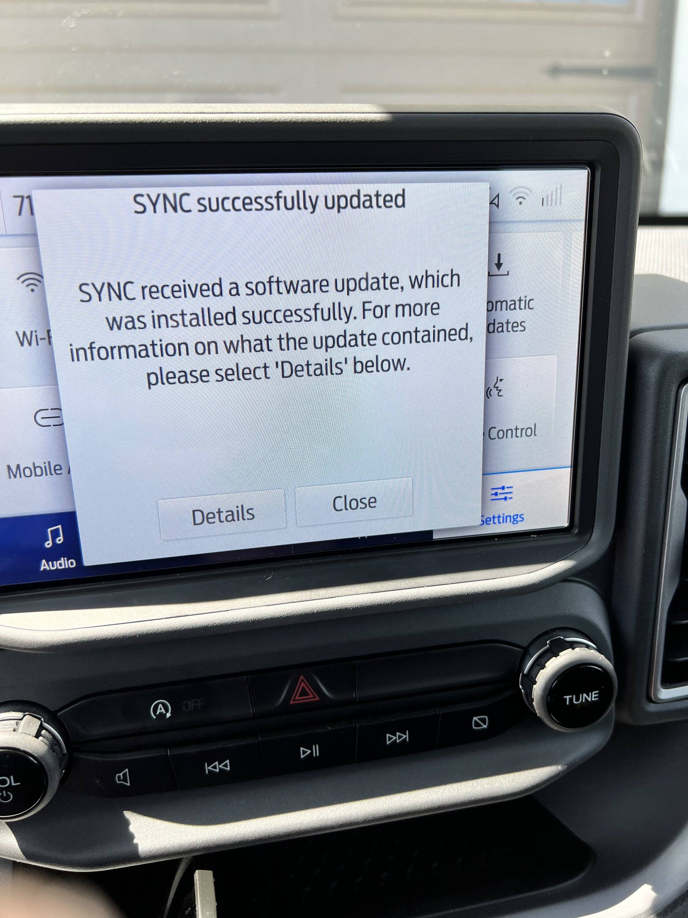

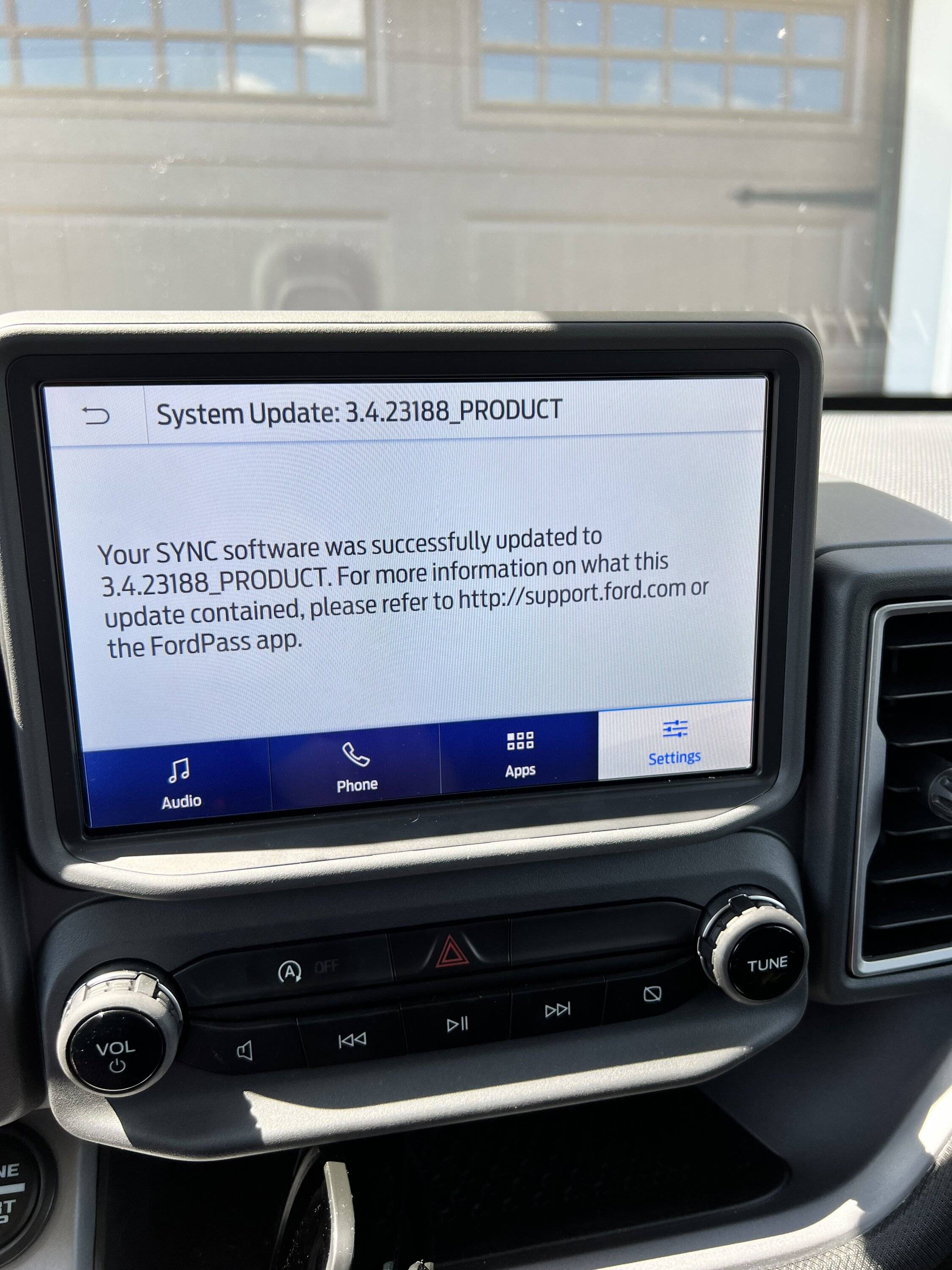

So I followed the directions and everything shows to have updated just fine, but I cannot find the xml file to upload to ford. It’s no where in the SyncMyRide folder…
should I worry or do this all over again?

Thank you everyone for your help and input. My computer skills are clearly lacking (I'm 79). I finally figured out you have to extract files to de-compress them. Once I did this the new sync downloaded in ten minutes. Thanks again for all the help!

Thanks! I was able to update it, too. My laptop now shows 23188 is current SYNC.
