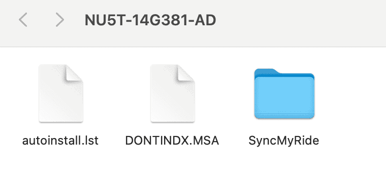

OK Here's what I did last night. I downloaded NUST-14G381-AD from the computer. I got 2 different brands of USB. They were both 32gb and formatted exFAT. I downloaded the file on both the USBs. When I tried to download into my vehicle they both reacted the same. The vehicle first "detected" the USB. Then it "indexed" the USB. Then it "completed indexing" the USB. I pulled the USB out at this point to get any feedback from forum members.
Jmuns
Justin
Feb 22, 2022
1,013
1,922
FL
2022 Bronco Sport BL
Did you unzip the file and place the three folders on the drive? Your drive should have these three folders on it. Not the zipped folder NUST-14G381-AD.
I'm thinking you didn't unzip it or didn't place the autoinstall.lst on the drive. The drive shouldn't index, the autoinstall program should start the installation immediately.
When I put the USB on my computer, it tells me it has file NUST-14G381-AD. It says it is compressed (zipped). When I open this file I have 3 parts to it. SyncMyRide, autoinstall.lst, and DONTINDX.MSA. Does this me they are not unzipped? If so , how do I unzip them?
Jmuns
Justin
Feb 22, 2022
1,013
1,922
FL
Open the file on your desktop, then drag ONLY THE THREE SyncMyRide, autoinstall.lst, and DONTINDX.MSA files onto the drive. Those should be the only three files, and they SHOULD NOT be in another folder.
