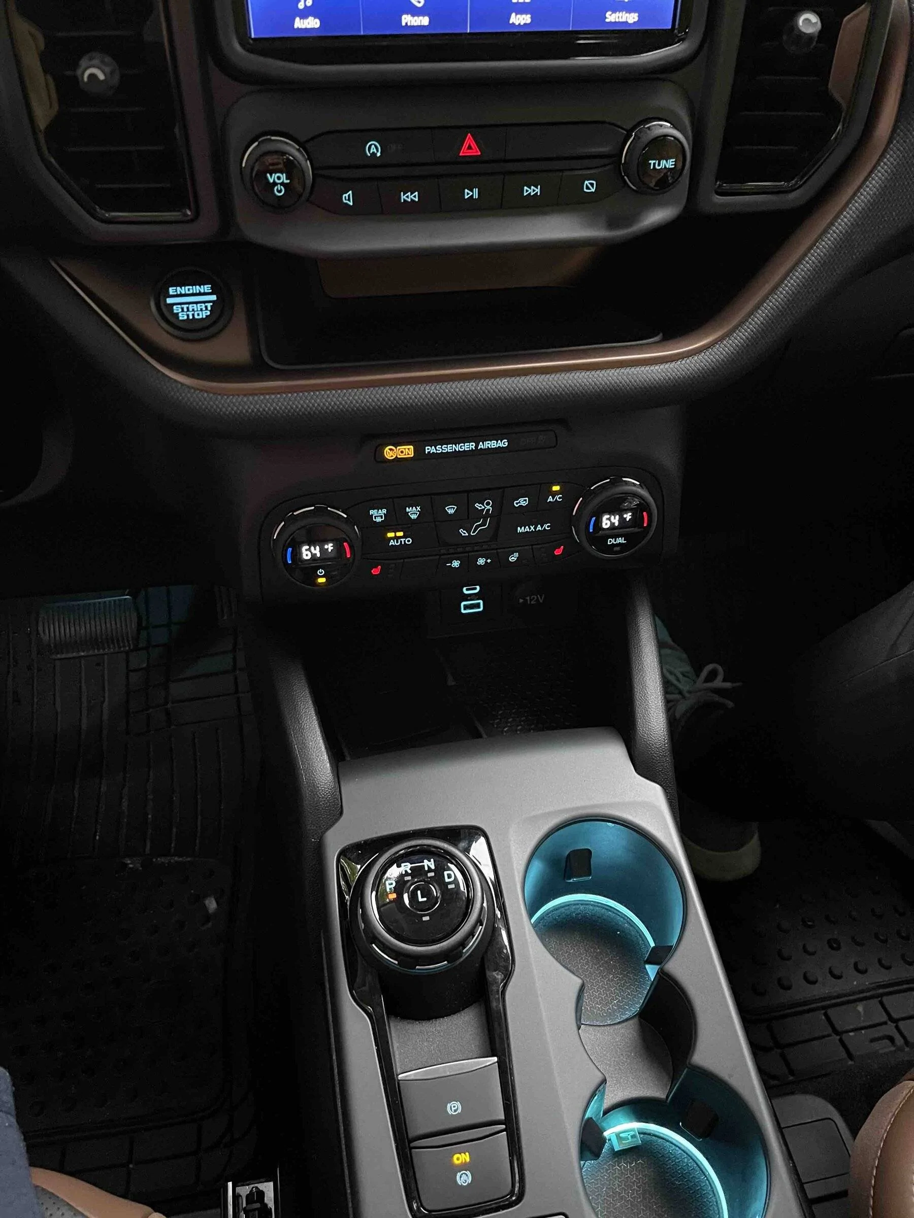

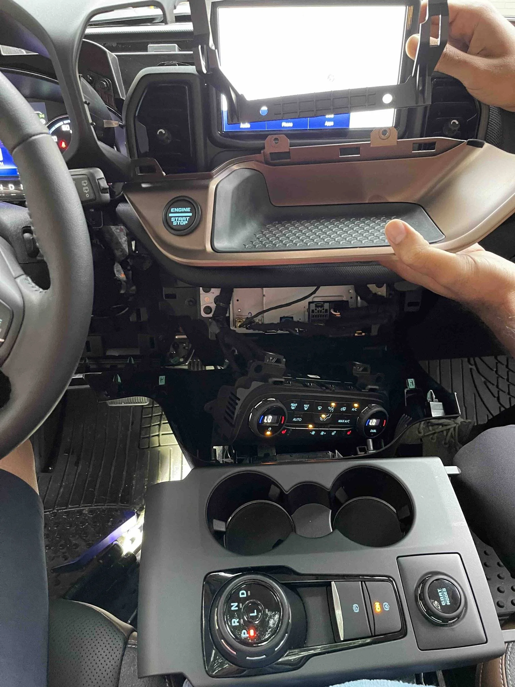

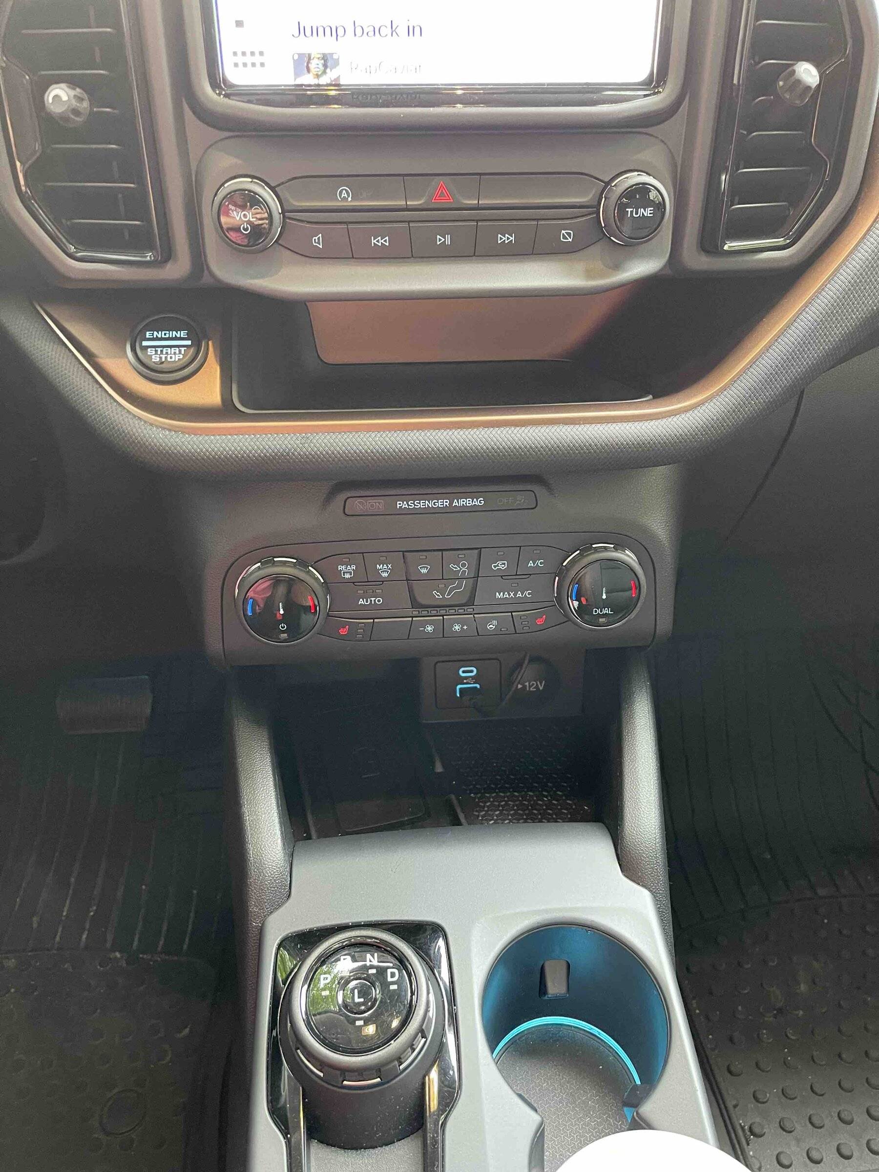

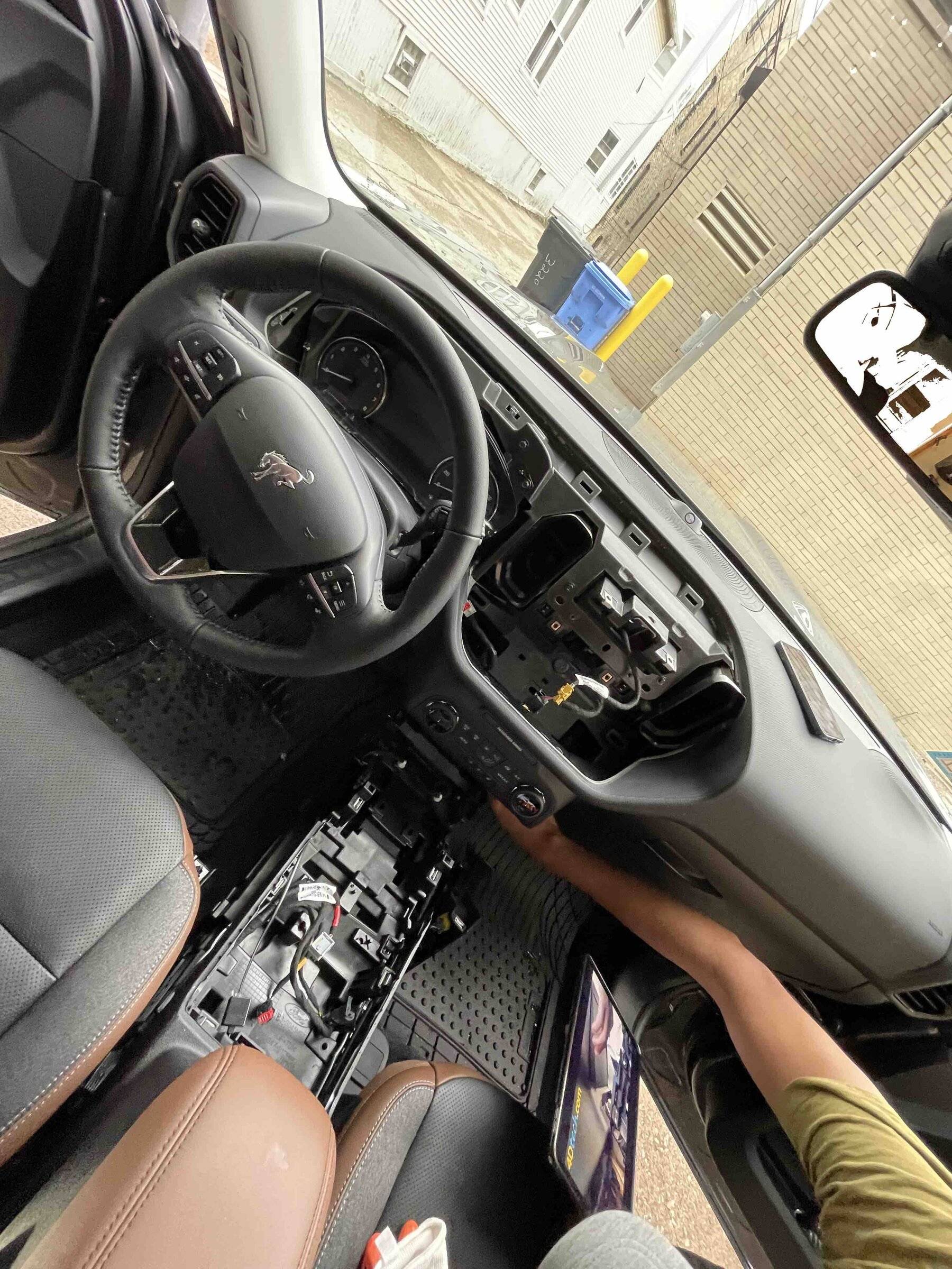

Weekend success!
Pictures of: before, during, testing, after.
Ford Bronco Sport Switching Temperature Control Knobs in MY22 to MY21 IMG_2990
Ford Bronco Sport Switching Temperature Control Knobs in MY22 to MY21 IMG_2993
Ford Bronco Sport Switching Temperature Control Knobs in MY22 to MY21 IMG_2996
Ford Bronco Sport Switching Temperature Control Knobs in MY22 to MY21 IMG_2999
Tested all of the functions and they all work. For me personally, so much better, I've always had a temperature display in my previous cars. Took 1.5 hours total.
