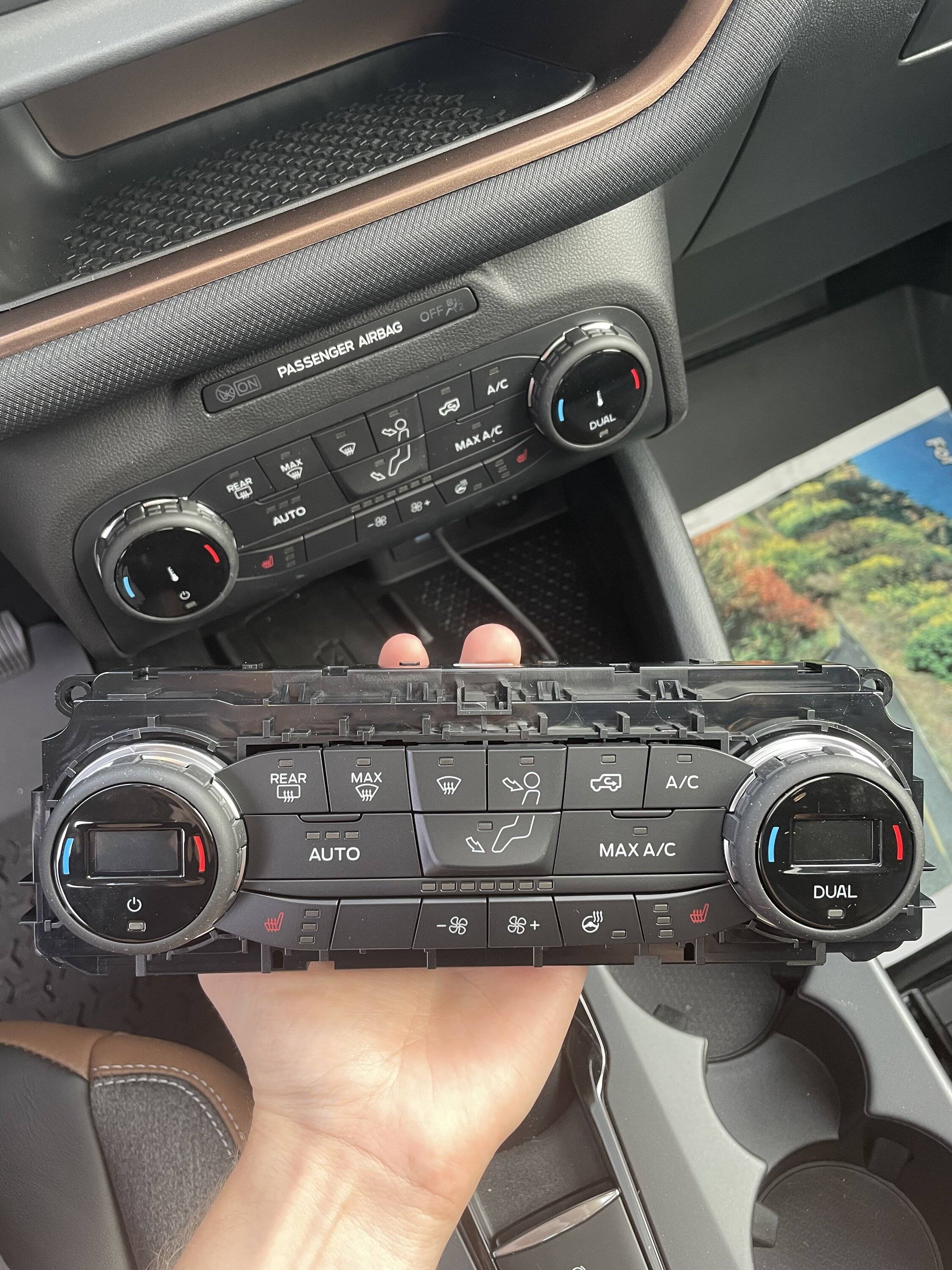

Got a very exciting package today, will follow up with pics from the install process!
Ford Bronco Sport Switching Temperature Control Knobs in MY22 to MY21 45B04520-1D7E-4774-B359-5B732911E814
If you’re trying to do the same thing I am, make sure your part number ends in A through D, not E through H. From what I can tell, they’re the same part, just the earlier letters have the screens, the later letters don’t. A corresponds to E, B corresponds to F, et cetera.
The outer banks trim level and tech package, which is what I have, comes with model b. Here’s all the different models, thanks to @bjbena:
M1PZ-19980-A w/Dual Zone Temp Ctrl.; w/o Heated Steering Wheel. Dual zone AC, w/o heated steering
M1PZ-19980-B w/Dual Zone Temp Ctrl.; w/Heated Steering Wheel. Dual zone AC, w/heated steering
M1PZ-19980-C w/o heated seat. Bronco Sport; w/o Dual Zone Temp Ctrl.; w/o Heated Drivers Seat
M1PZ-19980-D w/heated seats. Bronco Sport; w/o Dual Zone Temp Ctrl.; w/Heated Drivers Seat
Again the new ones without the screens are E, F, G, H. So my part number ended up being M1PZ-19980-B. The dealerships cannot order the ones ending in B any more, my dealership tried to sell me the one ending in F since it has been officially replaced in their system (same config, just no screens). I was lucky to find one still physically at a dealership and have it shipped to me.
Now wish me luck actually getting this thing in my bronco, lol!

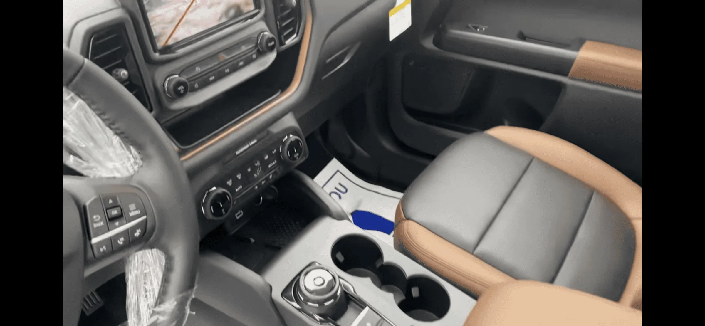

For those asking, here is what the MY 22 looks like.
For me it is more about what temp it is set to when I get in to see if I need to adjust. SoCal winters have wild temp fluxes so you could need it set to different temps depending on the time of day you enter the car. Being able to see it displayed in the knob will let me know if it is set to a good temp or if I need to go up or down.
Obviously this is all about personal preference and everyone has their own view but for me, I think it would be useful. I came from a 2010 Mazda 3 that didn’t have climate control at all, just a dial that you always had to play with because it wasn’t consistent. So being able to set a temp at all is a new luxury for me.

Did the swap last night. The good news is I got everything together in one piece, and the temperature knobs work! The bad news is, something somewhere got screwed up. My heated seats & steering wheel buttons don't work anymore, and I can't choose those options in the remote start menu (they're greyed out), suggesting that the computer isn't recognizing those modules.
On the bright side...somehow my auto engine idle off function got screwed up too! It's defaulted to always off...and I can't to turn that dumb feature on even if I wanted to, the button does nothing. Not sure how that happened but I'm not complaining. Trying a sync update to fix the other issues, would be really nice if that magically stayed broken :)

You have malfunctions with unrelated systems, with the only common denominator the replaced part. This suggests a wiring issue rather than a programming one.
Yeah, you’re probably right. I didn’t realize it before, but my parking brake and auto-hold functions don’t work either. And I did do the software update, it didn’t change anything.
Weird that @jayzala ā€˜s conversion worked, since we have the same car (ā€˜22 Outer Banks). Wonder what the issue is. Guess I’ll have no choice but to go back to the old controls ?

Connectors can sometimes be finicky. When you pull them apart make sure you didn't bend any pins. I would carefully compare the connector coming from the car and the one going to the new panel. For every wire on the car-side connector you should see a corresponding wire on the control panel. If you don't, it's possible you may have somehow gotten an incompatible control panel.
