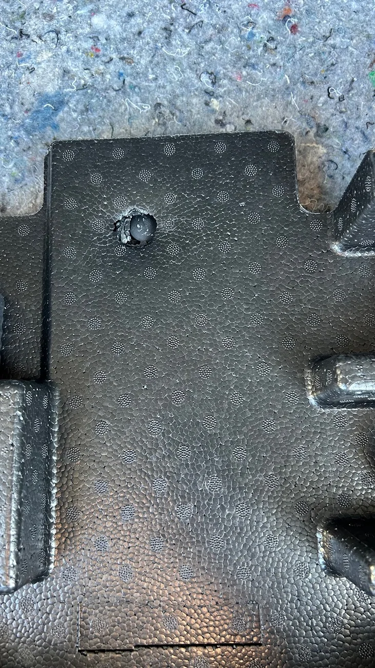

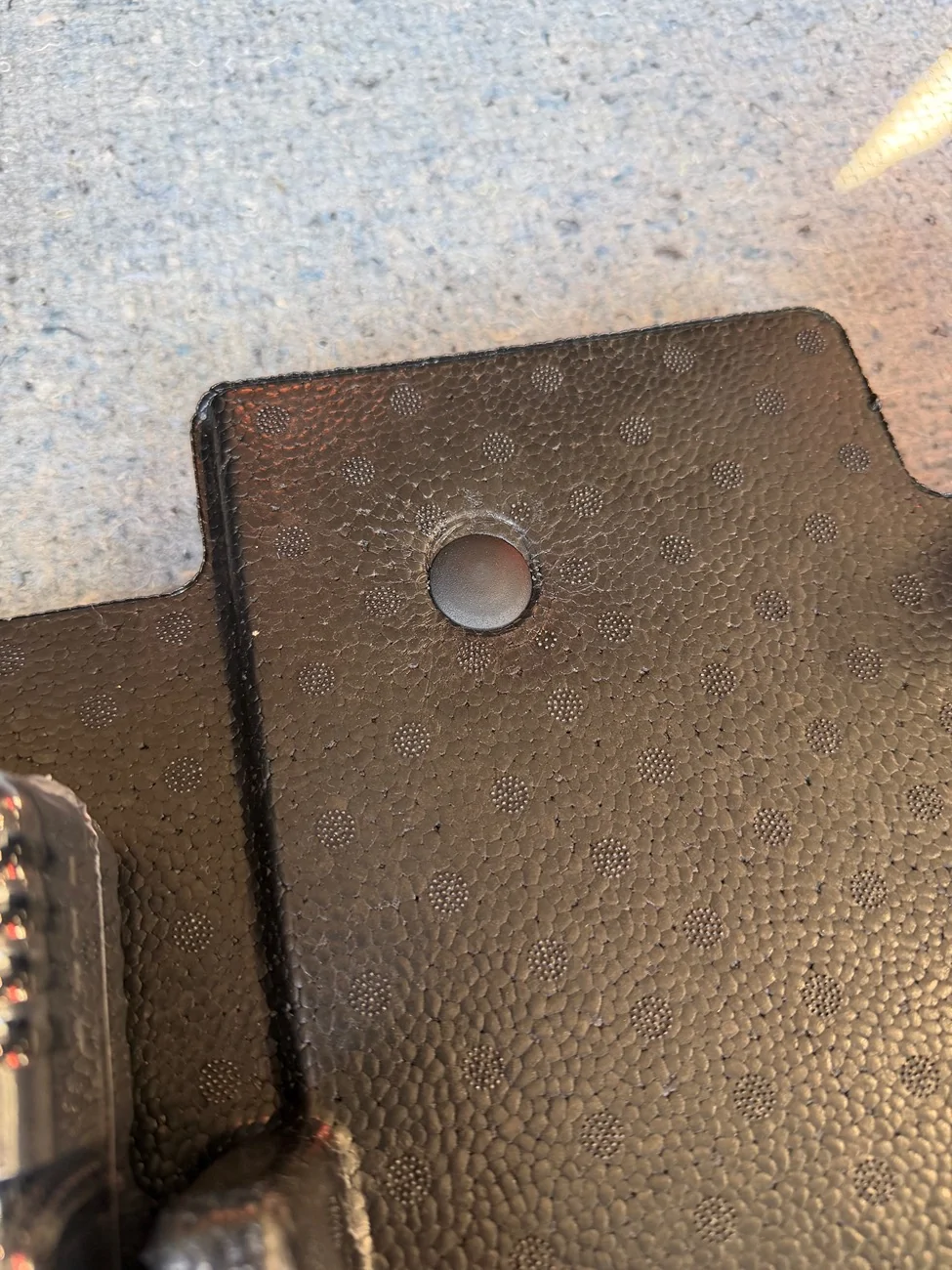

3. In the posted pictures, the foam under the cargo mats is held in by a plastic piece in the center. It does not appear to unscrew. Do I just yank it straight out?
4. Do they sell a replacement foam that fits along with the tire? (For a scissor jack and spade) No tire will fit with what I have under there currently.

I have to decided to go with the 225 65r 17 for the spare. One question that still hasn’t been answered yet is how do I get the foam mold out. The peg holding it just spins. (repeat pic for reference)Do I just rip it out?

Yes just pull the foam out, you're not going to be using it.

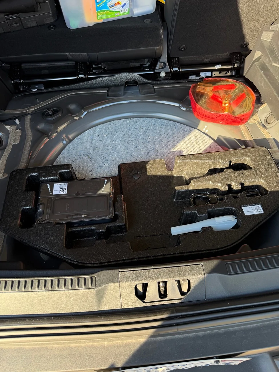

I just yanked on mine. The peg stayed in place and the foam pulled over the head of it. That might have enlarged or ripped the hole in the foam a bit but I didn’t worry about that. I was just test fitting my neighbour’s doughnut (donut?) so I had to put the foam back. It didn’t easily go back over the peg head and I was in a rush so it’s just kind of sitting there on top of it for now. I’ll play with it when I have some time. Like was already mentioned, if I end up putting a spare in there I won’t be using that foam anyway.

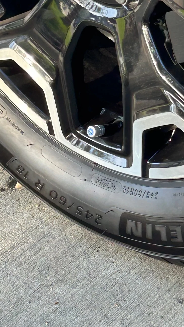

I think your comment was probably for the original poster, but yes I did mention in this thread that I’m looking to do the same thing as him and will probably need to find as big of a donut as the space will permit because my tires are a bit oversized in diameter over the OEM tires on my OBX (245 60 series as opposed to 225 60 series) which makes them a bit taller not just wider.
