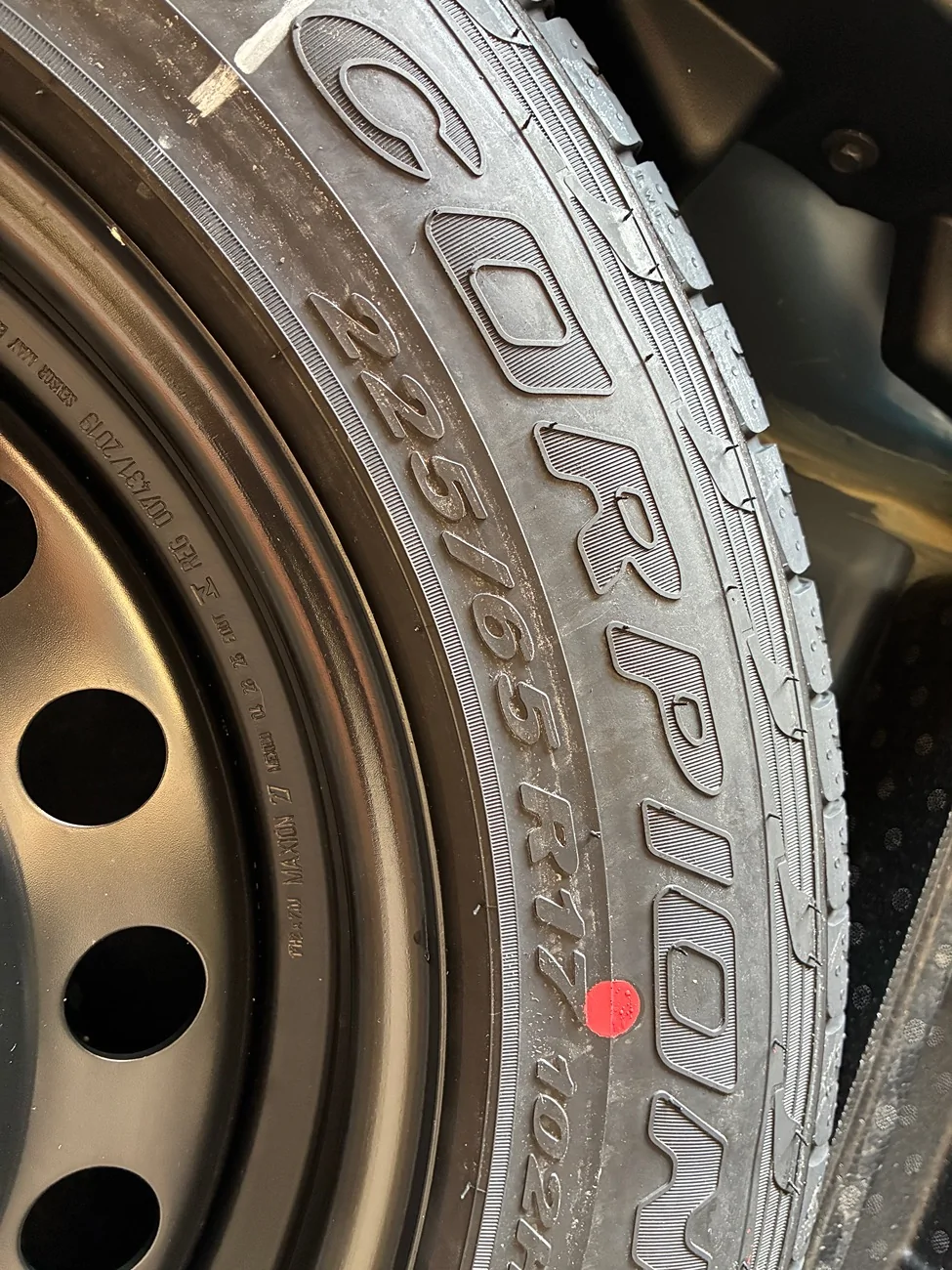

Wha trim do you have? I just bought a Badlands and it’s got the same size spare, 225/65 R17, as the other 4, but it’s a Pirelli Scorpion.
The Badlands Sasquatch has Goodyear Territory A/T 235/65 R17's. My spare, however, is the 225 Pirelli like yours.
My 2022 Badlands came like some ‘25s - 4 Pirelli Scorpions and same size spare 225/65 R17 but not to worry most owners get around 25k miles with those
