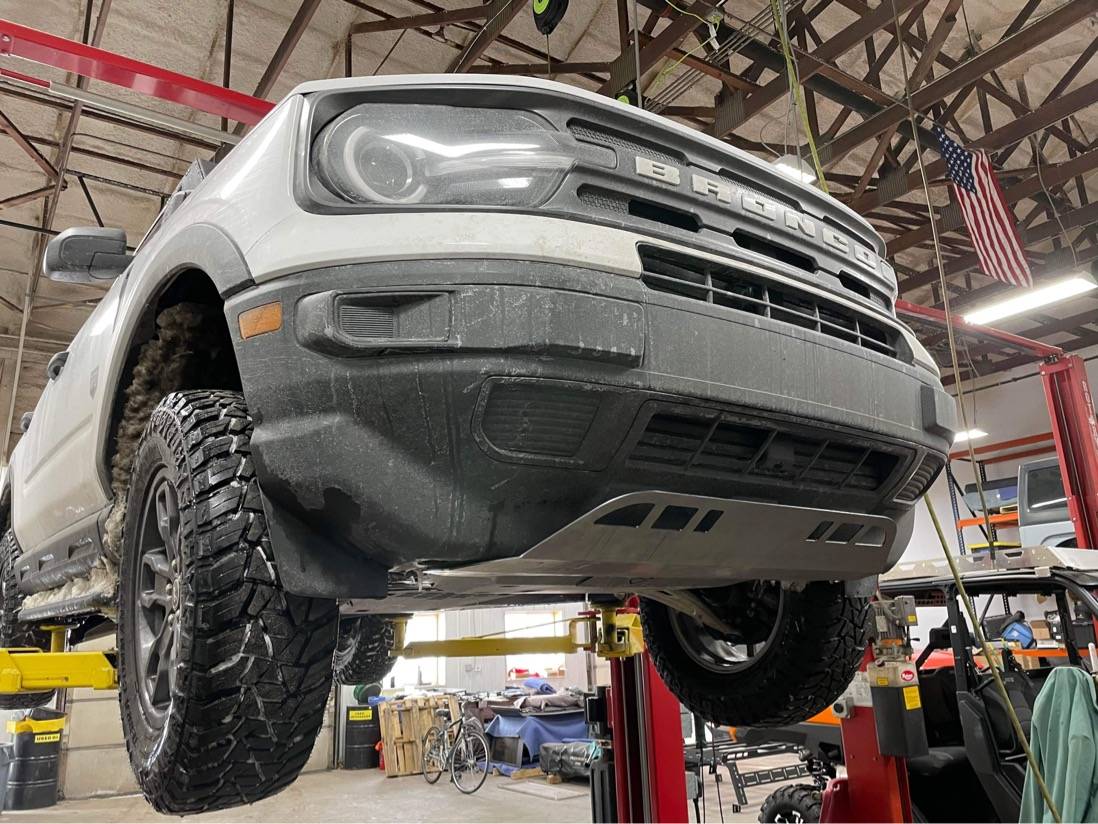

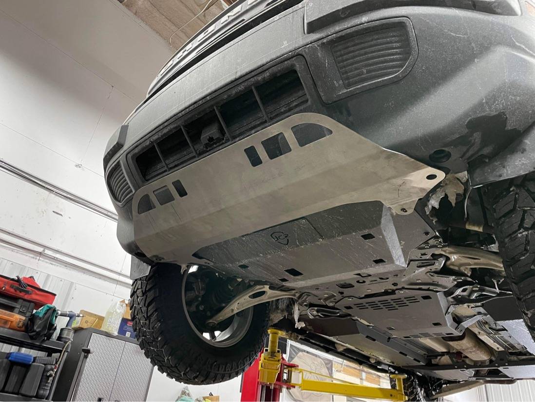

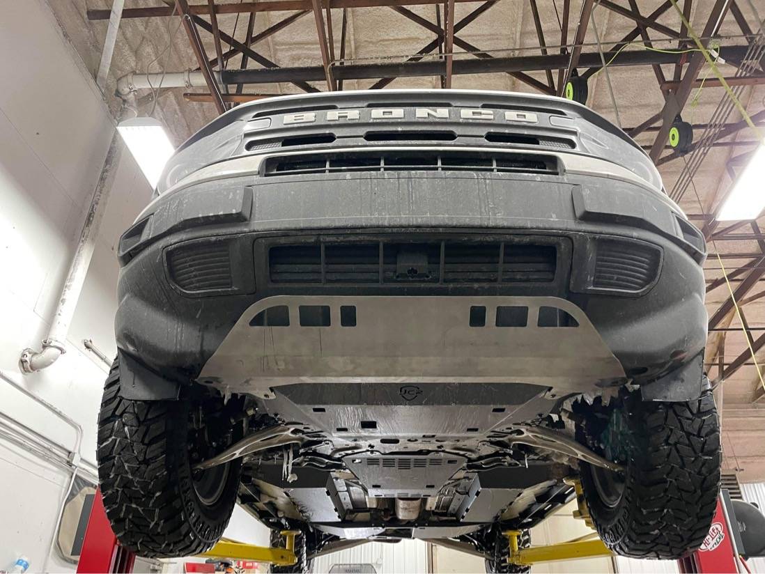

Wrapping up the front lower bumper protection plate:
Ford Bronco Sport Skid plate and slider prototyping - JcrOffroad 1CEE191D-37C0-454F-BAFD-8AAF092EBBB9
Ford Bronco Sport Skid plate and slider prototyping - JcrOffroad 74AA49D1-54DC-4A5F-AE8D-C048BFC8BA72
Ford Bronco Sport Skid plate and slider prototyping - JcrOffroad 62FC512F-6CAE-478D-8F5E-6FC7593A9271
This looks like it might extend upward a little more than the other ones on the market? Also, it looks to be in 3 planes, which I think would be better, whereas the one I have now is in two planes.
Do the front two plates fit the Badlands? I know that other companies have different plates for the other trims vs the Badlands.
I think I remember that the final product will be dark coated (?) and I think that should be at least an option. Lastly, as several of us mentioned, in another of your threads, I think you still need to work on the design of the Holes. It still lacks something Cosmetically!!!

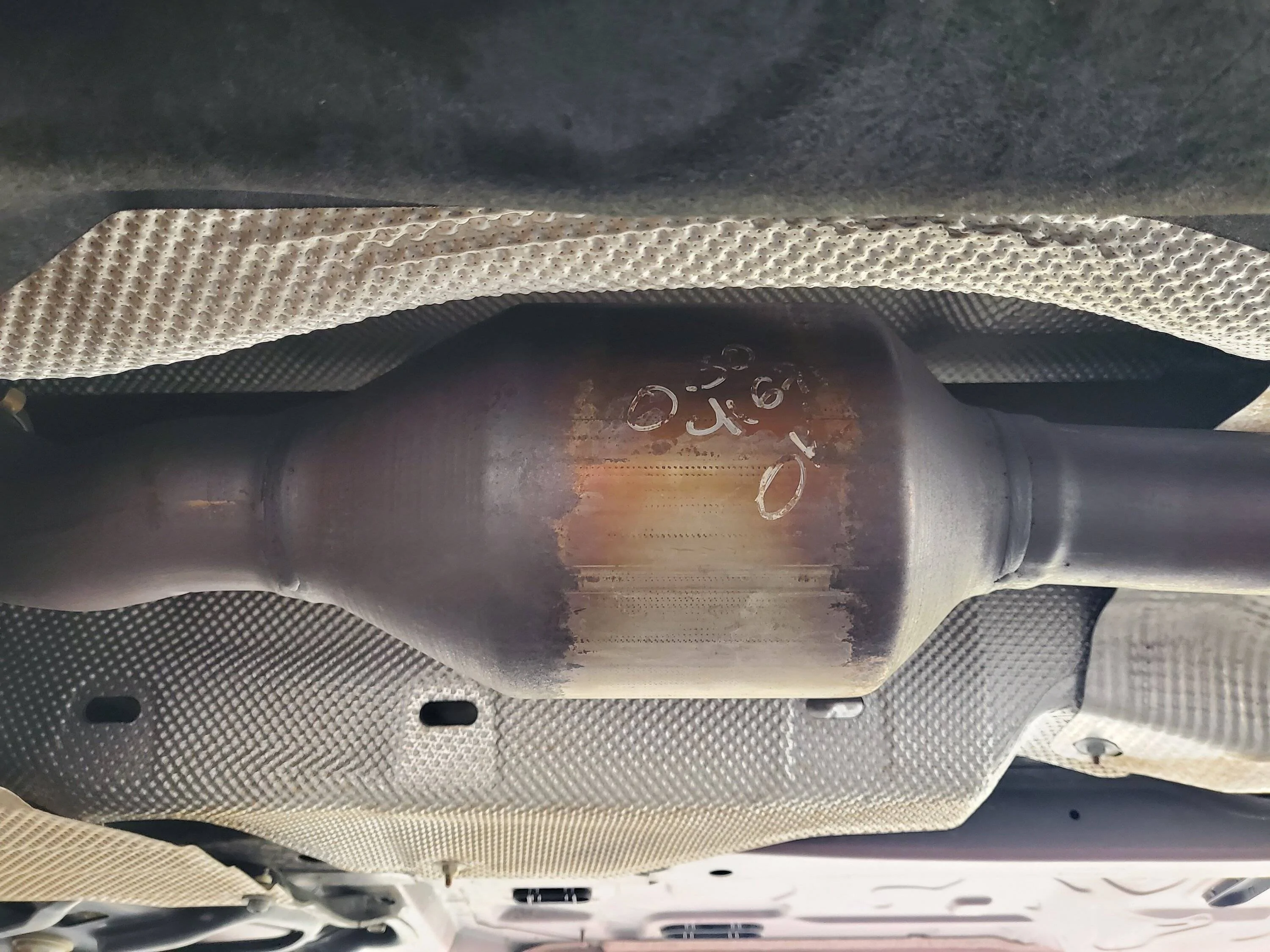

And... Installed...
Before:
Ford Bronco Sport Skid plate and slider prototyping - JcrOffroad 20230415_104337

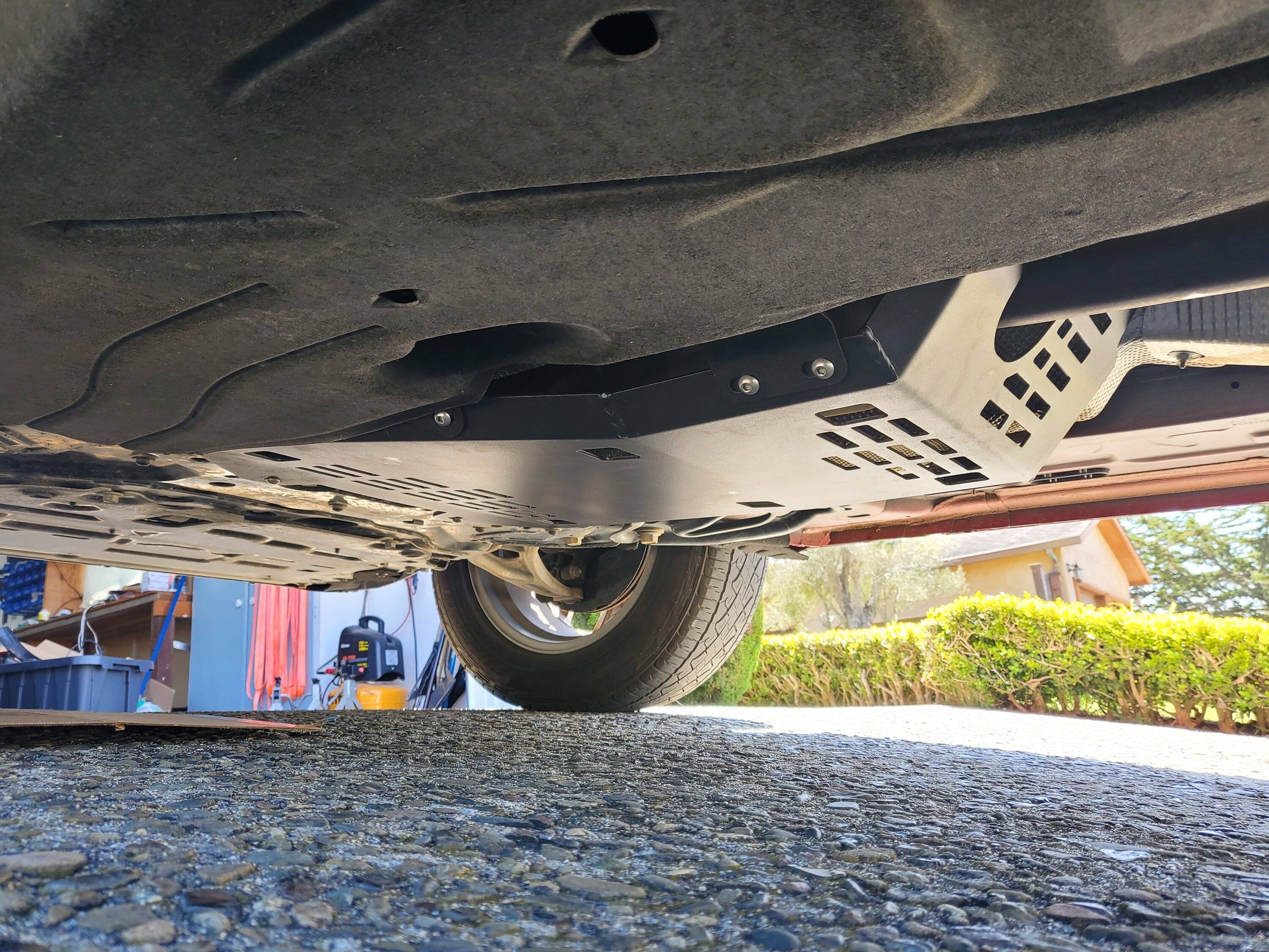

After:
Ford Bronco Sport Skid plate and slider prototyping - JcrOffroad 20230415_133329
Ford Bronco Sport Skid plate and slider prototyping - JcrOffroad 20230415_133310
Installation was (almost) a snap. The only issue I ran into was that the two bolt clips (in case JCW is reading, the ones labeled #2) were quite literally just a few millimeters too short on my early-build Badlands. This added maybe an hour to the install while I realized what was going on and then contemplated what to do about it (the solution being bending the tabs back to a roughly 60 degree angle instead of the 45 they came shipped as) I would also recommend a floor jack to elevate and hold the plate in place if you are going to do this as a garage or driveway install. Last, the video instructions on YouTube by JCW were perfect, no one should need anything else to understand how to do it.
If anyone else is considering the Cat skid plate, it has my complete enorsement.
